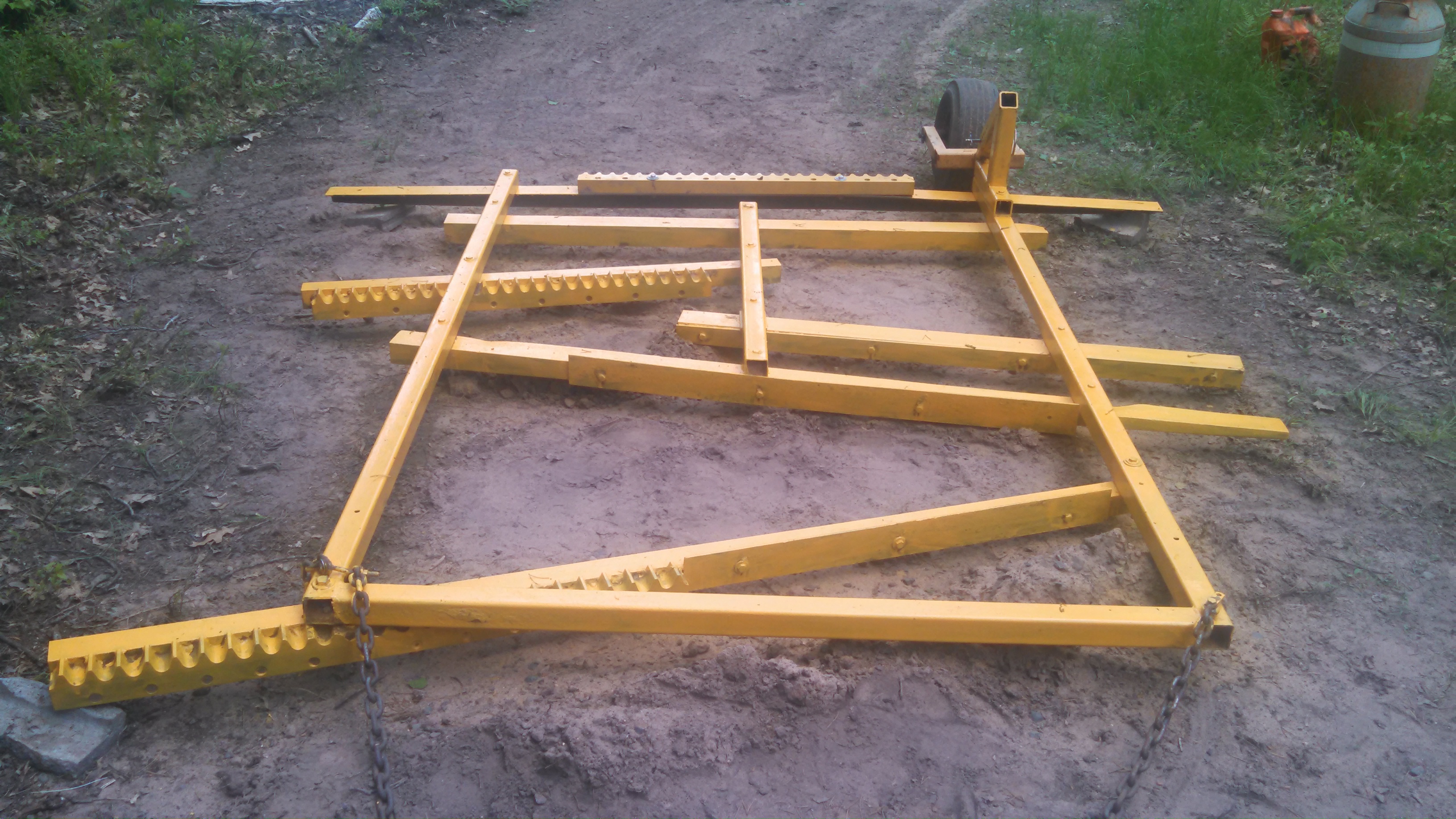

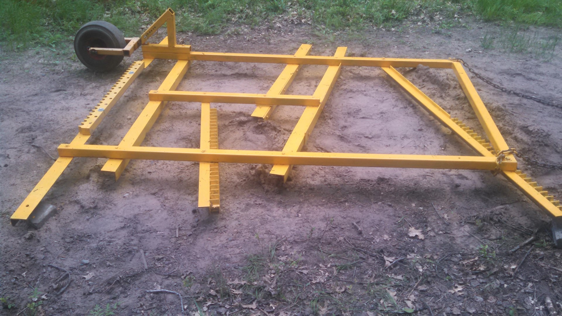

I am sure the drag works for you to fill in the potholes, but you always have a completely flat driveway surface.
With a flat surface, the water cannot run off, and more soggy/muddy/puddle areas form after each rain.
Putting some gravel on that driveway, and keeping it crowned with a blade, (to enhance drainage) would work a lot better for you.
I do realize that 1/2 mile of gravel would be expensive, but perhaps a few loads each year?
I have a 2200' driveway with a nice gravel surface ( a few loads each year, over 9 years). I never have mud, and I only need to grade it twice each year.
The drag actually maintains the crown pretty well. If you look at the pictures or video, you can see that there is a guide wheel that slightly elevates the left side of the drag, and that keeps a crown in the center of the road. It leaves a very smooth surface. That said, I have also attached a picture of my (old) secret weapon for establishing crowns and road contours. Those old pony graders are awesome!
I have been adding gravel to the road over the years, and that really helps. I have also been eliminating any place where water could pool (puddles), and making diversion ditches on hills to slow the velocity of water running along the side of the road during down pours. Good drainage makes for good roads. Easier to keep it up (the drag), than let things go and do bigger repairs. I hope that more fully explains.
Road draga (Large).jpg Road drag depth wheel (Large).jpgPony Grader (Large).jpg
https://www.youtube.com/watch?v=URHteVfiYDI
