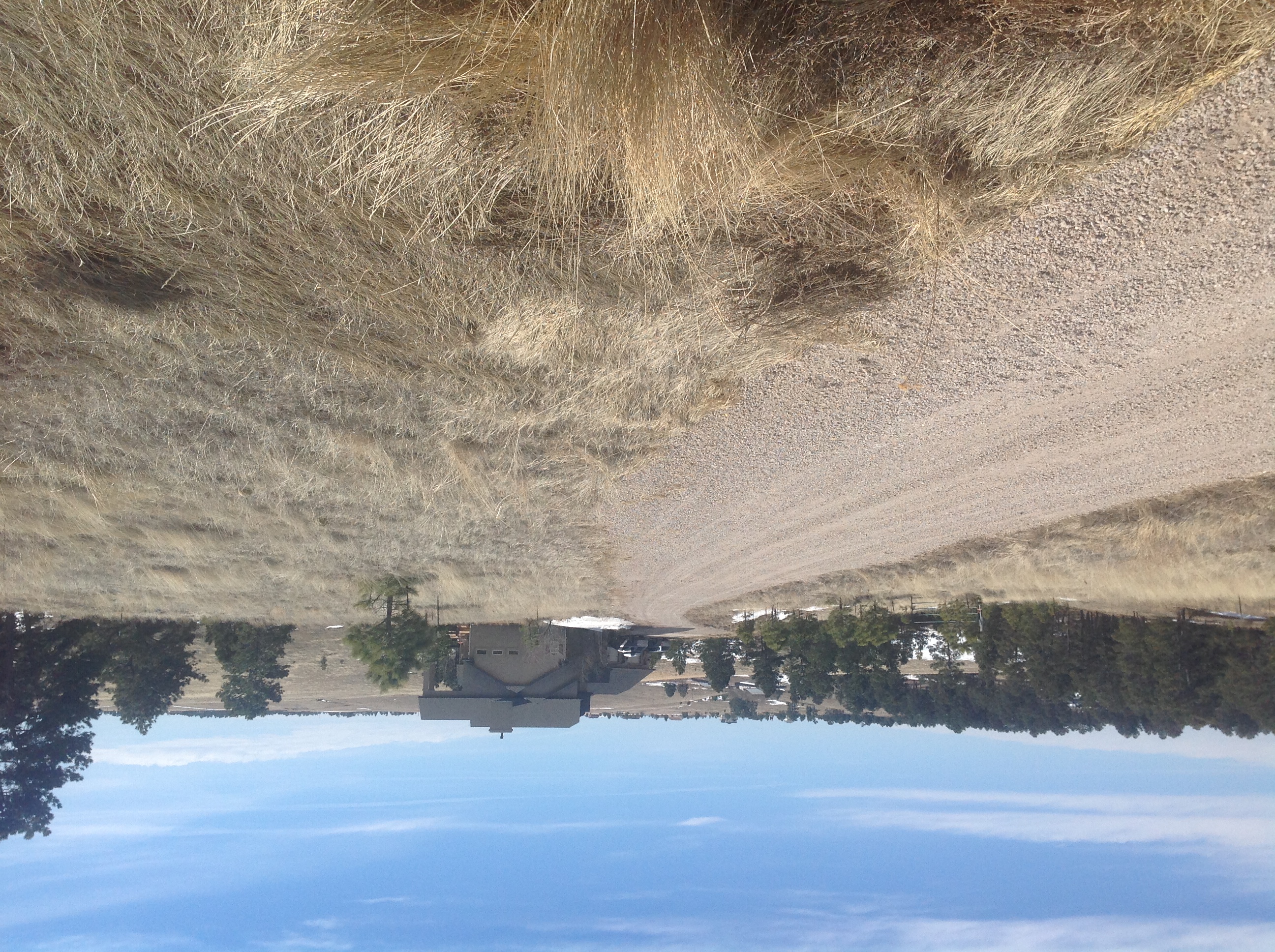

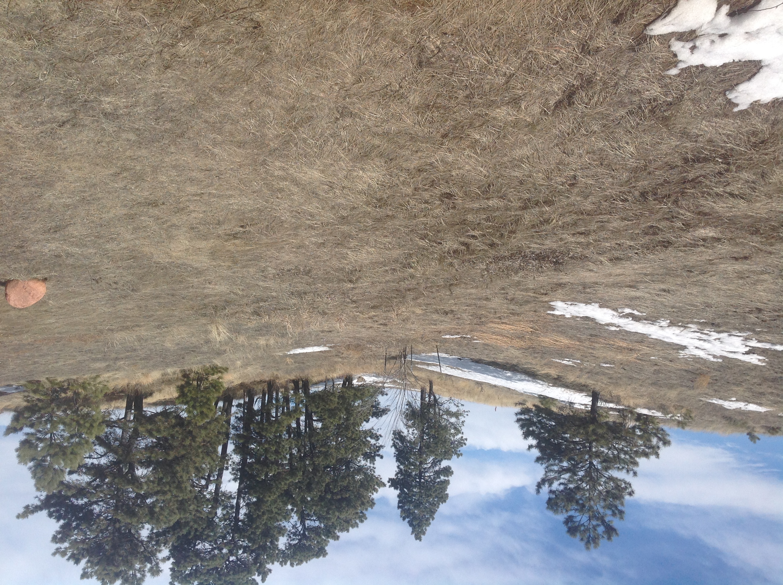

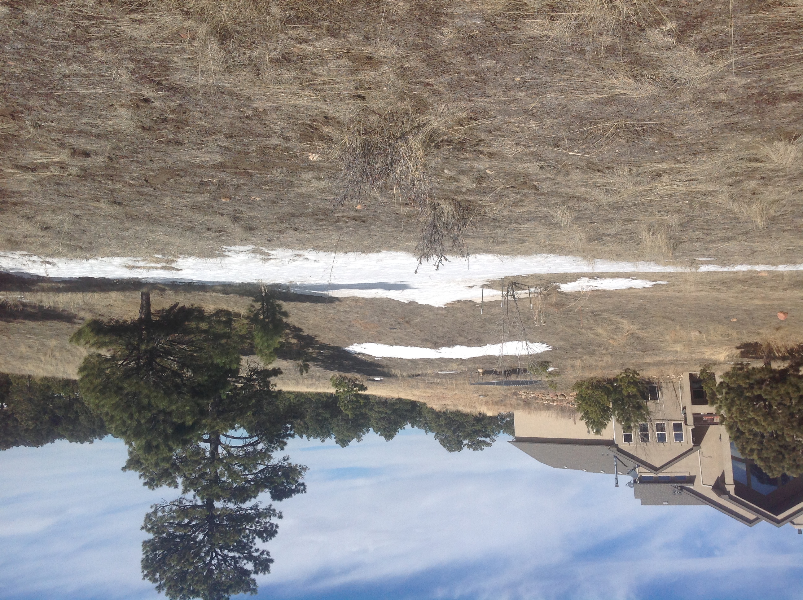

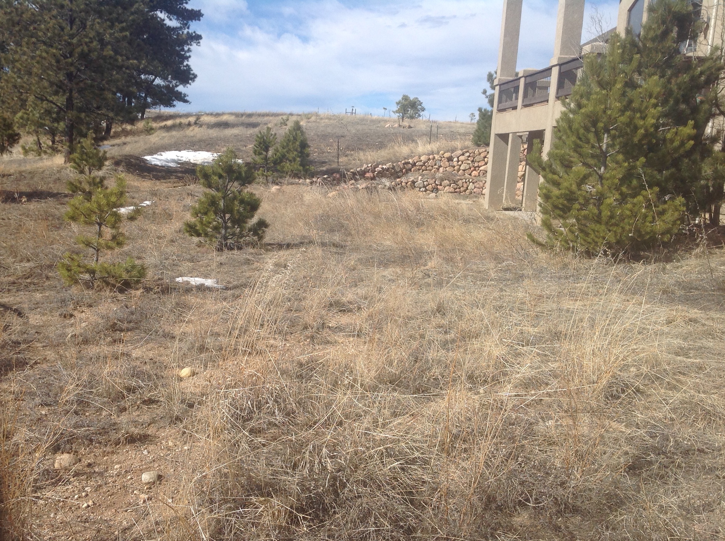

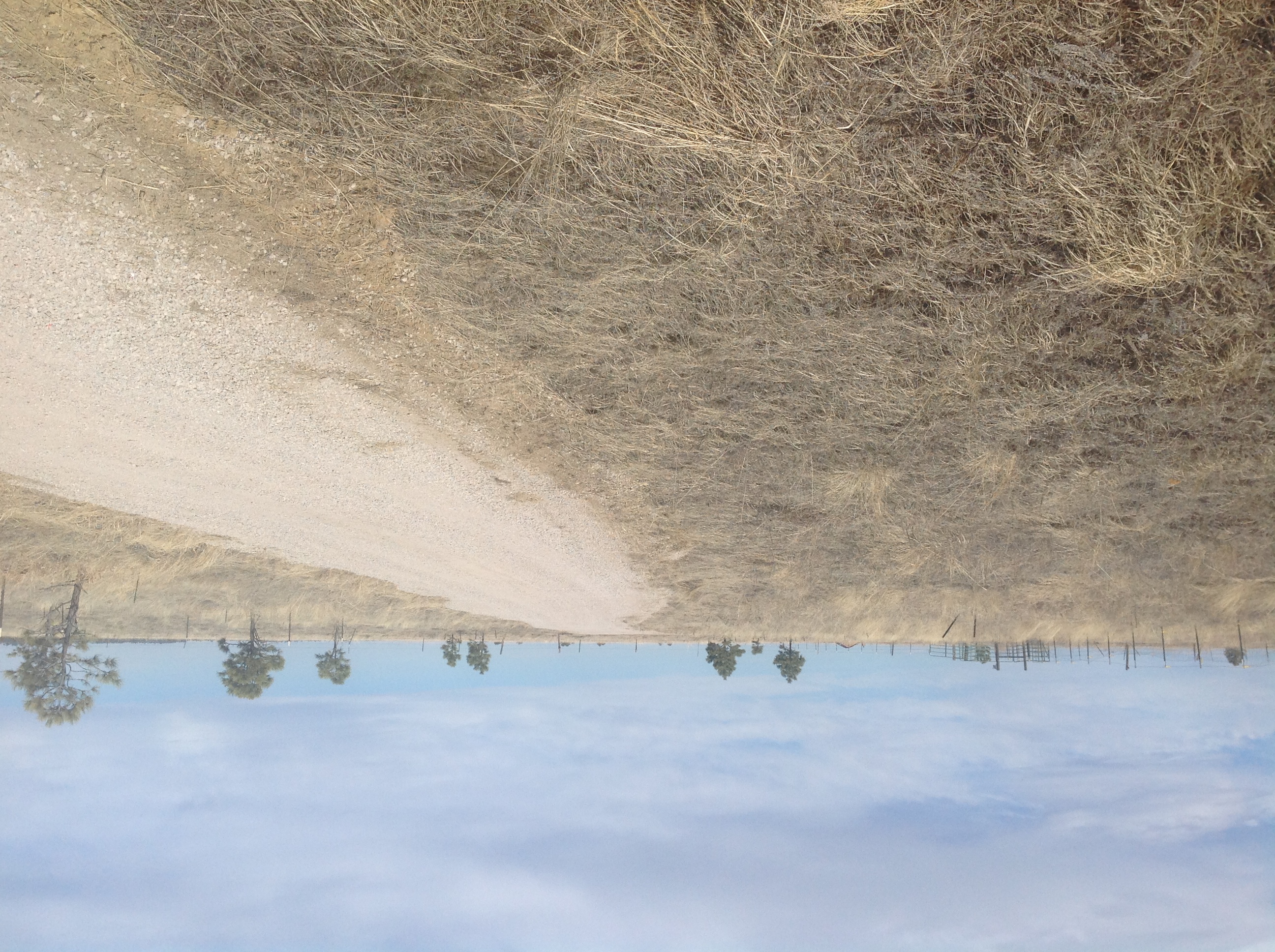

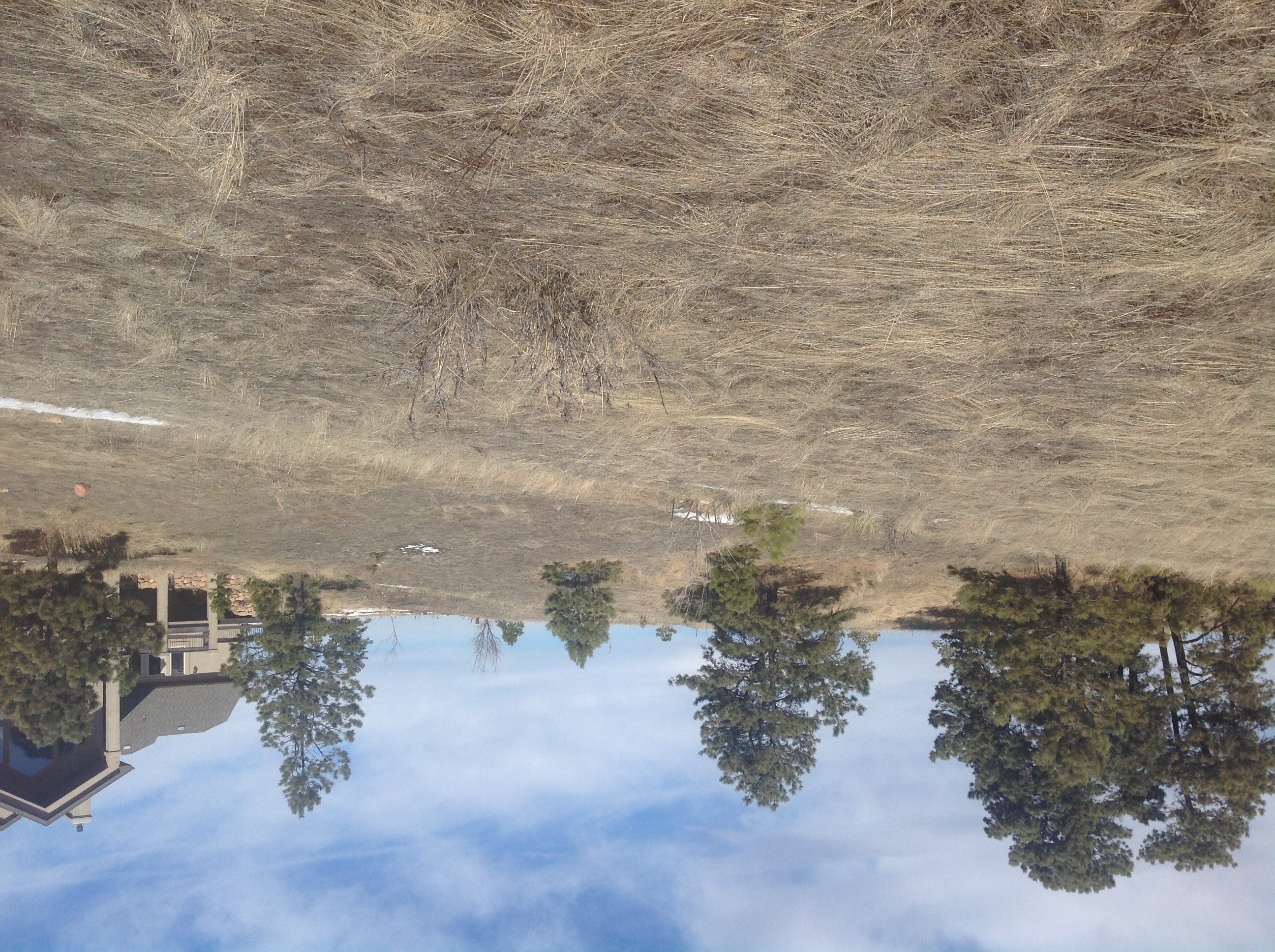

We just moved to a 35 acre property in Colorado. The land is rolling pasture with some widely spaced evergreens and a pond. The property was vacant for almost 2 years so the lawn, if there ever was one, is non existent. We have an 800ft gravel drive, that comes down a moderate grade. I am looking for a tractor that can handle mowing about 5-6 acres of this pasture, with the goal being an acre or so of decent lawn around the house and the rest of that 5-6 just infrequently cut and kept looking decent. It is pretty arid here, so we don't get a lot of weed trees and thick stuff.
I also want to plow (or blow) that driveway, and keep it graded. I may want to till a garden at some point or use a tiller/grade around the house as a basis for establishing lawn.
Snow here can be deep at times, and drifting is the main problem. However snow is dry and powdery (that famous Colorqdo powder), and the sun usually melts off a lot of what the wind doesn't blow away within a few days of a big storm.
To date, I have been focused on Kubota, with my main interest appearing to fall in the B series, specifically the B 2650, but I am open to all suggestions. I think the 2301 might not power everything I want to power, and I like some of the upgrades of the 2650 over the 2601. I looked at the L2501 briefly, but my gut says it might be too heavy for the mower type use around the house. I went in thinking BX, but the more I thought about it and researched, I think I just need something bigger than that. I'd love a cab to protect from the wind driven snow here, but I just can't stomach the extra $$$$ of that glass bubble.
My concern with the 2650 is whether the MMM, which is ground contact will work for mowing my 5-6 acres of pasture. For that matter I don't know if the suspended MMM on the 2601 would be any better, or if I should just get a 5' rotary cutter for the job. If I go with the bush hog now, I'm wondering if the MMM is even worth the extra $$$ to get with the package, thinking I might use it later closest to the house, or if I should just plan on getting a finish cutter for the 3pt later... Or I could get the 60" MMM now and try it to see if it will do the job before I decide on adding the bush hog. So much indecision.
Now for snow, I was wondering if the 60" FEL would do the job, combined with a rear blade, or if I should get a front snow blade or a blower. I don't want to do a lot of forward/reverse/turn/dump on the single lane driveway, but if I can just float the FEL on the gravel and blast through straight a few passes using the rear blade to divert th spillage, I'd be happy (until the wind drifted it all closed again, that is).
Is the rear blade all I need for grading the drive, or should I look into a box grader or scraper?
Not sure what models of or sizes of blades, tillers, or cutters to go with, so any advice is appreciated.
So, I bow to your collective wisdom. Please recommend a tractor and implements. Pictures are attached so you can get an idea of the property.

Wow, very pretty land. Welcome, I think the 2650 is the smallest tractor I would want for your property.
Your idea of just getting a brush hog now and maybe a 3 pt finish mower in future for around house and other finish mowing needs makes sense to me rather than a mmm.
Another option if you are only finish mowing one acre around the house a small dedicated mower for that chore.
I would definitely get the FEL now with package. They are a little awkward for moving snow, but for other uses a must. You can always add a blade or snow blower later as the FEL will never be as good of a deal as you will get with tractor purchase unlike other implements.
Nothing beats a land plane for grading a drive, but I agree with what you wrote that a rear blade would work with the snow removal in conjunction with your FEL and come in handy for other non winter use.

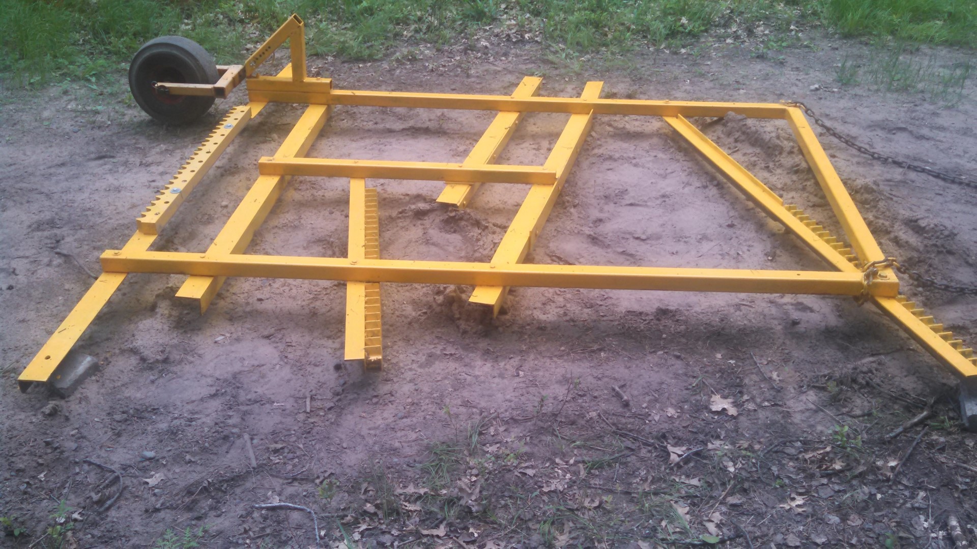

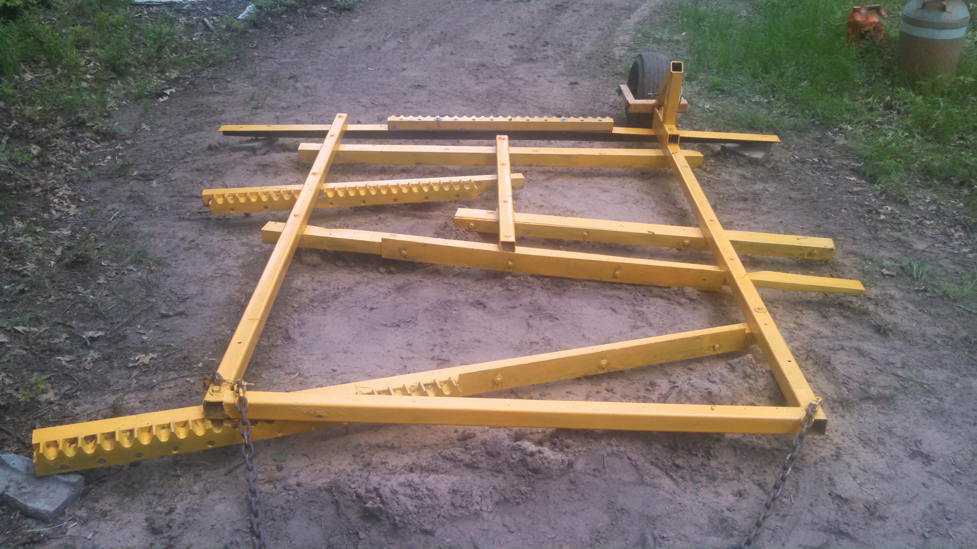

Wow, your driveway looks good. Lots of gravel. A rear blade or box blade (with guide wheels) would work well and a land plane/dual blade grader would work great. Here is what I made to maintain my 1/2 mile driveway:
https://www.youtube.com/watch?v=URHteVfiYDI
Road draga (Large).jpgube.com/watch?v=URHteVfiYDI"]https://www.youtube.com/watch?v=URHteVfiYDI[/URL]

1. Go look at a few other dealers like Massey, kioti, etc. And do it soon. Why? Well I figured out that FIL stands for father in law and he owns a kubota and that's what you 1st went to see. So by going to some other dealers just to look (even quickly) . . . you downplay the expectation of Kubota so you can not feel obligated to go his choice. I know it sounds odd . . . but "slowing the decision train down" . . I think . . . is a good plan :)
2. I'd walk the property with a d handle shovel and I'd dig a couple shovelsful down in numerous places to discover what your soils are and where they are. Are you in clay or sand or shale bed or rocks or ???. This will give you an idea of lawn potential vs. pasture vs. Semi arid. Then I'd find a lawnmower to temporarily use to ride the property to get an idea of roughness vs. Smoothness vs. Water runs etc. It isn't so important to cut the grass but morebto get your butt feeling how rough is the land . . .and where is it like that. In my thinking . . to plan your land you have to feel and see your land . . . but not on an atv or truck or at a distance.
3. If it hasn't been cared for in a couple years . . the above might give you some ideas what it could become . . and right now mother nsture is hiding it from you :). Now once you get an idea the types of soils and feel the roughness of the terrain locations . . you get a better idea of tractor needs.
4. So now let me assume a couple things with that information. The house looks really nice and "not small". Maybe a 1 acre yard might be a little small for that house :) And maybe you'll have some pets or kids/grandkids coming over. Would you fence the yard to keep wandering animals away from the lawn. Or maybe a firepit further away from the house for privacy or ??? My point is . . Its a nice house and you have nice property and you may want more safe "family space" than just 1 acre.
View attachment 459771ube.com/watch?v=URHteVfiYDI"]https://www.youtube.com/watch?v=URHteVfiYDI[/URL]
View attachment 459771 View attachment 459772
I am curious.
How do you turn that "road drag" around?
/ First Tractor purchase advice #20
I have a turn around driveway, and I just do a U Turn when I get to the main road. My neighbor used to pull it with his pick up, and when he came top the end, he just did a series of back up and pull aheads until he was pointed in the right direction. The drag just spins around.
