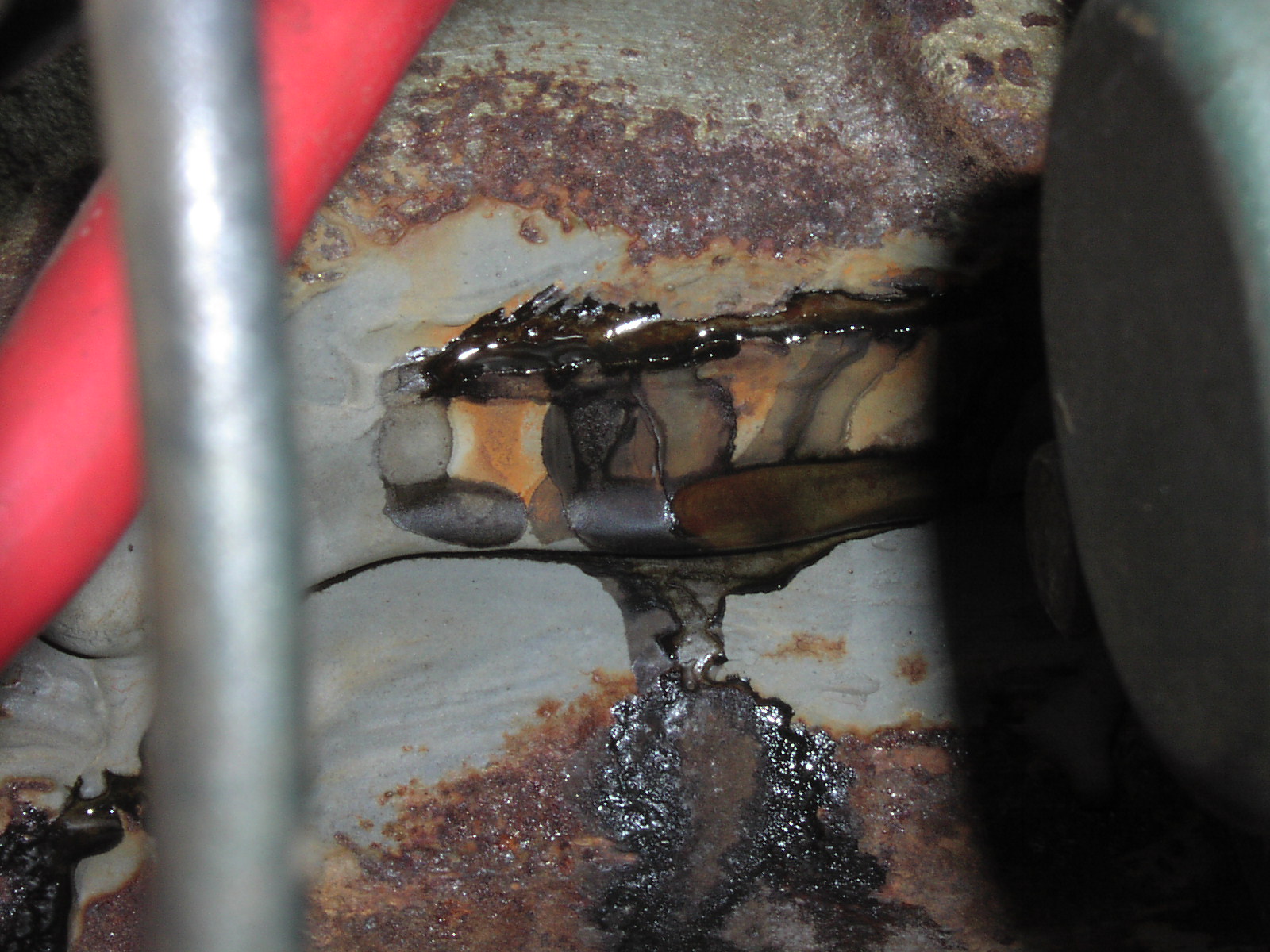

Drained a small amount of oil from the crankcase into a jar and let it sit an hour. Nothing but oil, it appears that I have no cross-contamination going on. Things are looking better
   / First tractor, did i get burned? ym2000 cracked block.... #42
You have operated the tractor enough to indicate no serious issues I expect.
If it was dumped full of radiator stop leak would continue to fill and drain with water over and over. I like the six hour run time max radiator cleaners. They also protect the cooling system when running plain water.
   / First tractor, did i get burned? ym2000 cracked block.... #43
Water will go to the bottom so sounds like a good sign you probably have no cracks into the crankcase. Normally letting something sit overnight will settle any water out, a few days is better. But just cracking the drain plug will let any water out if there is any it will come out first. hth

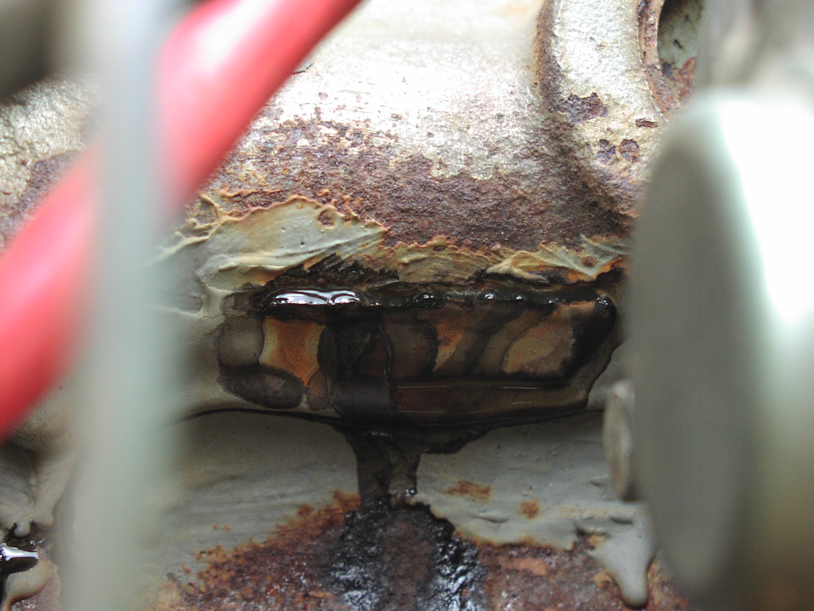

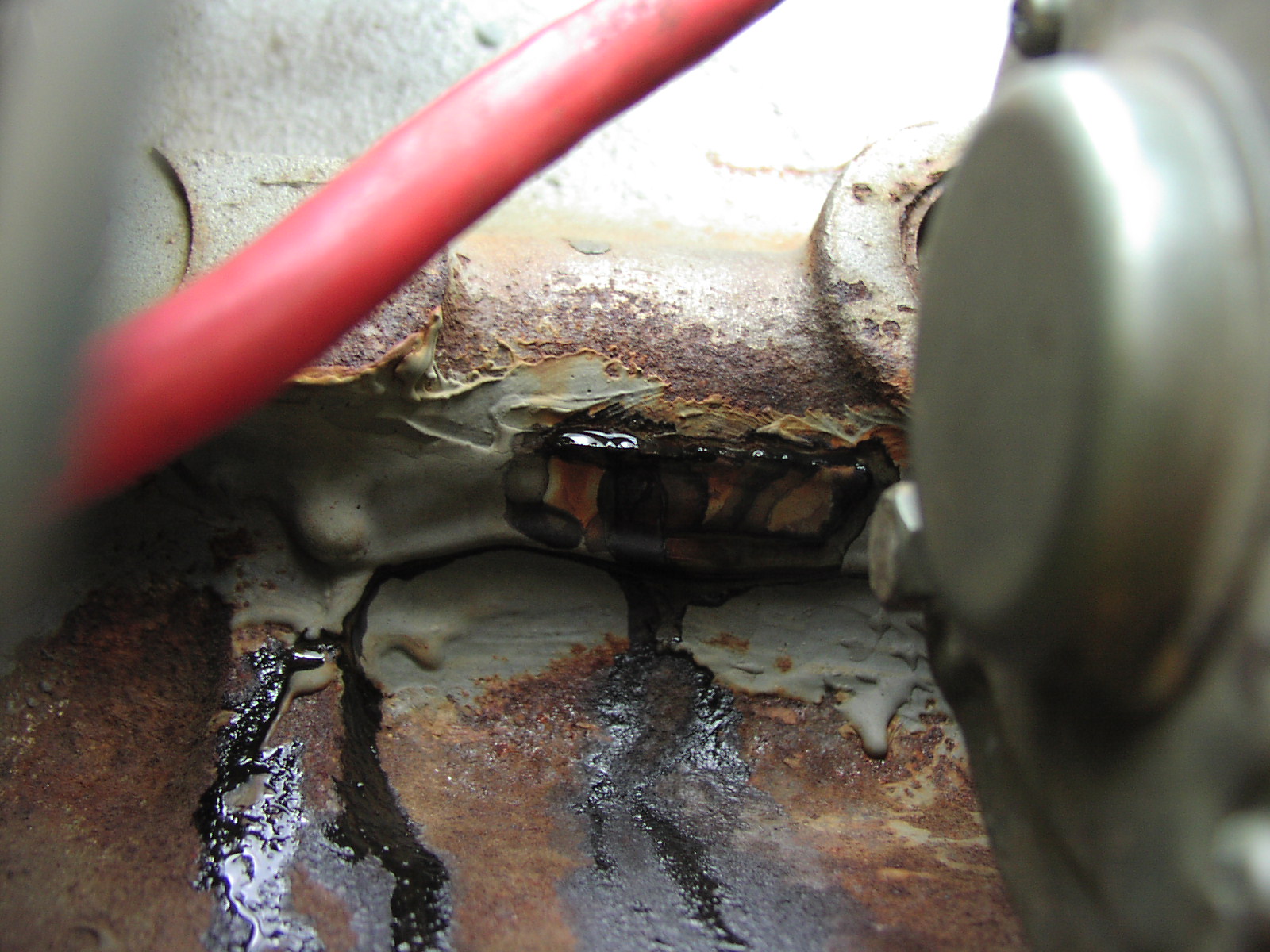

I have been reading your post. I bought an old farmall super A once that had a cracked block. Did not know it for the first year. I was rebuilding my carb and while removing it, I noticed something on the engine (turned out to be silicone caulk) and pulled if off. Coolant immediately started running out of the revealed crack. I was rather upset, but being a reasonable guy, I knew my coolant / oil was not being contaminated, so I took a side grinder with a twisted wire wheel and cleaned the area. I then took a grinder rock on said side grinder and very lightly removed about 1/16th inch of material until I had a fairly smooth groove in place of the crack. I then drained the fluid from the system and waited until I got off work the next day. I cleaned the area with brake cleaner / carb cleaner / alcohol, mixed up some JB weld and applied it and let is sit for about three days to cure. I used that tractor with no issues at all for 5 years before I let a friend talk me out of it. I replaced it with a YM2000. I gave $1500 for it with a 5' bushhog, 4' bushhog, 4' disk, 4' boxblade, and a dirt scoop. While I miss my Super A, I came out way ahead...

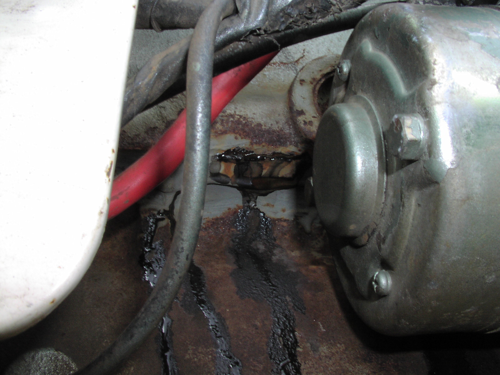

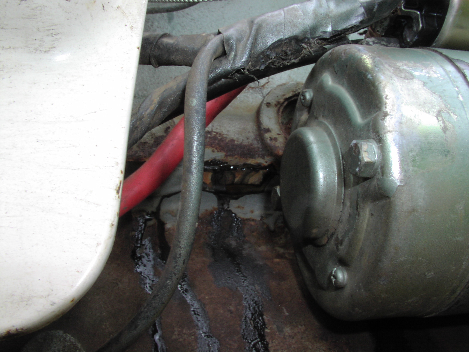

Hi all. Here it is, 2015 and I am looking at the same dilemma, except I have not bought the tractor yet. I am looking at a YM2000 with a FEL. Local guy who sells used farm stuff wants $3800 for it. Engine starts and runs well. No sign of water in the oil, but coolant just runs out of the badly JB Weld repaired crack. Claims he just got it and did not know about the issue. He says he will have his mechanic look at it and get back to me. I am considering making a offer on it as is. Is there any such thing as a short block for these tractors? Also the clutch does not completely disengage. Is this an adjustment issue, or something more serious like with a hydraulic clutch? TIA for the communities input.
   / First tractor, did i get burned? ym2000 cracked block.... #47
Clutch normally can be easily adjusted unless the clutch plate is worn too badly. Normally around 1" of free play on the peddle is all there should be. An inch either way can make a big difference. As far as the JB welded block...I would run away or realize you are going to have to replace it and make sure the deal is that good. Others may disagree but a cast block is not repairable in my mind or at the least considered that way for negotiating.
   / First tractor, did i get burned? ym2000 cracked block.... #48
cracked block is enough for me to stay away..Sort block.. I doubt it,but If you were to find a used engine.. It's probably going to be expensive

have not seen an update but brazing is the best way to go on cast. i would pull the freeze plug and use a dental mirror and look inside as it is right by the crack. willing to bet it is just the water jacket area. another idea is to reverse cut the crack and pack it with jb weld just like a dentist would do. the dovetail of the reverse cut helps lock the jb in place. have seen both done on a block and lasted longer than the tractor. another is to drill and tap a series of holes (after checking that is only!!! the water jacket area) and adding a metal plate to hold the jb weld in place. (most likely overkill though).....
