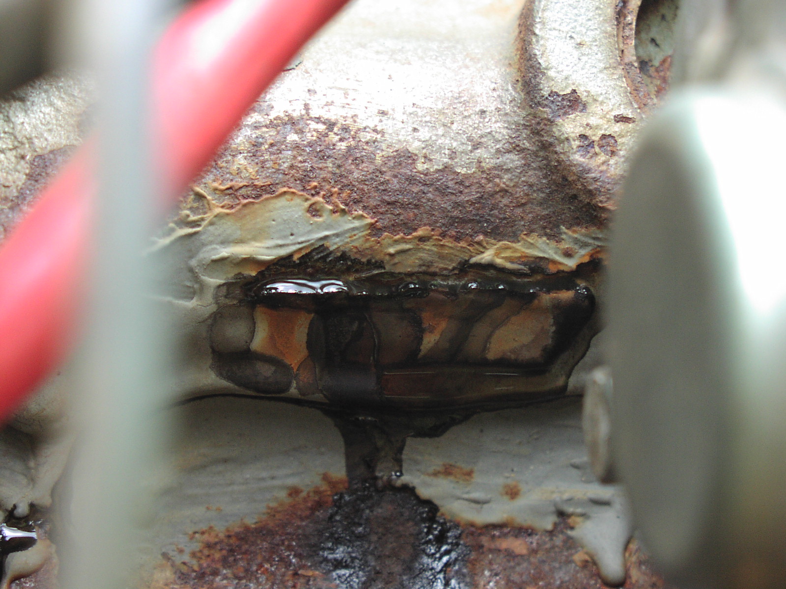

OK guys finally time for an update. I flushed the cooling system out some more, added coolant and some radiator flush. my radiator cap was leaking a good deal so i got a new one. I also got a temp guage from hoye tractor and installed. I ran the tractor today at @ 2400 rpms in the yard just creeping in reverse and 1st in the lowest gears, i did this for maybe 15-20 minutes and it never got above 195 degrees. BUTTTT, i popped the hood open, and what do you know the crack in the block in seeping with what i think is a coolant/oil mix. Its thin and black, but tastes sweet like antifreeze. Im waiting for it to cool down to check the oil for water and vice versa. I have some pictures to share. The crack is above the big goop of what appears to be jb weld, the highest point that is wet. tractor 011.JPGtractor 012.JPGtractor 013.JPGtractor 014.JPGtractor 016.JPG

Maybe I am mistaken or have been out of the loop for a long time but as memory serves cast iron is extremely difficult if not impossible to weld. You better be carefull or you will cause more damage to the CI block then what is already there. Personally, I would have returned the tractor and demanded my money back...that is a serious issue far greater then GB Weld. As I recall, threaded inserts need to be installed in the metal prior to welding and the are pre-heated, etc. to even have a chance. Maybe finding a used block won't be overly difficult...don't know.

It does not appear that there is oil in my coolant or vice versa. As a temporary fix im going to drain coolant, use a grinder with a wirewheel to remove all of old jb weld, clean up area well and apply 2 thin coats followed by a 3rd thicker coat of jb weld. If this holds it from leaking out the side of the block i will continue to check my oil and coolant for signs of contamination from the other. I know a guy who has welded his entire life for a career, before there was mig and tig, and is now a welding inspector. He has welding many thousands of cast items in his life and if i decide to get it welded he is the guy i will ask.
Would anyone know where to find or look for a bare engine block? or even a short block or running engine? I could swap all my internals into a good block if i could find one. I am planning on starting to use this tractor in the next month so we will see how she fares. Thanks guys for all your comments and suggestions, Chris

Seems to me nothing to loose to grind down and rough up the patch on it now, and the clean and try a JB weld fix..Its worth a shot.Ive welded cast with good results, but its been on something that wasnt as delicate.

I agree with Chopped. You might look into Devcon patches as I have had very good results using them.

Normally a small hole is drilled at the ends of the cracks to relieve the stress and stop the crack from getting longer. But who ever does the welding will do what he knows and it will be tough to weld leak free but thats what silver seal is good for fwtw.

i have welded yanmars my ym1700 2x4 is a welded block... it not hard to do. i do it with a mig welder and co2 gas.yanmar block are more cast steel then cast iron.some times i get a good deal on a good tractor that needs its block welded.

I agree with Coldwater on this some cast is better to weld than others and he has done it so there ya go. I used to mig weld Toyota 4cyl pickup cast iron exhaust manifolds all the time and they would weld nice with a mig and 75-25 even all I could figure was the steel content (or whatever) must have been high.

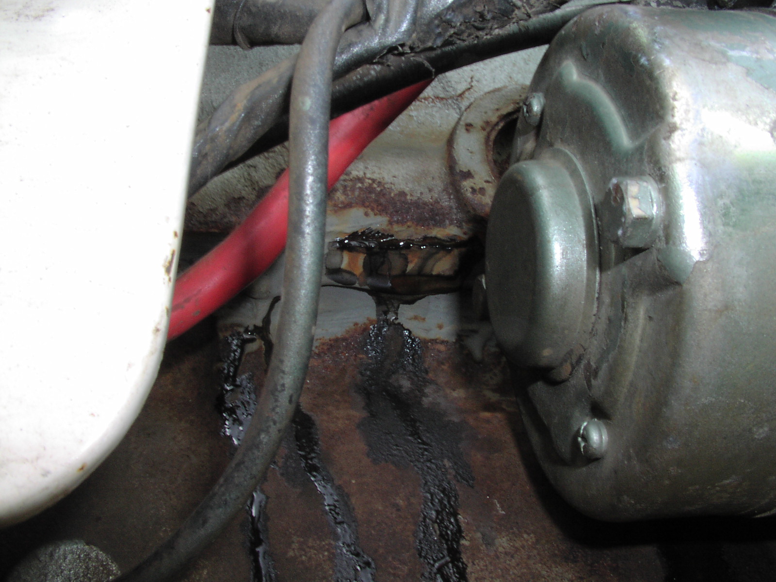

Well im looking at the motor to see any parts i need while i order stuff and what do you know! I think i see a crack in the block near the starter! it looks like it has been partially jb welded or what not. Its not leaking but im concerned about my block being cracked. How do i know its not cracked on the inside?
Im out of $2800...i Barely even make that in 2 months right now.Im mechanically inclined, self taught. Im wondering if i just slapp more jb weld on it, and replace the head gasket and water pump and hope it doesnt overheat. The engine runs great, but has cracked block/overheating issue. What do i do?

My opinion there are 2 cracks. One outside and one inside. Because you are getting oil and antifreeze. Or the crack could be long and into water and oil. But I don't know how the oil and water jackets are in this block.

Djames55 I agree there has to an opening into both the oil and coolant chambers.

Good chance there is an internal crack but not knowing the history it could be a blown head gasket allowing water in oil. Whole thing is a mystery.

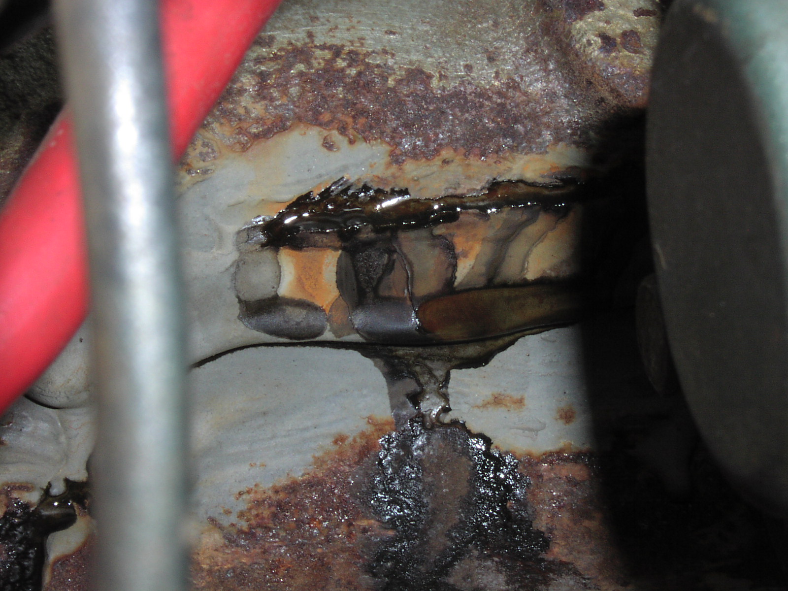

Sorry i have not had time to get on here guys. I just removed my starter and other things that were in the way to get to the crack. I took a grinder with a wire wheel to the crack and it runs almost the entire length of the water passage way in the block. I have decided that i am going to weld it with Crown Alloys royal 44-30 mig wire which i have heard of great results mostly on marine blocks around here locally and online. The jb weld that was previously on the crack looks as if it helf 75% of the crack from leaking. Im sure if done again/correctly with better prep that it would hold and last. If the crack was shorter that is what i would use. I am going to bevel out the crack just very slightly with a dremel, drill the ends of the crack, then slightly heat the area with map torch to burn off any coolant or oils to assure i get a good clean weld. I will be welding very short tacks maybe 1/4" or less at a time to keep the heat down.
I also drained my coolant once again. It does seem dirty but i see NO signs of oil in my coolant so i am good there. I am going to drain my oil and check it out as well but from the dipstick it appears to be in good shape, it doesnt look milky or "waterey" for lack of a better term.

snake and crack 006.JPGsnake and crack 007.JPGsnake and crack 008.JPGsnake and crack 009.JPGsnake and crack 010.JPG

Just a thought. From the earlier photos, the black stuff running down from the crack looks a lot like what Bar's Leak looks like. If the previous owner had been dumping Bar's Leak in the coolant, you may have a bunch of it in the lower passages.
