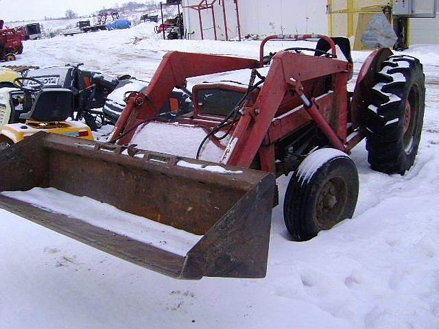

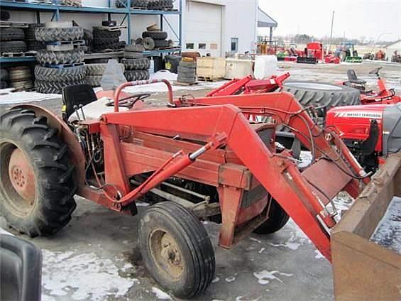

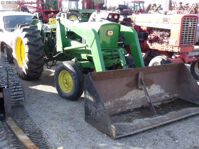

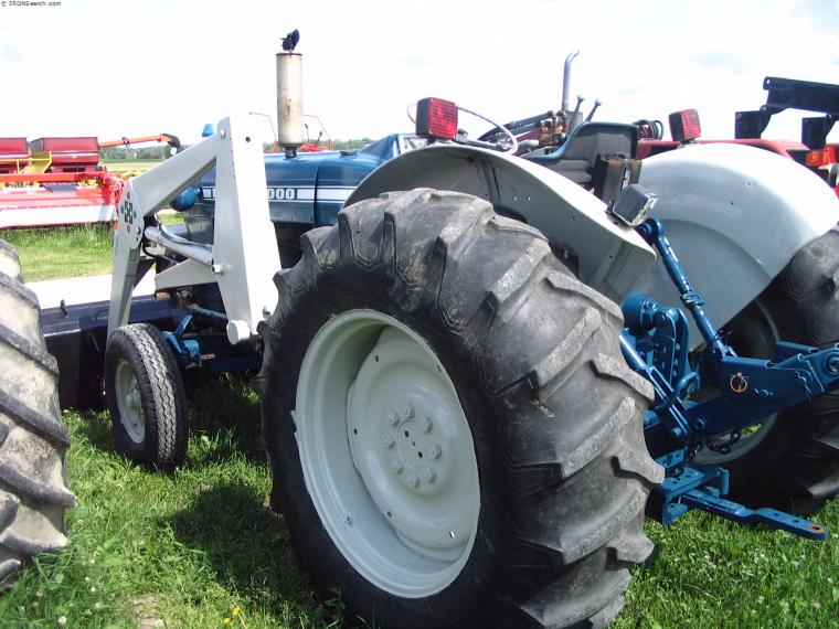

Looks like the Ford is the biggest of the tractors and the MF135 is the smallest.
The JD is the only one listed as a diesel, is this a positive or a negative? I know they are better for economy but are they more headache for repairs?
The closest dealer of these manufactures is a JD dealer that is only about a 5 min drive.
I know a little bit about the MF65 as my father-in-law has one. I was able to fins photos of each, of course you can see a lot in the photos though.
Thanks to everyone for their help.
