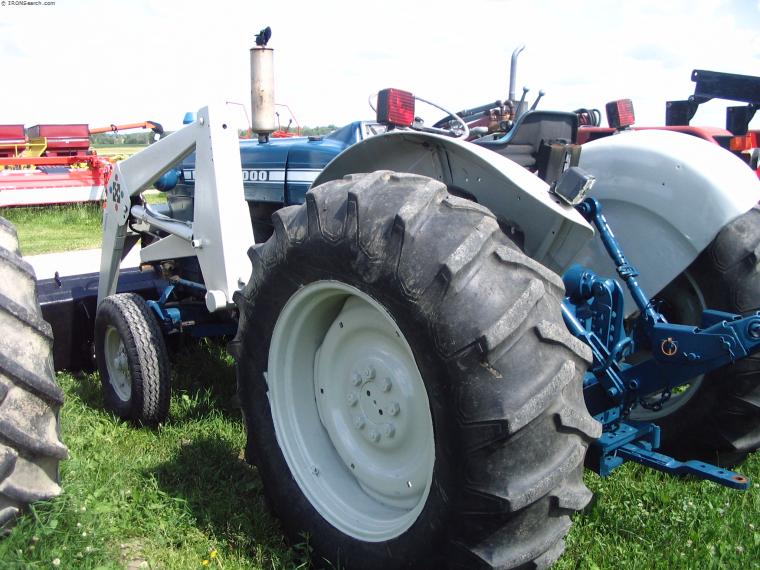

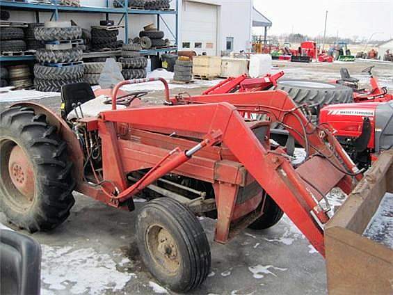

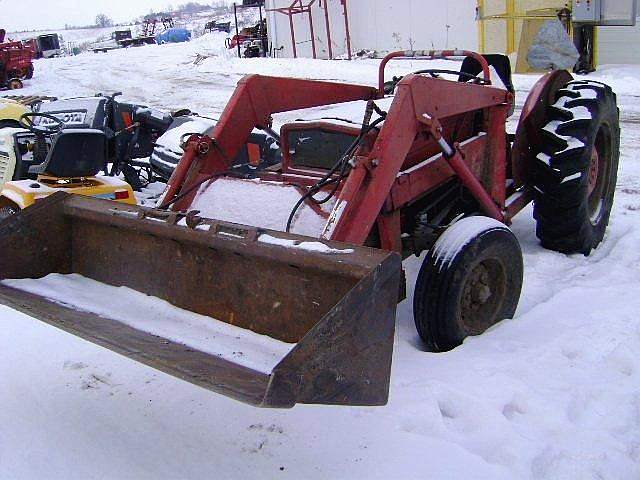

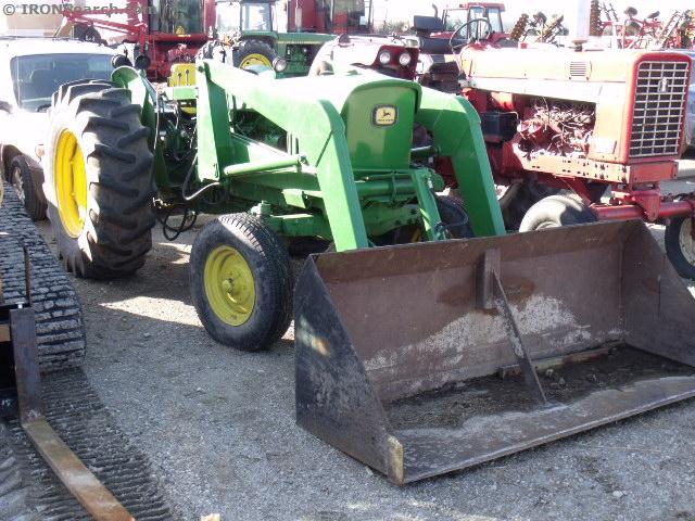

nuttin wrong with the mf 65 or 135.. good solid tractor.
ford 5000 is one of fords best models.
my info on the jd says 69 as the first year of production.. but that could be a model year code, with units produced in late 68. about 68 eng, and 60 pto.
ford 5000, if a later model with the 256 engine will make 70 eng, and 67 pto. Figure about 38 pto for the 135, and maybee 48-50 on the 65.
if the ford is a 256ci model ( press in freeze plugs ) it will have the better steering setup too.. hopefully it's an 8spd.. if so.. it would be my choice.. with the 65 perhaps as the next choice.

Looks like the Ford is the biggest of the tractors and the MF135 is the smallest.
The JD is the only one listed as a diesel, is this a positive or a negative? I know they are better for economy but are they more headache for repairs?

I know a little bit about the MF65 as my father-in-law has one. I was able to fins photos of each, of course you can see a lot in the photos though.
Thanks to everyone for their help.
