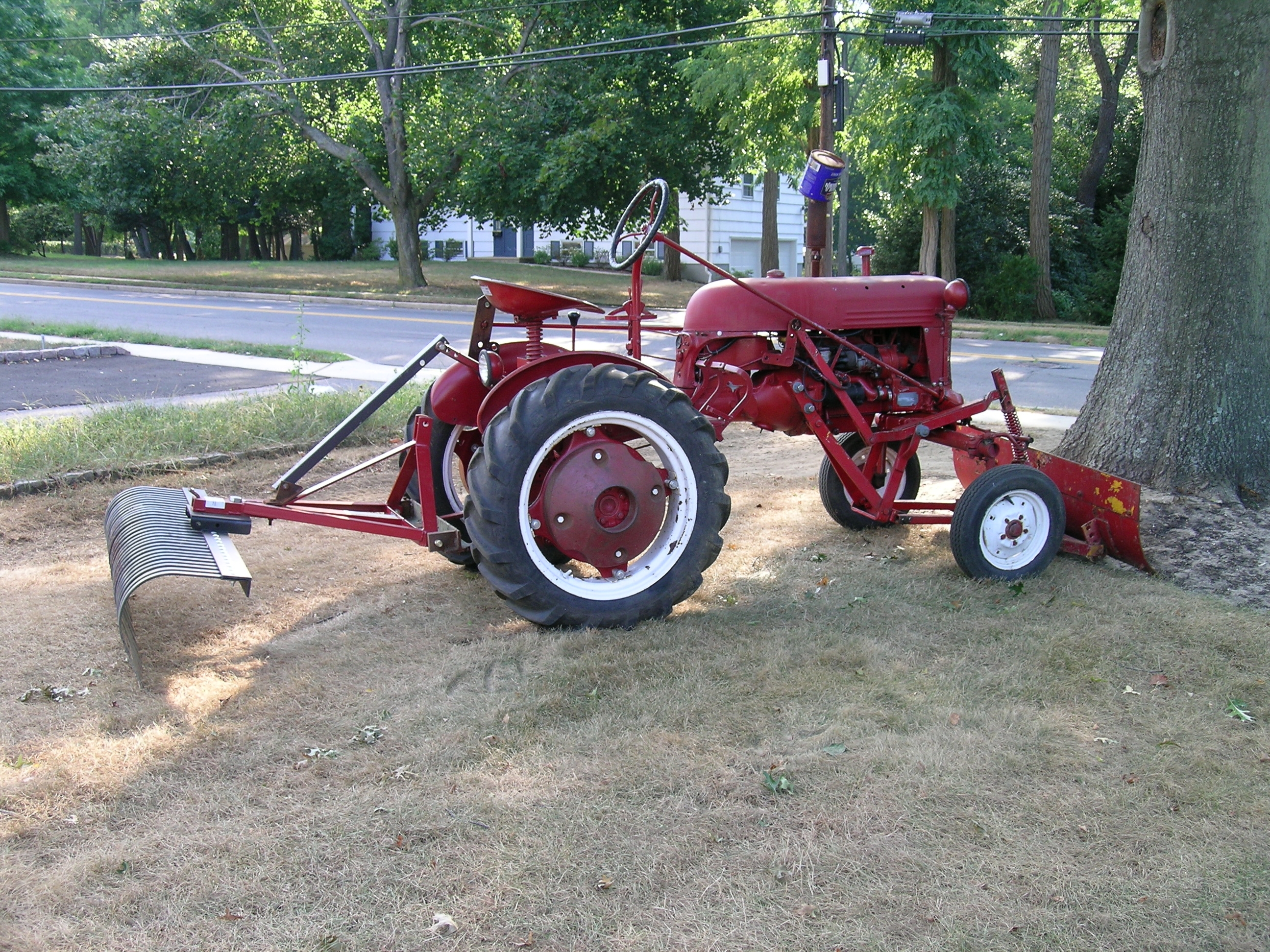

Here's my old machine - not loader friendly. Sold it a long time ago.
Appreciate all of the comments!!!!
