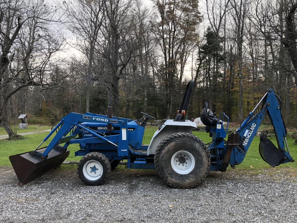

OK, I know nothing at all about tractors!
I have been building a house for 5 years and how have a bunch of yard work to do (landscaping, drainage ditch, driveway, ...).
On top of this, it takes me 5 hours to mow the lawn with my little cub cadet (law tractor 22 hp, 54" cut).
I want a tractor that "does it all" ... 4 x 4, so I need a bucket, back hoe and finish mower ... maybe even a auger and forks.
I found a 50 hp for a good price but my neighbor pointed out that an 8000 lb tractor will just leave ruts in my very moist lawn (I live on the edge of a river / wet land).
I just found two tractors that interest me. First is a Chinese made Farm Pro 2425 with a bucket and backhoe ... 2005 ... $8500 ... 2000 hours ... AG tires. 3000 lbs. Still might leave ruts .... but might not ???
Maybe someone could comment on this one.
The other one ... and why I am here ... is a 1994 (maybe 96 ... owner doesn't know) New Holland 1920. It has a bucket and backhoe. Just under 700 hours. New front tires. Decent rear turf saver tires. New clutch, cleaned / rebuilt injector pump. I was told by the seller it sat for two years after the last owner died. The seller is a retired mechanic. He bought it, cleaned it up, fixed what needed fixing (I think he said he also put in a front axle seal) ... and now it is up for sale.
It started at $12,500 ... then $12,000 ... now $11,500
So, is this a good price ... too much .... good tractor model .... problem model .... ???????????
Any advice would be greatly appreciated !!!!!!!!!!

That's a nice tractor, however there's a couple things to consider.
1. Are you handy mechanically or have a good shop that is? Stuff does eventually break and knowing how to fix it helps a ton here.
2. Parts are getting harder to find for the XX20/XX10/XX00 fords. For our 1500 I couldn't find a tach when ours broke so had to adapt one from at 1510.
3. If you're planning on doing a lot of loader work a gear tractor may not be the best choice. I'm easily 3x as fast/effective in our L4760 no including the weight difference between it and the 1500 from the HST alone.
4. Consider how much you need a backhoe vs renting out one for the jobs you have. Ideally you want to gear the tractor towards ongoing maintenance(mowing, gravel road upkeep, hay stuff) instead of one-off jobs that are better renting/hiring out.
That said the 1920 are solid machines and could make a good tractor to get your feet wet. We got 4 good years our of our Ford 1500 before moving to something bigger and it was money well spent.

Nice tractor excellent shape and if a mechanic owned it he probably stayed on top of things. Gear tractors do suck with a lot of loader work but your not going to find a 35 hp hst with a loader and backhoe in that kind of shape for 11,500. Hst is new millennium thinking when that tractor was new their was no HST and it didn't bother anyone to shift gears . It's definatily worth the money.:drink:

Great tractor. Very good price. Parts for the 20 series should be OK. You could check online with Messicks to ensure what is available. I owned a 1720 that was cherry. Only issue I had was with the a neutral switch. Tractor never gave any trouble. If properly maintained that 1920 will serve you well. One of the best compacts made in that era. Shibaura unit.

OK .... after reading the second post, maybe I should be asking a more basic question ... do I want a geared tractor?
Honestly ... didn't even think about this!
Having never had a tractor, I didn't even think about shifting gears!
I know I would need to do this when I use the loader but do you shift while cutting grass or just leave it in one gear and go?
I have 3 acres .... longest run is say 250 ft .... then turn ... 250 ft ... turn .....
Is it like a truck .. would I need to downshift ... turn ... up shift?
I understand that you set the engine RPM's to get the PTO to 540 for the mower then it says there ... then do you just pick a gear (say 8th to set tractor speed to ???? mph) and cut at that speed?
Maybe I should be asking can you (or is it practical) to use the same tractor for a lawn mower and a bucket / back hoe tractor?

Until the HST became common, they were all geared tractors......there has likely been more done over the years with geared tractors than HST.
You adapt to what you have and make it work

I would call myself just an old (78 yrs) Ford tractor guy!
I have three!
A 1951 Ford 8N,... nice old tractor,.... but DON'T buy one!
A 1989 Ford 1920 FEL
A 1970 Ford (gas) 3400 TLB
All three are in excellent condition, with the 3400 and 1920 restored to like new condition.
I am a bit perplexed about a 700 hour tractor needing a new clutch.
My 1920 had 1056 hours when I bought it 4 years ago, and I did replace the clutch, because I had the tractor mostly torn down. My original clutch was perfect, but I already had a new one, so I put it in anyway. An aftermarket (Chinese?) clutch, and it failed after 3 hours. The moral of that story: BUY YOUR PARTS FROM MESSICK'S.
I am fortunate in that I do not have just one tractor for all tasks.
The 8N is useful to drag a blade, or run a 5' brush mower (used ONLY with a PTO overrunning clutch)
The gas 3400 TLB (1850 hrs.) is wonderful, with a very capable backhoe.
The 1920 FEL is an absolutely delightful little 4x4 32HP diesel tractor/loader.
The loader is good, but will only lift about 800 lbs. I have added a removable tooth bar to my rebuilt bucket, and have an EA 6 way 6' deluxe scrape blade, a KK 5' box blade, a KK 5' tiller, a Ford 2 bottom plow, a KK 5' brush mower, and Agri-Supply 3 point hitch forks. I also have a 7' KK scrape blade to sell (the EA deluxe scrape blade is SO superior).
The 1920 backhoe (any small backhoe) will not deal well with Vermont rocks, but a backhoe is a very handy thing to have.
Messick's is a GREAT source for 1920 parts, and there are many aftermarket suppliers as well. As of today, you will not have much trouble finding parts.
As I recall, Shibaura built approximately 22,000 of the 1920 series for Ford.
I paid $9500 for my 1920 4 years ago, but I got a bit carried away with new tires, repairs/parts and painting, (most people think it is new) and have $15,300+ in it now.
The good news: I LOVE IT!. No DPF! No electronics! No regen issues! You can fix it yourself!
My thoughts: Buy the 1920! (Remember- it is not a D-8 Cat), you will love it!
Forgot to mention: My 1920 is a 12 speed, shuttle shift. The shuttle shift is a very nice feature, especially with a loader.

I had a 1989 Ford 1920 4x4 and sometimes I still miss it. Random thoughts:
Turf tires wearing out in less than 700 hrs? My Ag tires (limited rubber contact with ground) still had much tread after 8 or 9 hundred hours. That included many pavement hours, which is tough on tires. I once saw a rental compact tractor/backhoe with worn out front tires on low hours. Rental agent said it was because of customers leaving it in 4 WD on pavement. I would avoid buying rental equipment. Also, fronts may have been replace because of damage. No problem with that.
A mechanic/owner is probably good but if he bought it to flip it, that might affect which issues he addressed.
Mine was the most basic transmission and to change directions when trimming around obstacles and doing loader work, the tractor would almost need to be stopped. That gets old on a big job. Ford also had a shuttle shift transmission option that might address that reversing issue.

If the 1920 has shuttle shift, you can leave it in main gear-push clutch-pull lever in front of you to reverse, and release clutch. It is a whole lot easier than shifting a gear shift along side of you. I used a 27 hp J.D. 4210 for years and , believe me, compared to fishing for reverse when in 2nd or 3rd, , the shuttle shift is a dream. Forward is forward and back is back. AS LONG AS YOU CAN USE SAME GEAR GOING BOTH WAYS, IT IS GOLDEN. So I pick the gear I want and just shift directions. You will like it.
