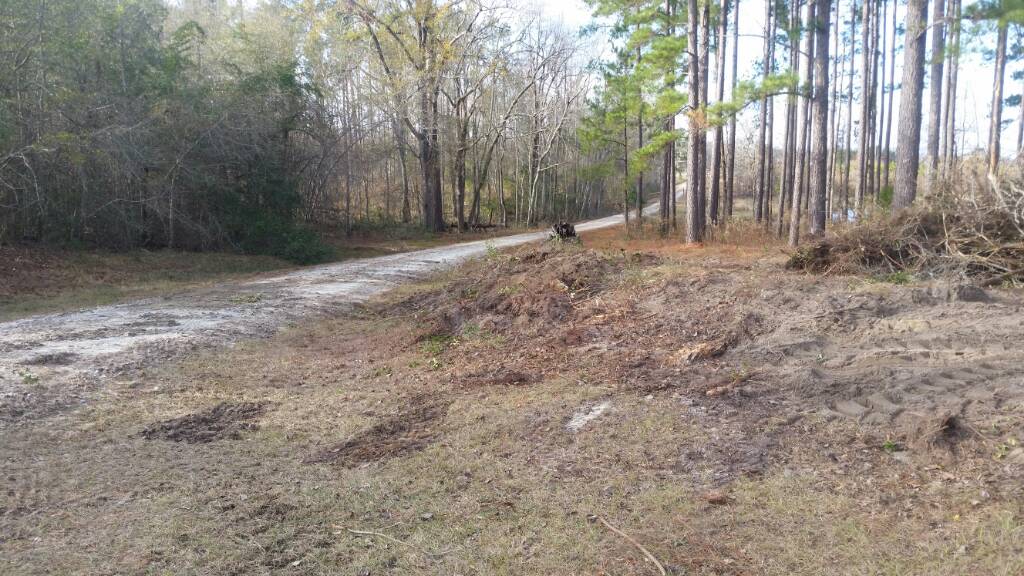

I thought from your first description you were just leveling it out and "loosing" the material right there. If you are making piles to be moved run parallel with the road starting on top and work your way down.
If you have access to a box blade with rippers you will have an easier time. Use the rippers to loosen things up and drag the material toward a pile. Typically a full/over flowing box holds more than your bucket. Plus the rippers are loosening and raising material into the box as you go.
Set the box up with your adjustable links so it is parallel with the machine side to side. The top gets adjusted depending on how aggressive you can cut. The lower the front of the box (when attached to the machine) the more aggressive the cut. If you get the front too high it will just smooth things out (but not take much material) and get the front too low and you will bog the machine down or spin the tires. If you try and adjust with the 3 point height every time you will just frustrate yourself- given the amount of material to move. So take a bit of time to get the top link set up front and the rest will be much easier. You will just need to raise the top link if you hit a big rock or root.

Pictures in post #8 LOOK like your tractor could straddle the hill with one set of tire on the flat top so the tractor will be less 'sloped' than the dirt even where you cant mow. As you move alone the blade will cut the 'peak' off.
