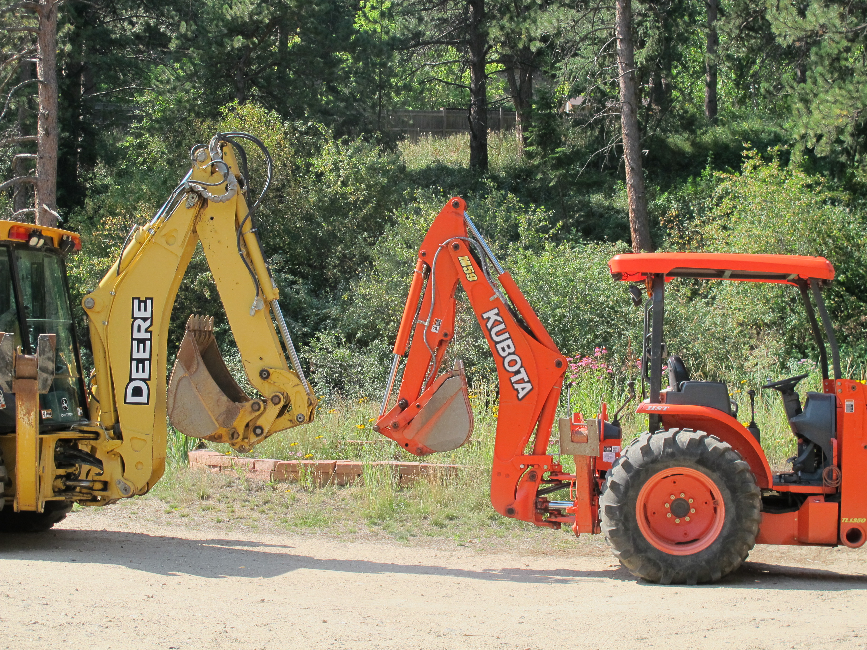

Just for comparison, here is a good closeup view of the M59 and JD310 backhoe buckets. Originally I thought that both were 24" buckets but now that I look closer at the photo I think that I have the 12" wide bucket on the M59. I'm kinda guessing because 24" buckets on both have 5 teeth and that bucket on the M59 bucket looks to have only 3.
Anyway, what I'm trying to show comes through. You can compare how heavily they are built, how the depth of "bite" differs, pin size, tooth size etc.
And I guess I just proved to myself that from the side it's hard to tell backhoe buckets apart. Even when they vary in width a lot, the profile from the side doesn't change much at all. From the side both the M59's 12" and the 24 inch wide buckets look the same.
rScotty
Oh, and here's a picture showing both the M59 and the L45. We were talking about that earlier...
rS
