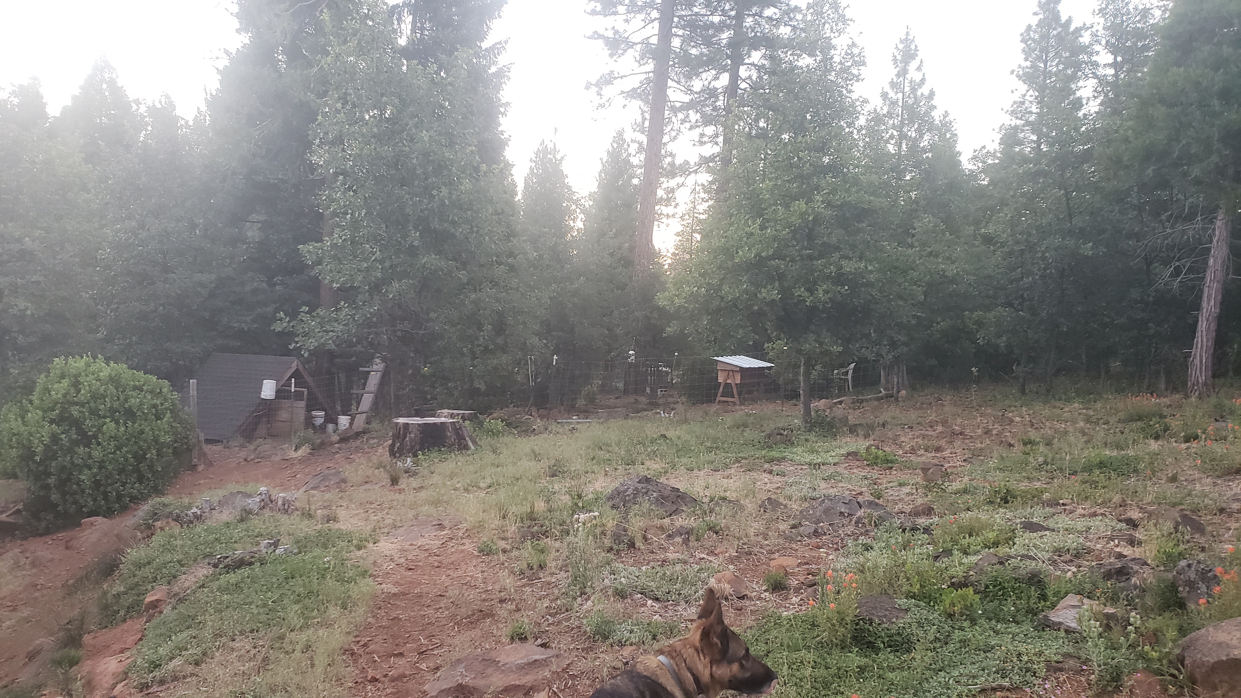

We are looking to buy our first tractor. We built our home about 10 years ago in the mountains of rural NE California at 3500' on about 3 sloped rocky treed acres in the woods.
We have many different uses for this tractor, most all being currently done by hand. These include moving approx 10 yards of sand for pigs every season (my boys show 4-H) , digging the hole to process backup pig, snow removal on 800' of drive (600' gravel, 200 asphalt), maintaining gravel drive, moving firewood and rocks, digging stumps, moving and leveling fill and native soil.
Renting is generally out of the picture as closest rental yard is an hour plus and transportation costs are high. I am sometimes able to borrow friends skid steer and Kubota b21. I don't like doing this, especially when stuff breaks.
I have been looking at used older 2x4 construction backhoes in the $10k range. I have not pulled the trigger as I worry about them being too big and too much work/problems.
I think a compact farm tractor would be more versatile, but worry about not having enough power/weight and they are 3x the price.
I have a Deere dealer about 25 miles from me. Closest Kubota dealer 2.5hrs. Branson, Mahrinda, Koiti, LS, New Holland dealers between 1 and 1.5 hours out.
I have been going in circles over decided and need some help. Which direction would you go?

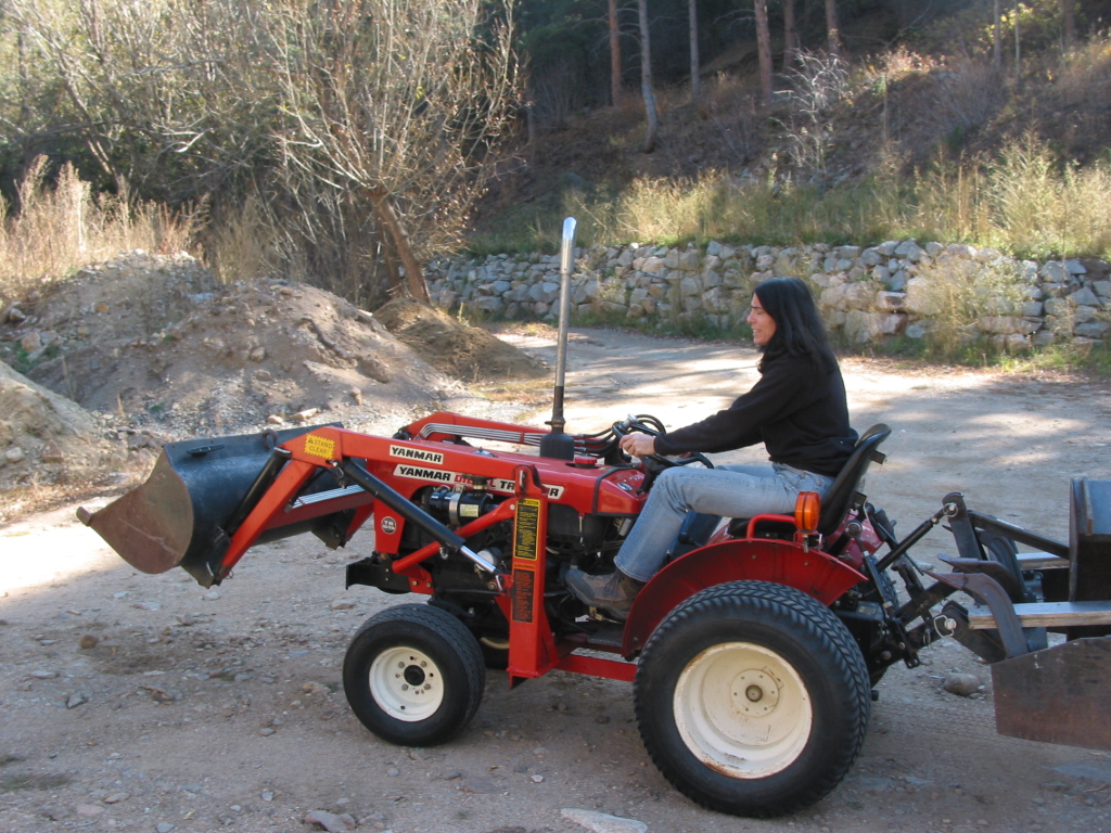

RE: Photo #3
A 2,700 pound bare weight tractor FEL will have a breakout force of ~~1,800 pounds~~, more than enough to loosen large rocks in photo. After large rocks are loose you can tow them behind the tractor with chains. Subsoiler or Middlebuster will plow through the small rocks fine. I do not see the need for a $7,000 tractor backhoe for your applications.
A 2,700 pound bare weight tractor will fit in a standard residential garage with room to spare.

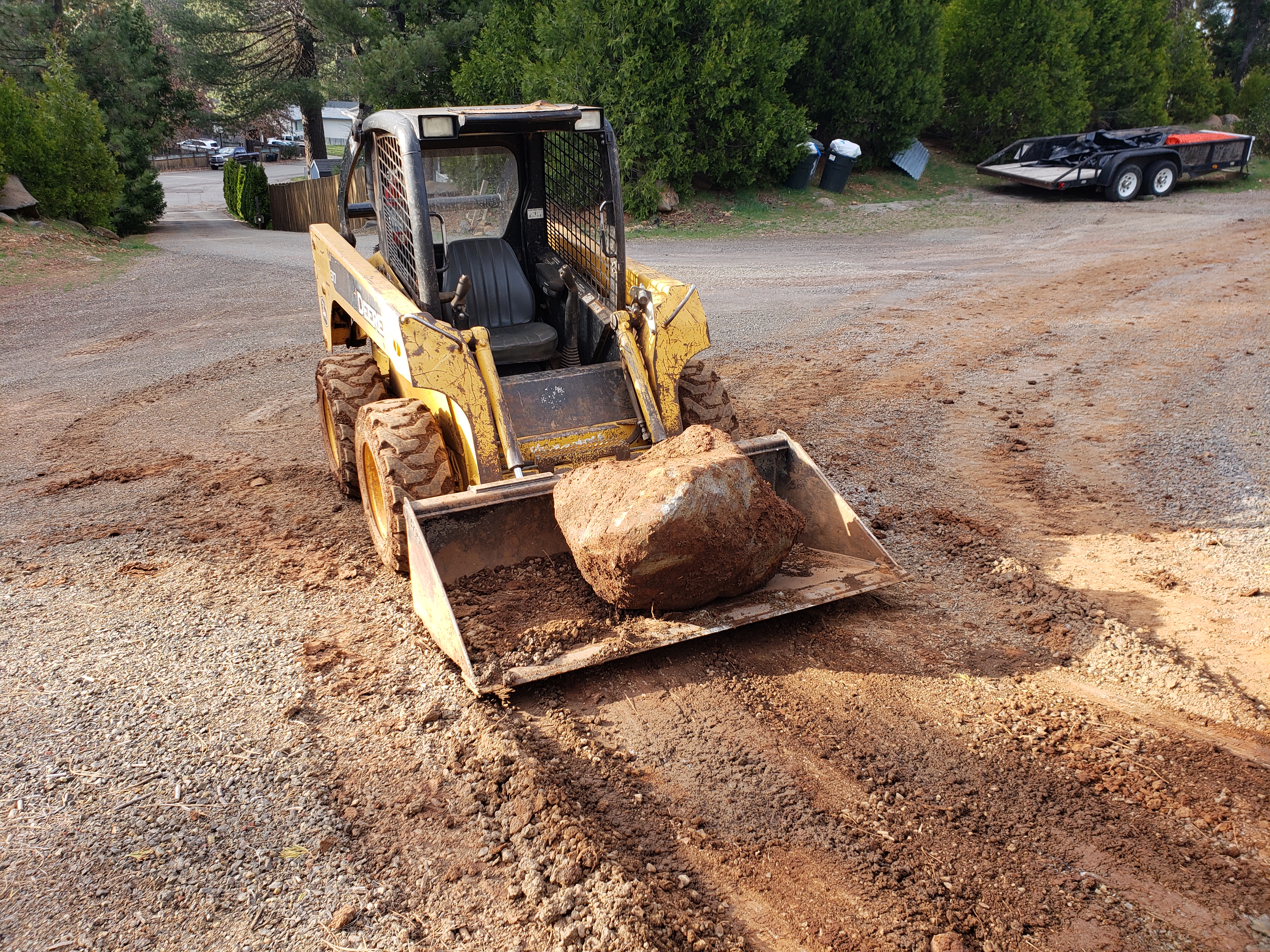

We're in similar terrain. Recently had to dig a new leech system for the septic, and the plumbing contractor rented a Cat CTL. We needed to dig a 3' wide trench, 6'+ feet deep, 50 + feet long. We're 45 minutes drive from the rental yard, they charged $200 to drop it off and pick it up, plus the rental of $275 a day. Rented it for one day, they left it for 12 more - $475 total.
The difference between a 14k lb 100+HP and a 3500 lb CUT with a backhoe is immense. So is the driving experience - especially on slopes. Popped stumps out of the ground with ease, moved large landscaping rocks, and enjoyed the air-conditioned cab. Tall, wide brute of a machine, nimble but big and a high center of gravity. Excellent for what I needed it for, but if I needed to do water lines two feet deep, it would not be my first choice. A BX with a backhoe trenches for supply lines well, and a tracked walk-behind trencher is what I rented for sprinkler and hose bib trenching. The CTL would be cumbersome and disrupt a lot of soil needlessly.
/ First decision: CUT vs construction backhoe #6
Are you sure it was a CTL? Compact track loader or skid steer with tracks? If so it’s a really poor tool for digging 6’ deep.

The rock in pick #3 was two rock bars, one shovel and a lot of sweat and muscle. That was just a few days ago.
When we built the house, I subbed out some of the trenching. The guy took two boulders bigger than a compact car out, he had to trench around a third.

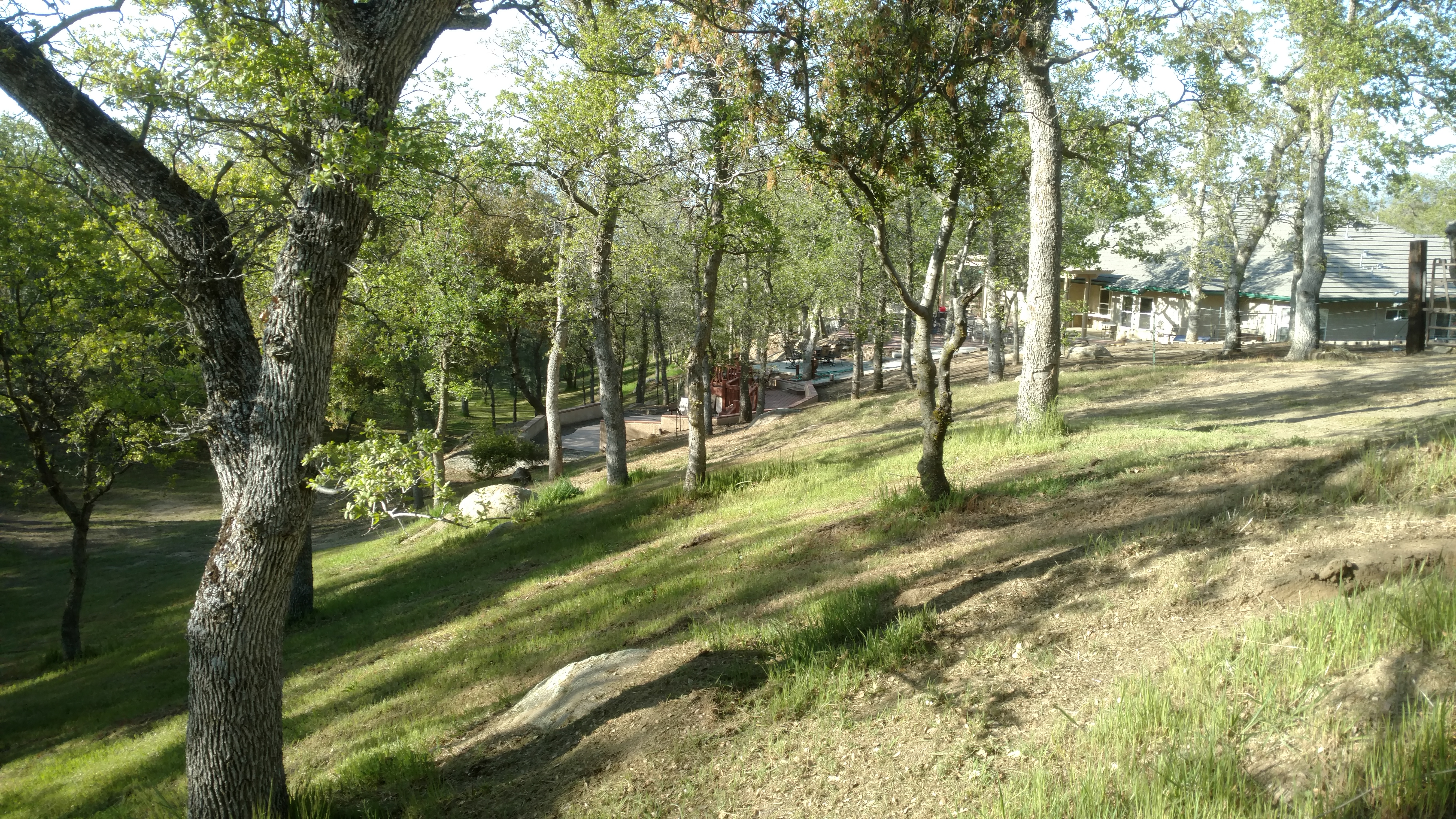

We grow 'em here, too.

First was the compact 4wd tractor w/loader & blade. Wonderful thing & much better than doing things by hand, but powerwise not a whole lot different from what you can do by hand.... just way more convenient. Kind of expensive for us at the time.

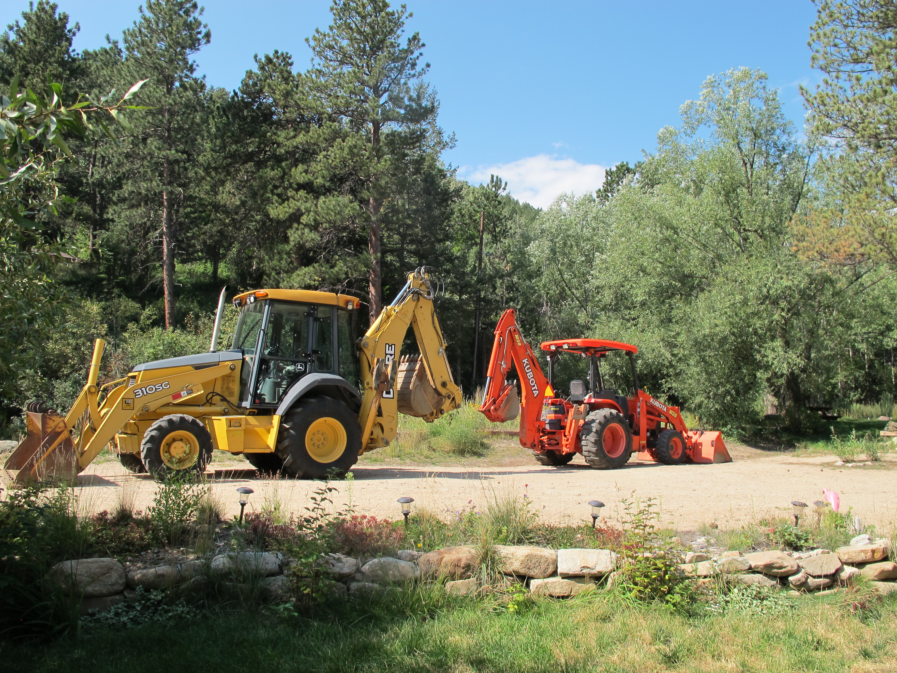

30 years later & retired, my wife bought us a new semicommercial TLB: a Kubota M59 with interchangeable cat. II 3pt/ frame-mounted backhoe. BH HAS A THUMB!!. We still use it everyday. Remarkably handy & crazy strong.
A flood wiped us out in 2013. As part of the rebuild we bought an older construction backhoe - a typical JD310G - to work alongside our M59. It is often used as a dumptruck, in the creek, or for really heavy rocks. No thumb :-(
So we have a lot of thoughts on comparisons if you have questions...

Being handy in small areas without tearing things up describes why we got a medium size Kubota TLB - the M59. Very precise and maneuverable. 980 hrs on ours now. Good side hill stability. Plus being about 60% as strong as a full size backhoe - which we also have, but use the M59 most of the time. I could go on and on about how well it works. Lots of features.... It has a thumb, turbo, quick change buckets on both ends, 6 speeds F&R, and a cat. II 3pt as well if needed.
Kubota makes even smaller TLBs. They are pricey but beginning to appear on the used market. The L39 still gets a lot of good reviews. Nice size for a few acres & landscaping.
