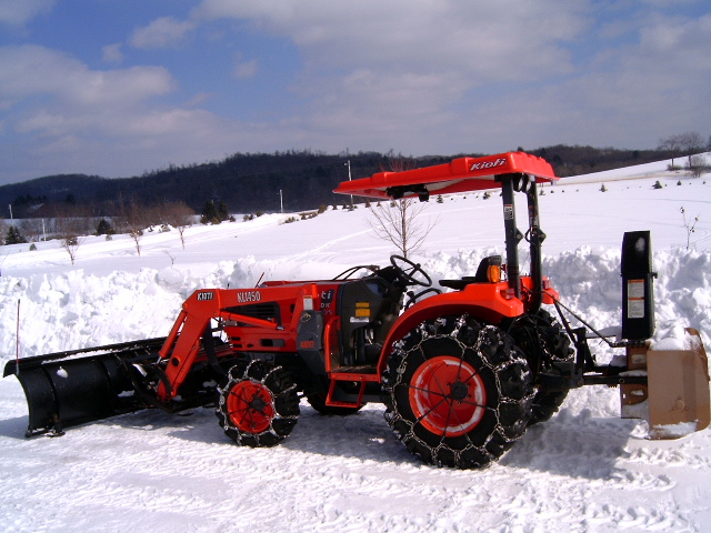

I converted a 9' Western truck plow w/power angle to SSQA for the front of my tractor. Around $500 or so invested. Works great
I found a used 63" 2 stage rear blower in good condition for $825

Great ride vince. I'll bet you look forward to snow with that rig.

Personally, if I wanted a front blade like the one you show, I'd buy a blank SSQA plate and weld up a used truck plow to it. Just like Vince's. Should be under $1000.
