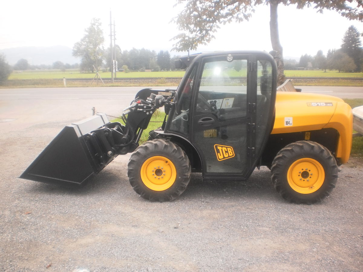

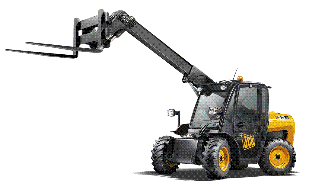

A compact telehandler is unstuckable. http://www.tractorbynet.com/forums/...pact-telehandler-post3243370.html#post3243370
For your trailer a small JCB would work. Get one with the SSQA built in.

Telehandlers can push themselves backwards out of being stuck but they can not work in super soft terrain. They can get out of darn near anything but they sink easy.
And also pull themselves out forwards if there is something to hook a chain onto. :thumbsup:
Stuck. :mad:
Tow strap around a tree, chain to the slot in SSQA, with boom extended.
Drive forward while retracting the boom.
Unstuck. :thumbsup:
