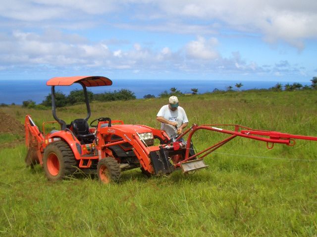

The cables are overkill for the weight that is being lifted and no further rigid structure is needed. An additional cable restricting the upwards motion of your FEL would take care of lifting too high over center. When you tested your setup with you sitting on the end of the boom you didn't account for your weight sitting in your seat which will be an added counterbalance. You can make this as difficult as you want it but I would just put a hook on the end of your boom and lift the trusses into position with the FEL. Have someone unhook your truss when in position. You're complicating the operation with a block and tackle. I've lifted thousands of loads with both helicopters and cranes and have never dropped a load or injured anyone!!
Just do it!!
Jim

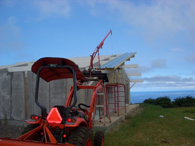

Here's some pics of my attempt. Boompole w/extension on quick hitch on FEL quik attach. I also used a 12vdc cable winch that I could control from tractor seat. Put up a bunch of wooden beams, positioned some 4K gallons tanks, placed over 8K sf of roof panels. Always took our time, checked everything and put safety first. This was my only "crane" for entire house build.
Best of luck with your project
David

I have a New Holland TC30 that has been a great little tractor for me. A few months ago it was whispering that it wanted a new house. So I'm currently building a 24x56 pole barn for it's pleasure. The next step in the barn build are the roof trusses. I need to lift the trusses and place them on top of the headers since my truss builder does not do building-top delivery.
The FEL on my TC30 can only reach up about 10 ft, so I decided to rig up a crane-like boom to allow me to hoist the trusses up above the building to set them in place. I wanted to keep the rig as simple as possible, with a quick breakdown and minimal tooling. The rig I came up uses a 14 ft pipe to give me a total working lift height of about 22 ft, cost less than $100 total, and only took a couple of hours to rig up. When finished the pipe used for the boom will be recycled into steel corner fence posts. I'll keep the rigging for possible future needs as my wife is whispering about her new house.
I was initially concerned about the hydraulics being able to handled a "leveraged" load on the end of a boom, but I weigh about twice what a single truss weighs, so after this test I'm confident the FEL will live up to the requirements of this task.
A slide-show of the entire build is available for anyone interested.
Phil
Cable is notorious for stretching and the way you have that pipe haphazardly placed over that tooth you have no more than an accident waiting to happen. It will be work but just not my way to do things.
