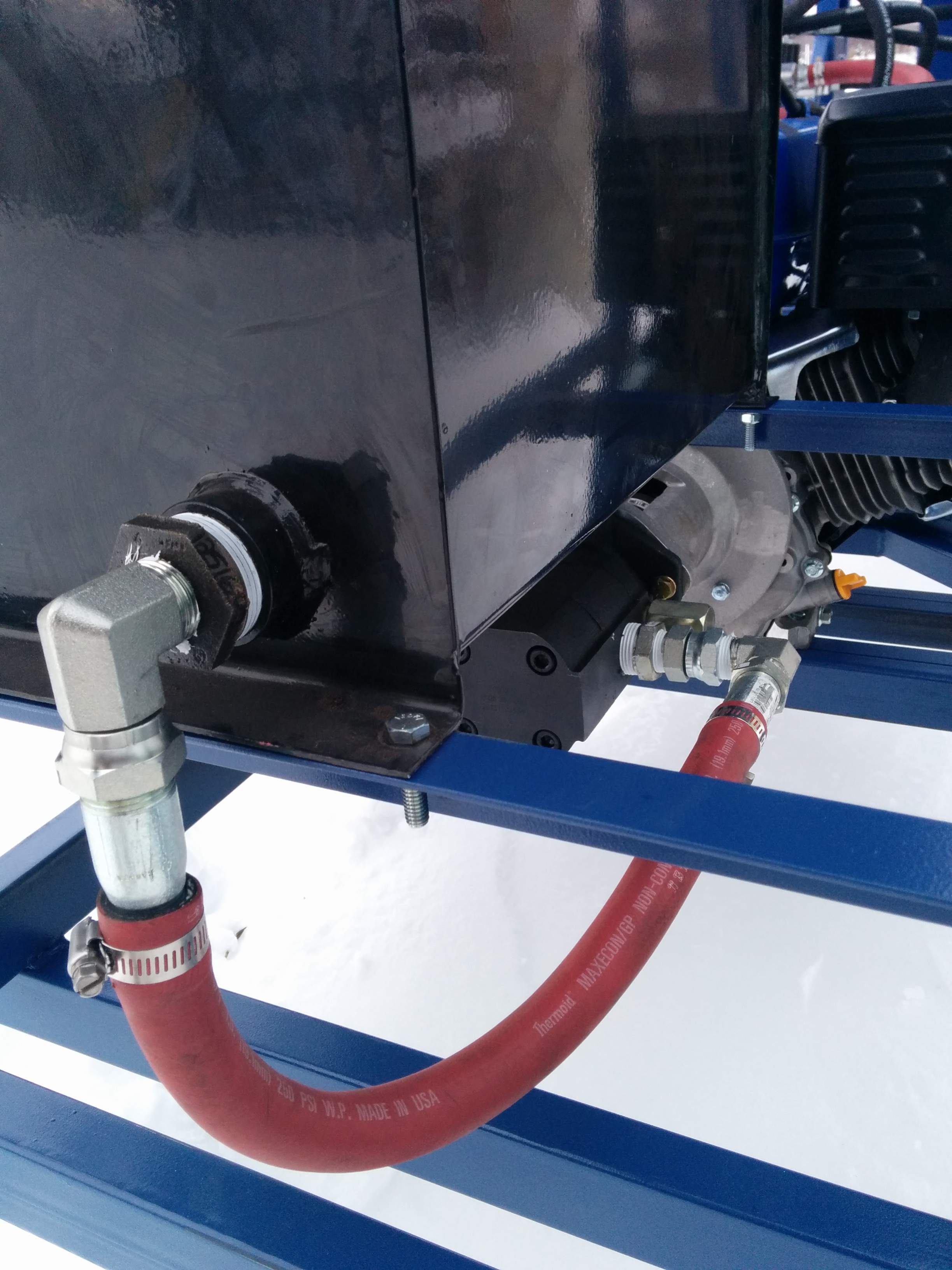

THE GOOD
before/after
View attachment 407503View attachment 407504

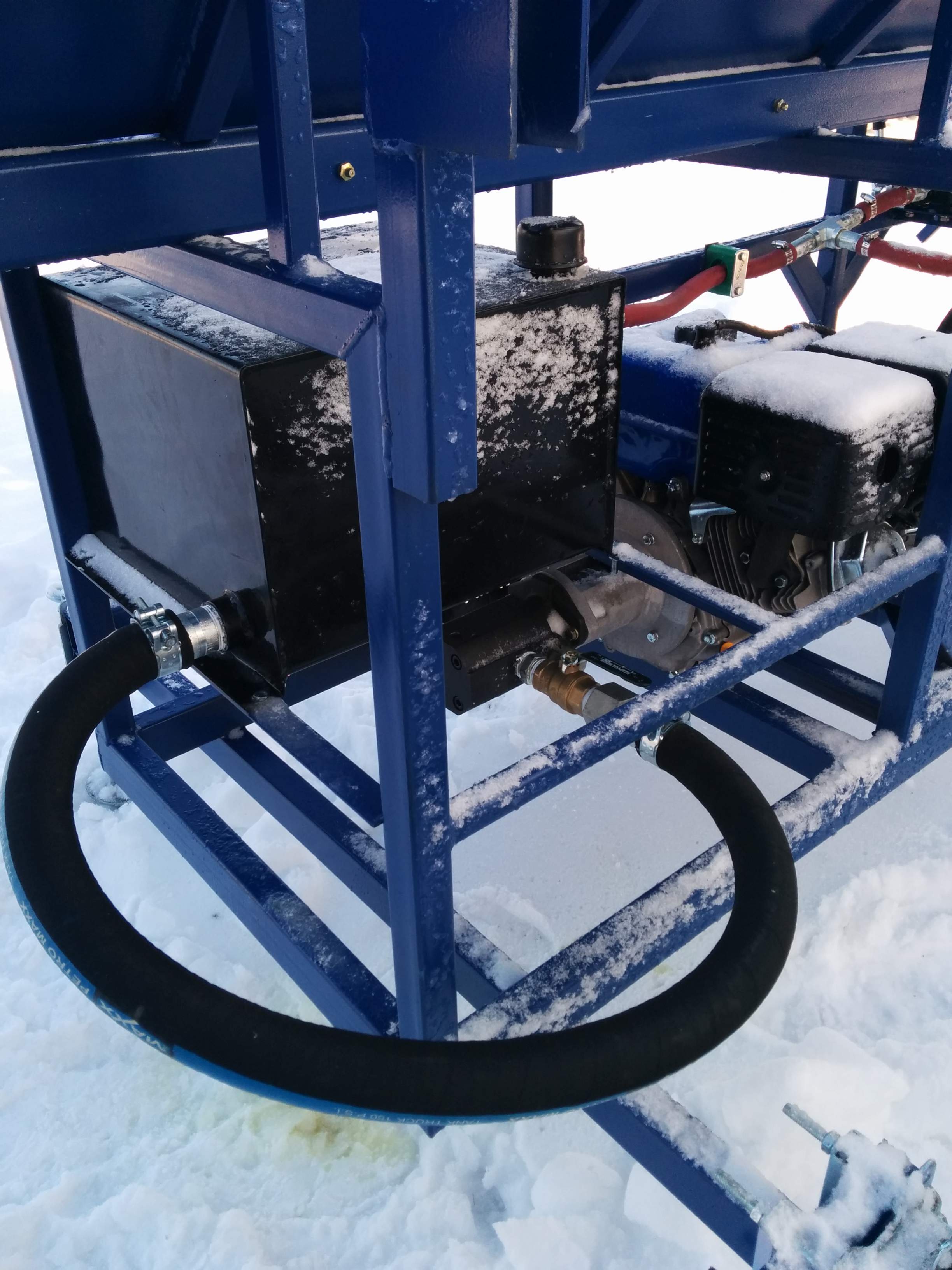

PA reduced the hose to 3/4", not really suction hose. It's now 1 1/2" Parker suction hose. Hydraulic shop says they would have used 1" return, but it should work.
I vote for the new larger hydraulic tank.
I would also change the return to 1'' as the Hydraulic Shop said. The smaller return line could add to the friction -- (more heat for the hydraulic oil and slower cycle time).
I agree with changing the lines to 1", and it may eventually happen, but for now, I'm going to go with more oil and see what happens. I just don't want to buy all new fittings throwing yet more money out the window for the old fittings. If more oil doesn't fix it and I'm forced to add a rad/fan, the lines will be changed as well.
If you have both tanks vented (I would vent the first into the 2nd, then the 2nd to air) and enough flow through the equalizing hose (might need 1.5"), 2 tanks can work quite well.
Aaron Z
So, I'm going back on buying the tank (so unlike me to flip flop :laughing:). I was looking at the price of the 25 gallon tank when I figured I'd only save $100, it's more like $200 for the 37 gallon tank. The big reason though is to be able to use both tanks as mikefromnh suggested. From the 2" supply port on the 10 gallon tank, I'll move up to a 3" solid pipe and make a 3" supply port on my custom tank. My design (that saves about $200) also includes a 5" clean out port and internal tank filter and magnetic drain port, which is not part of the tank I'd be buying. I'm going back and forth on putting the clean out port and internal filter in, so I may end up saving a little more.
Might want to use a union (or something) between the tanks if you can find one so that you can separate them down the road if needed?
What do you mean by internal tank filter? Do you mean a filter attached to the return line inside the tank, or a suction strainer?
On the other hand, if you are building the tank yourself, why not make one tank that is big enough to not need the existing one?

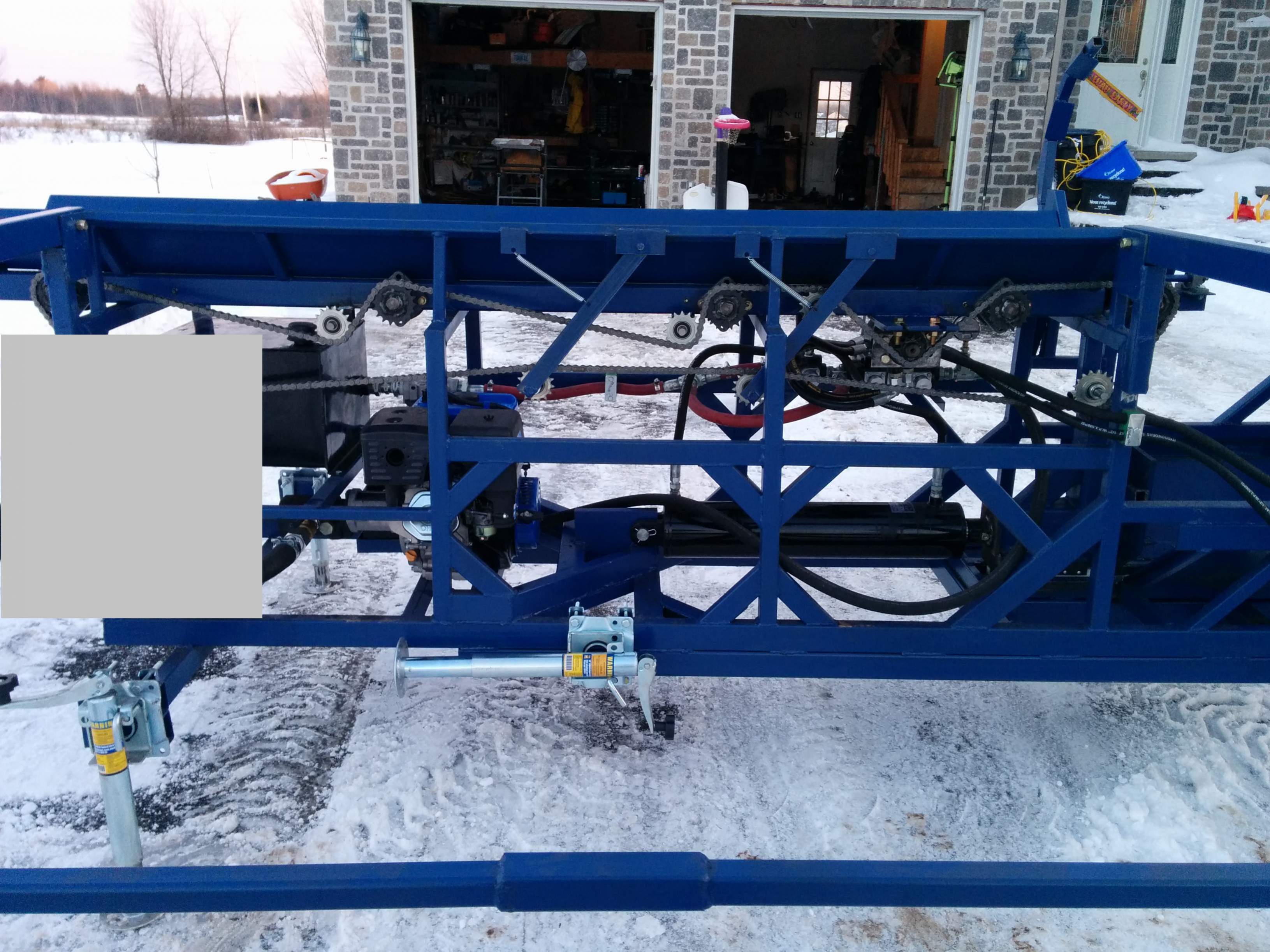

Well, you can see from the picture, I don't have enough room to built a large tank in the current space without running into the pump. My new tank will hang on the side of the frame so I'll either just remove the existing tank and have a space there, or keep it in place.
Yes, I'm talking about a suction strainer. I would have a union to disconnect the tanks. This will also make it easier to install them in the first place, I won't have to spin on my new tank, getting it just right to be able to bolt in into place.

I'm planning on getting organized this week to build the tank and conveyor next week. I've already started gathering supplies and racking up more bills :eek: I picked up 30 gallons of hydraulic fluid this weekend along with a tank level/temp gauge, vented cap and weld on flanges. Unfortunately, the largest flange they had was 2" so I bought on of those for the inlet of the new tank and a 1.5" for the new outlet port. The existing small tank only has a 1.5" outlet port, not a 2" like I thought so anything bigger than 2" probably wouldn't make much difference anyway.
I also picked up a bunch of parts for the conveyor system. I designed a system that used regular chain with two tapered (think wheel barrow) wheels pushed togther at each end to drive it. I couldn't find a reasonable price on large roller or flat chain, so I thought that could work. When I got to PA, they had thick garage floor rubber48" wide runner on sale. I figure I can rip it into 16" wide strips and link it as one large belt. I'll add several pieces of angle iron to help move the wood and they will also help secure the pieces together. I asked for 8' of it, he cut about 10' so I have lots to play with. I think this will work and at $7.99/ft, it's a lot cheaper.
Since I still have lots of snow on the lawn except where I plowed roads (down to the grass), it's going to be a while before I can start using the tractor again without destroying my lawn. That's why I haven't been in a huge rush to finish the tank but it's time to get it done so I'm ready to go when the ground dries out enough.
