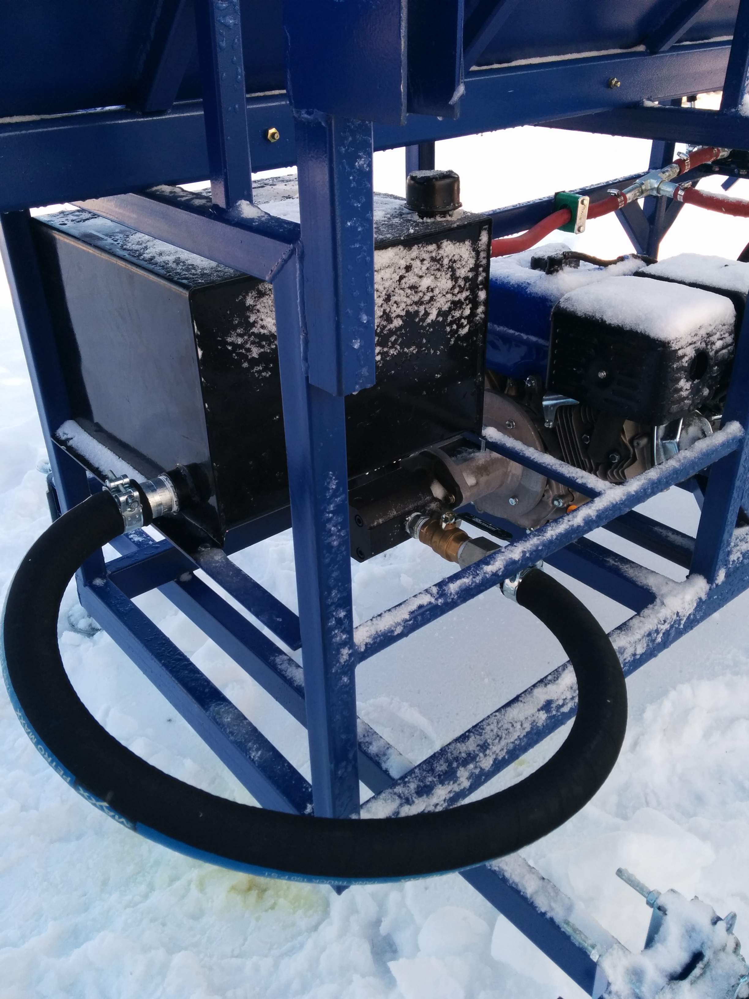

I wouldn't worry about the 1/2" power beyond port. A single 1/2" fitting won't reduce your cycle time... Just creates a bit more friction/heat. The valves CV rating or pressure drop takes into account fitting sizes.
Flow coefficient - Wikipedia, the free encyclopedia
The ten gallon tanks does seem small. If things get too hot it might be more cost effective to add a oil cooler instead of a bigger tank and more fluid.
I heard back from the hydraulic shop and they're telling me the radiator required to handle the amount of heat I'm generating (I told them the pump size, tank size, engine size and they somehow came up with a number) would cost $2700. Now, it's an expensive place to go shopping for sure, but even the rad from Princess Auto is almost $400 and I have no idea if it can handle the heat load I'd put on it. I'm not able to find other options for oil coolers, the surplus center doesn't seem to have them and none of the others I find on line seem like they're going to work. I think the easiest thing to do it just add a bigger tank.

I guess that's another $200 in oil to go from 10 gallon to 30 gallon tank, isshh, it never ends. I'm not convinced my little 15 hp produces enough power to run a 12v fan and I'm only using a lawn tractor battery. I could change that for a deep cycle battery, but I still think it would just get run down. I have no idea how many amps the engine is putting out, but I'm betting it's not much. The site you posted has a 115v option, but it's back to the $900 range. I need to think this through a little more.
/ Firewood processor build thread #366
You could put the fan on a snap switch so it's only running when the fluid gets hot. Painting your tank and cylinders white will also help a little bit if they are in direct sunlight.
The bigger tank is probably the best solution...
/ Firewood processor build thread #367
If you have 115v available you could always hook up a battery changer while running the processor.
I agree that the charging system on a little engine would probably not keep up with the fan. We are hoping that our 2 engines would be able to keep up with it if we decide to go with the cooler.
And judging from what you've experienced we will likely have to unless we want to have 40 or 50 gal of fluid.

The old rule of thumb was to size the tank approx 3x the average flow. Considering that your processor is not going to run all the time (ie: commercial) you could probably get away with approx 40gal vs. the 50 via the rule of thumb calculation. No matter how you slice it, 10gal is way on the small side. Its going to require quite a cooling system to work with a 10gal reservoir, and likely explains the high cost quote from the local hyd shop. Cheapest option would be going to a considerably larger tank and adding oil and maybe a cheaper ebay cooler to help drop temps if needed at a later time.

Interesting ideas about rads but at this point, I'm going to try and avoid using one. Having started this project without any experience with hydraulics, I trusted what I was told when I bought all the parts. I shake my head now because some of the issues I've had seem so obvious now, including the tank size, but at the time, I didn't think twice about what I was told. The tank size is just wrong, plain and simple. Exactly how big is should be is up to some debate since the machine is using hydraulics intermittently and it's a two stage pump but no matter how you slice it, everything I've read says it's way to small. So I'm going to start by changing the tank and hopefully that will allow me to avoid having to add any type of rad.
So, I'm almost 100% decided at this point to buy the tank I posted a link to earlier. It's 37 gallon capacity with 30 gallon of usable fluid capacity. I priced out building my own tank and I'd save about $100 doing it, I'm just not sure in the end it's worth the time I'd spend doing it. It also doesn't include any consumables for welding/cleaning or paint, so in the end how much would I really save?
/ Firewood processor build thread #377
I think you'll be much happier with that tank, I agree with the sizing. Everything I've found says tank size should be equal to pump capacity or greater.
At some point, there should be enough fluid capacity that a cooler is unnecessary. I'd double check on the sizing that there is no doubt it will be enough. I'd hate to see you see you still have to add a cooler later with all you've been thru
