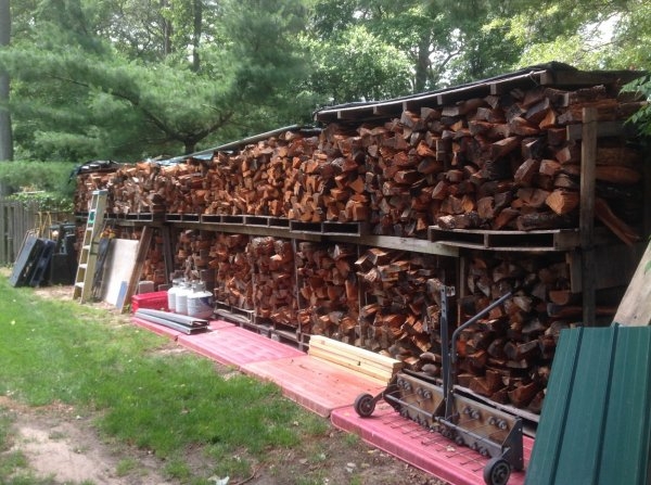

Pallets rot quickly here. I made these with 2x4's and they have held up well after 14 years..
BX quick attach and Pallet forks from AI2
But the BX with clamp-on forks won't lift one if the wood is not dry. It was always a bit unstable anyway. I now use them with carryall style forks on the 3-point.

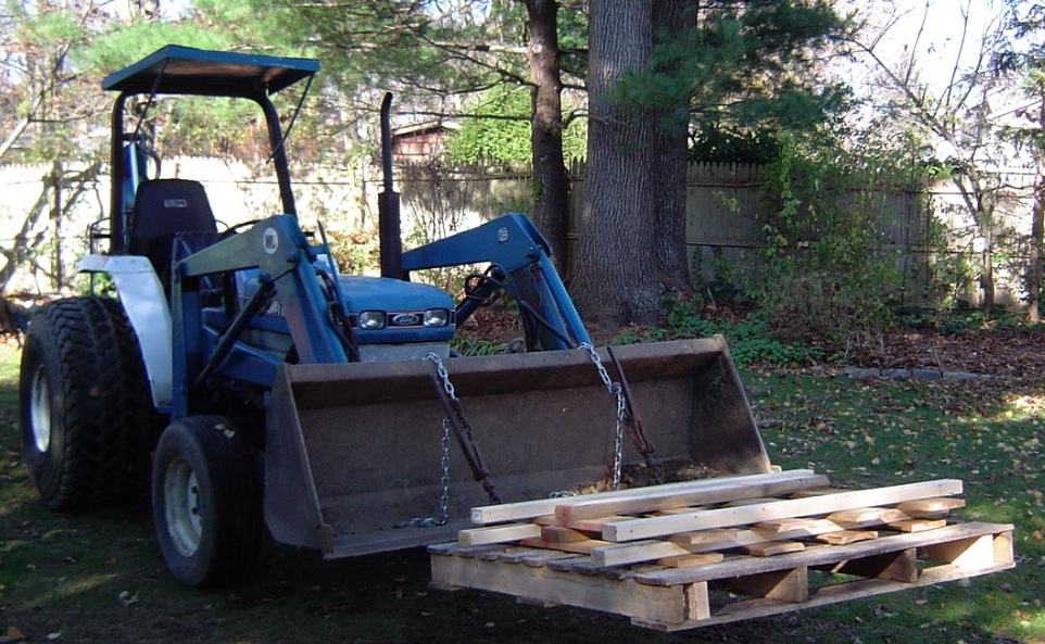

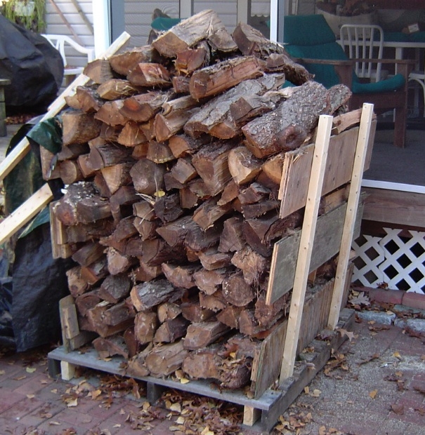

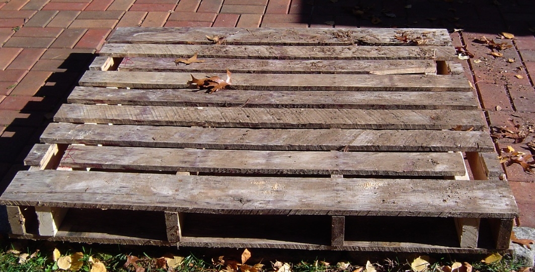

Might have been me...
I was looking at what others on the forum were doing with firewood and did not see any racks made this way. The stone quarries use a similar setup, although it's smaller to handle large flat stone. I thought I'd modify it for firewood. Just add a couple of 2x4's to a standard pallet. Cut some slots for uprights and you're done. I figure each pallet holds a little less than 1/4 cord of wood. They come apart for storage and are mostly free.
Thought someone else might use them too!
Mike

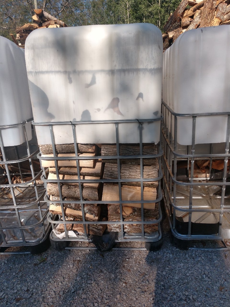

Try ICB totes? The plastic tank is cut diagonally and holes drilled at the ends to accept wire ties to allow it to be fastened on top to shed the snow. I cut a notch on one end (other side of this pic) to allow me to reach in easier.

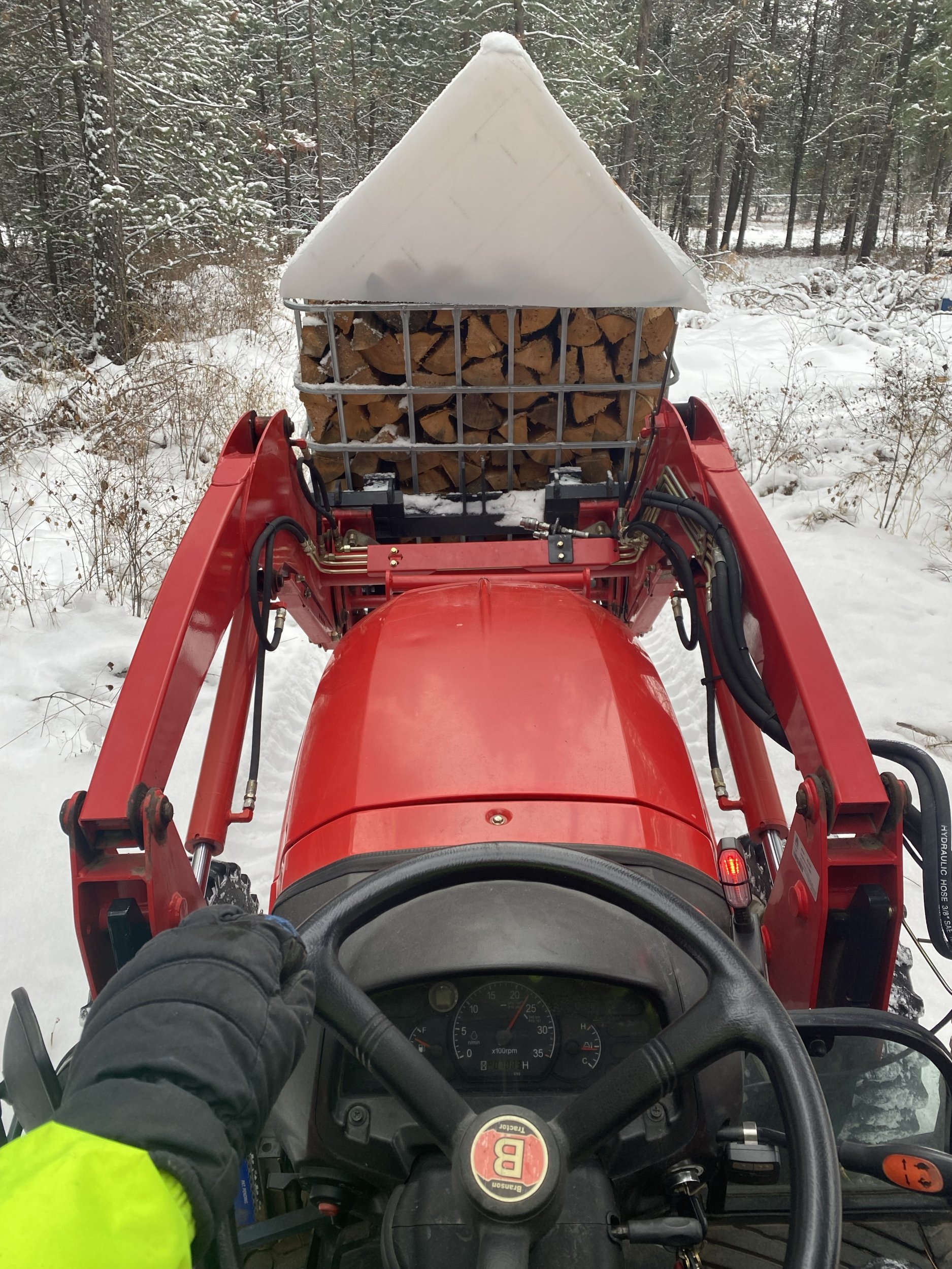

275 gallon IBC totes hold about 1/3 cord. It's about .38 cord by measuring the volume. 1/3 is close enough given that it depends on how you stack them. That's to the top of the cage. The ones in the 2515r Dude's pic that are higher than the cage are probably 1/2 cord or a little more.
My Branson can just pick up a 1/3 cord tote full of wet hardwood. A half cord might be too much. It's a ways from where I store firewood to the house so I bring up a single tote at a time with the tractor.
