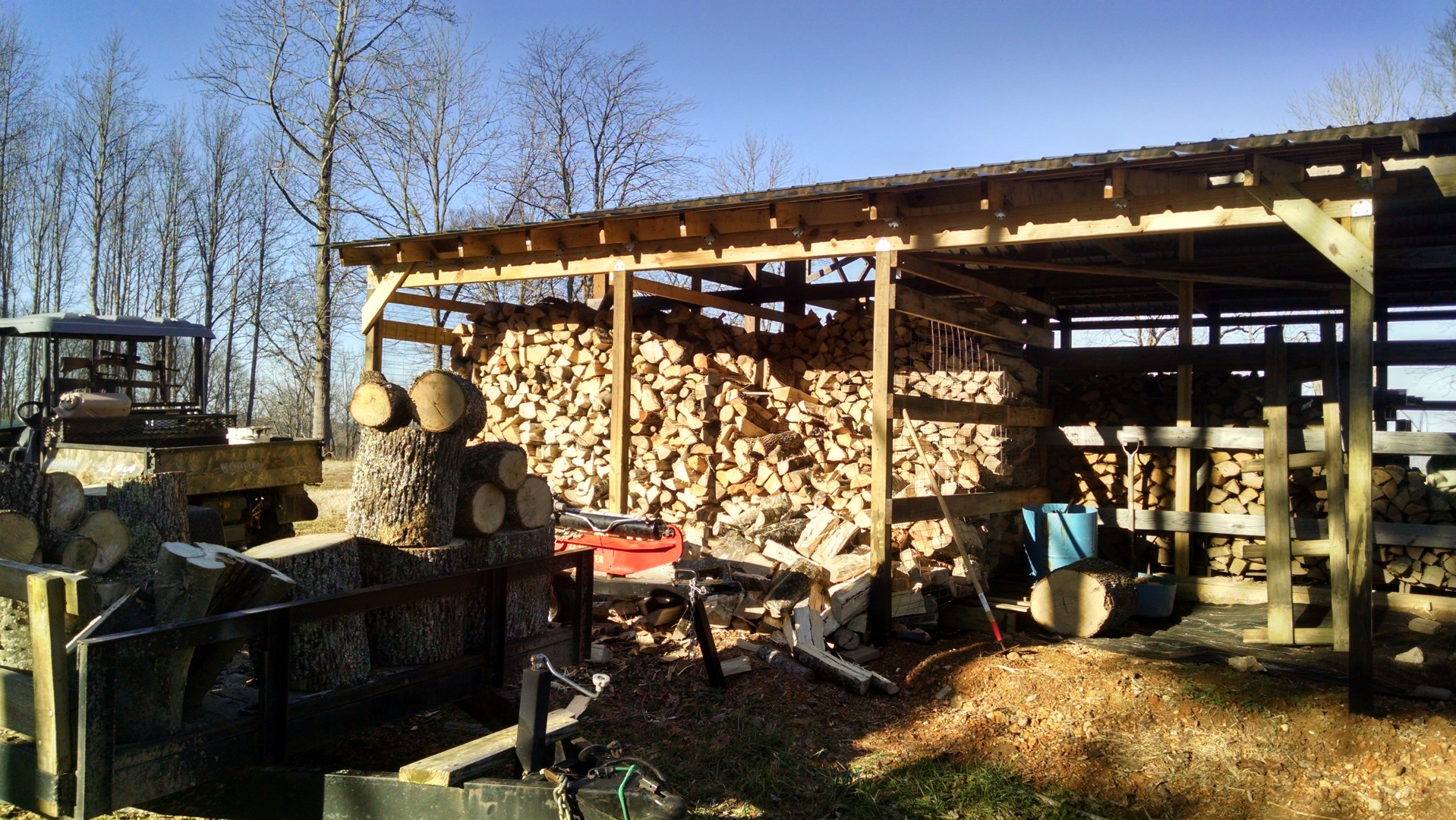

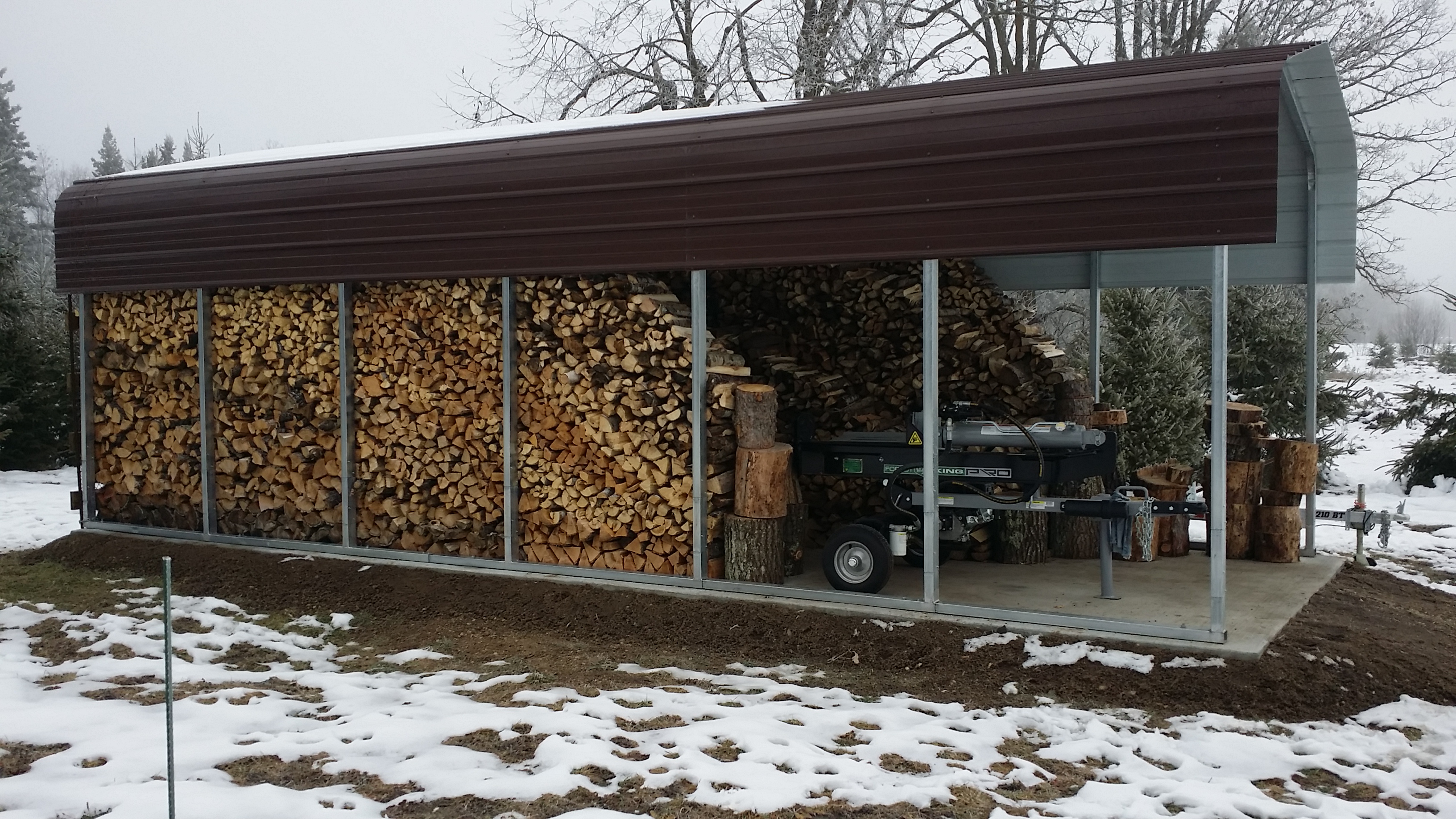

This is my wood shed (built about 2 years ago). It holds about 18 cords with room to spare for storing the tractor, rotary cutter and ATV trailer. Only 2 out of the 4 'bays' are fully loaded. The other 2 bays just have log 'walls'.
/ Fire wood storage building? #24
Looks nice, I like the overall design of it. I need to get going on something like this for my self. I dont burn wood for heat, but I always like to have it on hand and a nice looking shed like this makes a couple stacks of wood, look nicer as well as keep it dry.

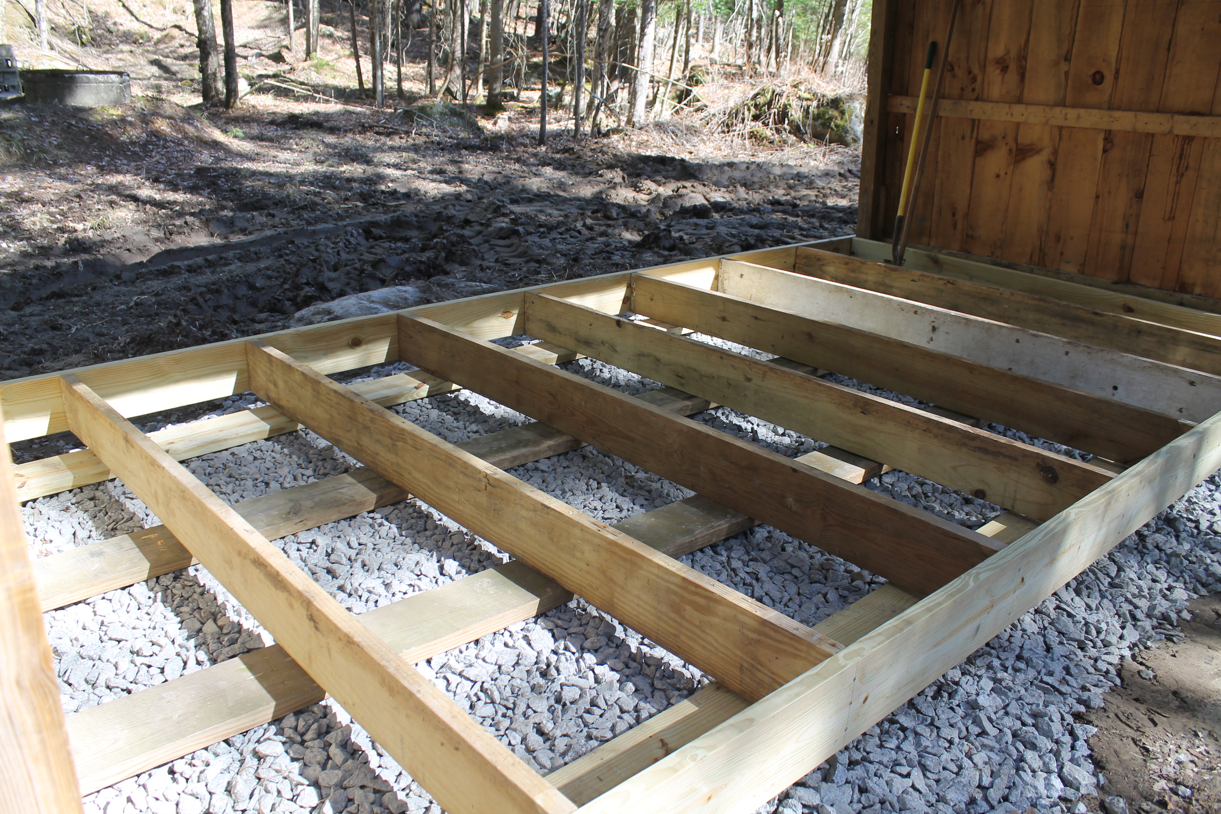

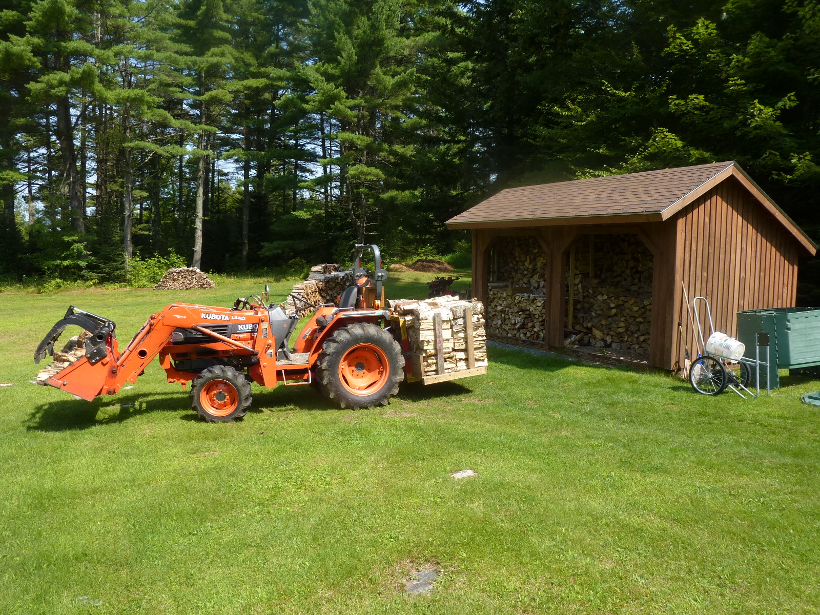

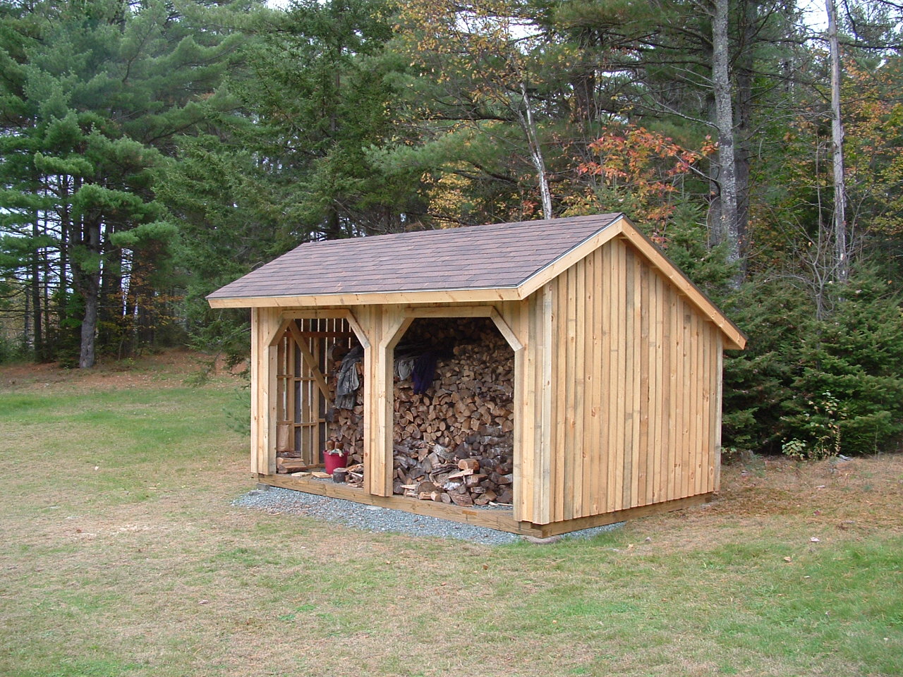

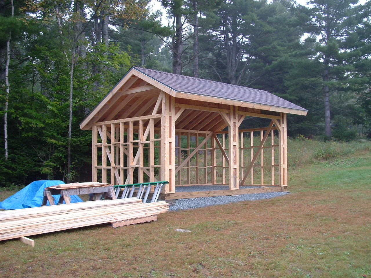

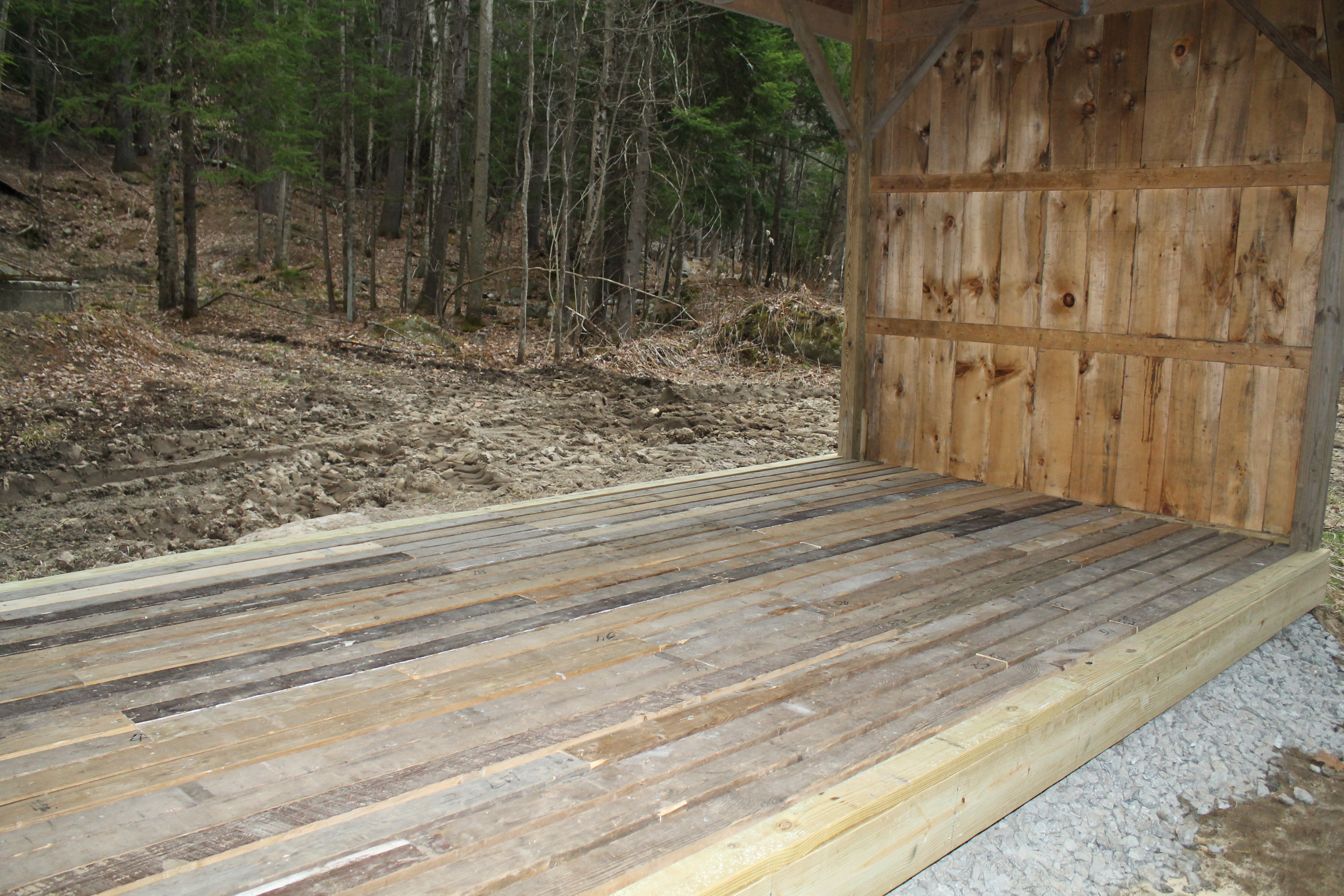

The base on my wood shed was an experiment. I wanted something simple but we have a lot of frost up here and the ground really moves and buckles in the winter. I picked an undisturbed spot and made a 10' X 16' base frame from 6x6 PT. Then I leveled it up with flat stones where needed. Once it was level I filled it with 3/4" crushed rock. It has been there now for 12 years and to my surprise it is still straight as an arrow. Holds 8 cord. Two years worth for us.
Built in 2005
Two years ago in 2015
gg
/ Fire wood storage building? #29
Gordon - that is exactly what I would like to build. Good looking structure. Well done.

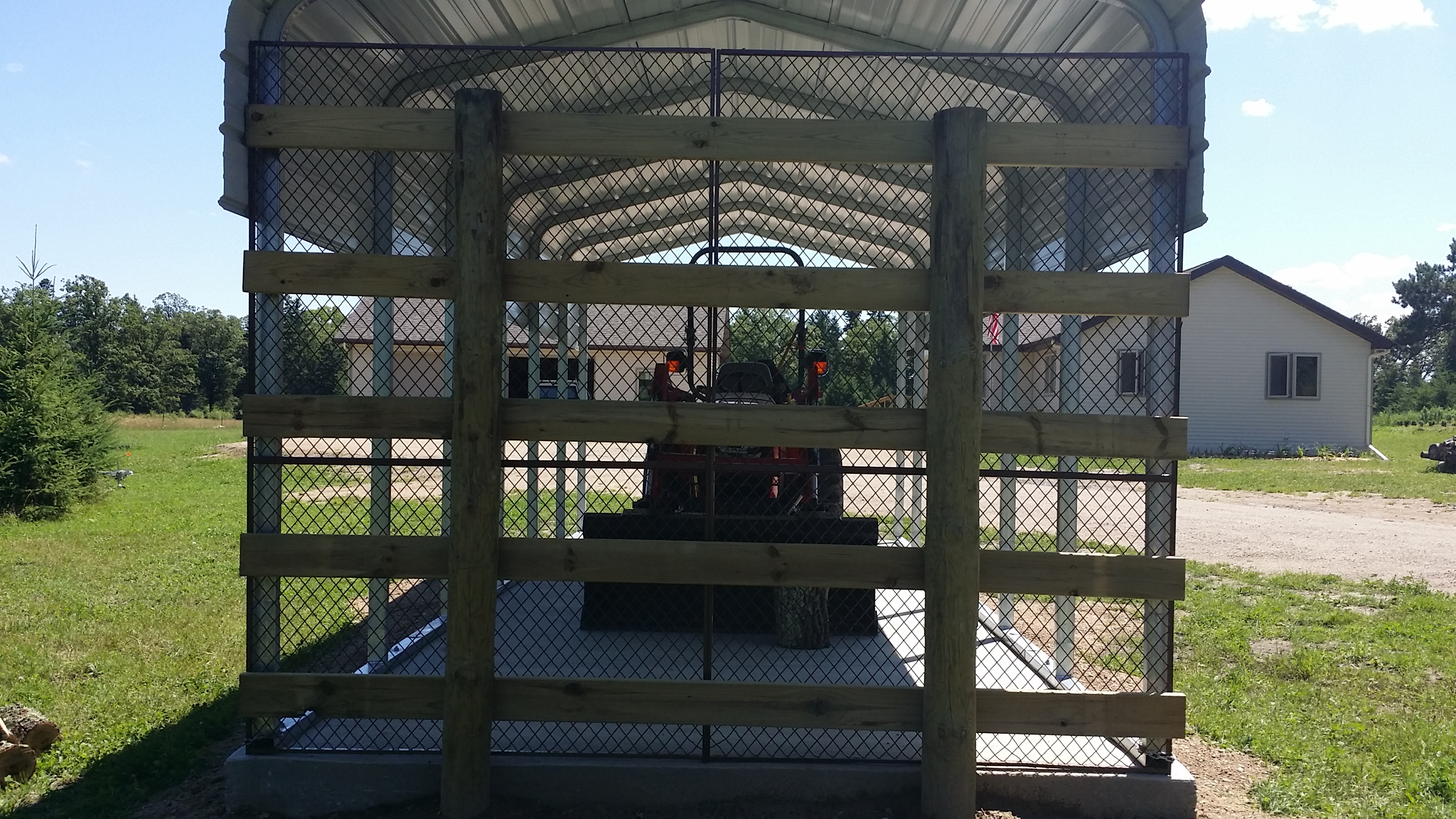

My wife and I put this wood shed up this past summer. It is a VersaTube structure sitting on a concrete slab per their specs, roughly 30' x 10' and 9+ feet tall. Tall enough to drive the tractor under with the ROPS up. We have a new house in northern Minnesota. We burned 1 1/2 cords this winter to heat the house. I've got multiple years of wood in the shed with more waiting to get split and put in the shed.

I have a similar shed. After I laid out the floor framing, I filled it with gravel before I put down flooring. I get chipmunks etc taking shelter in the wood but the rock eliminates the snakes, mice, groundhogs, etc under the floor that would otherwise be there.

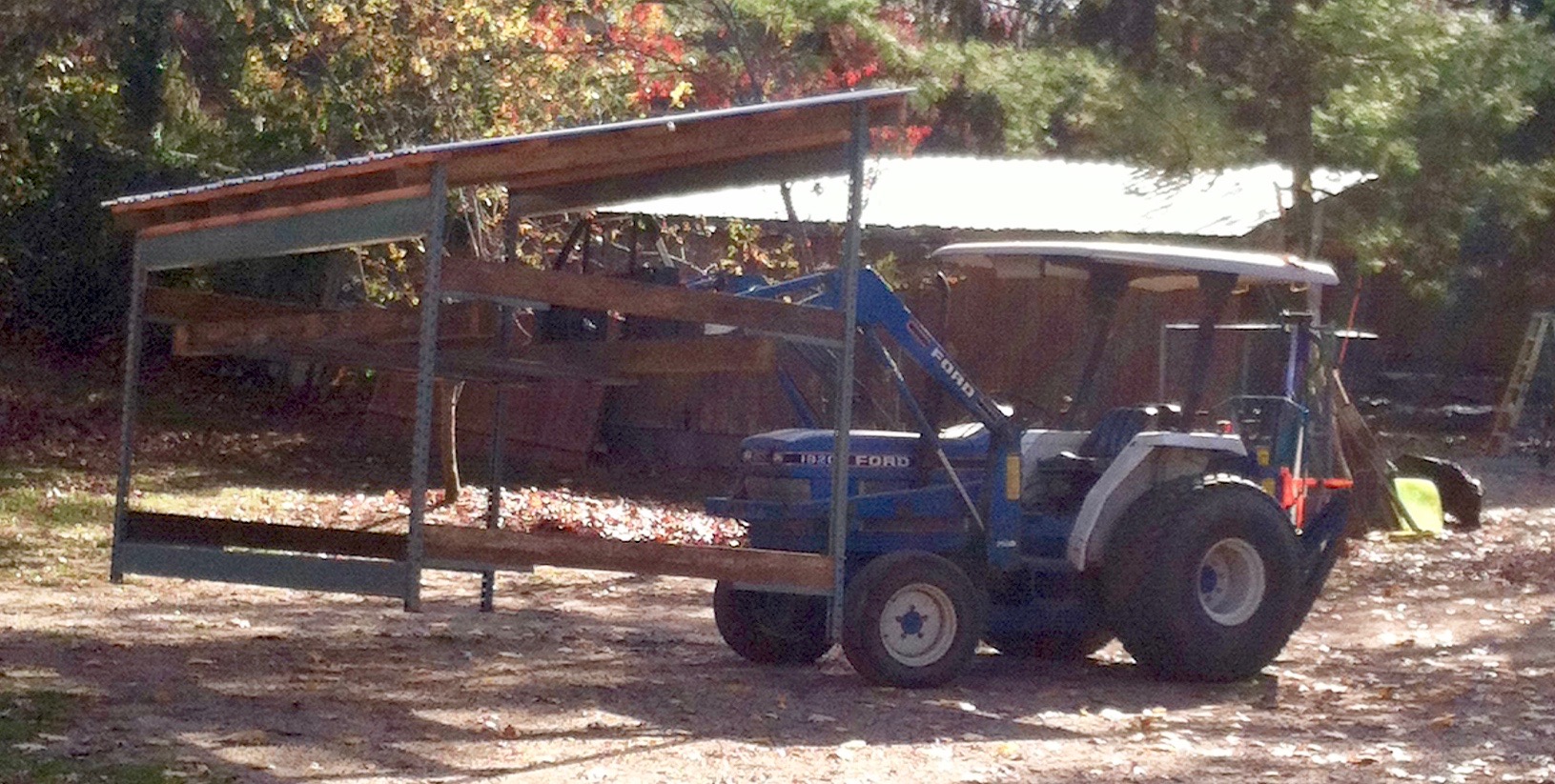

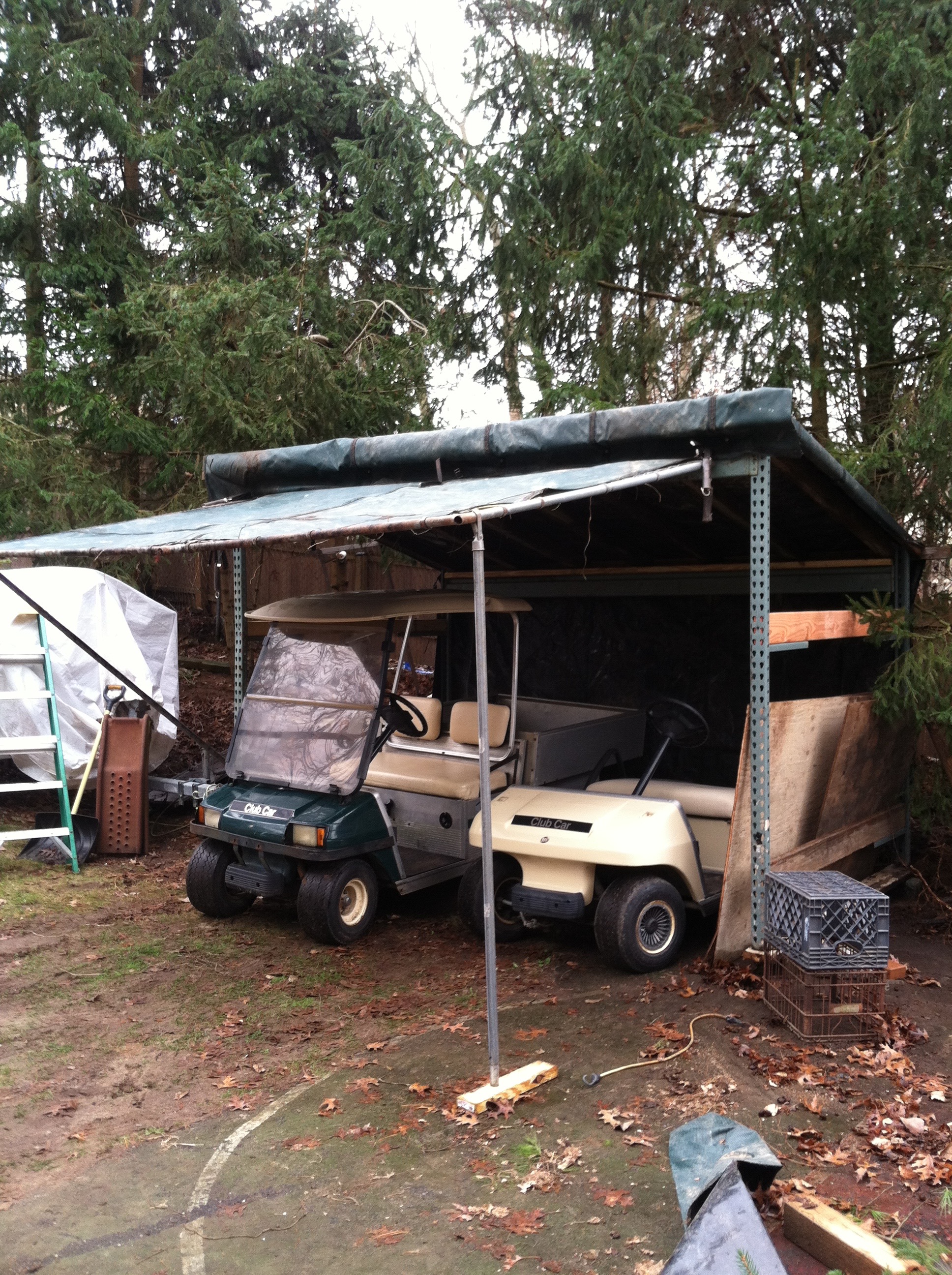

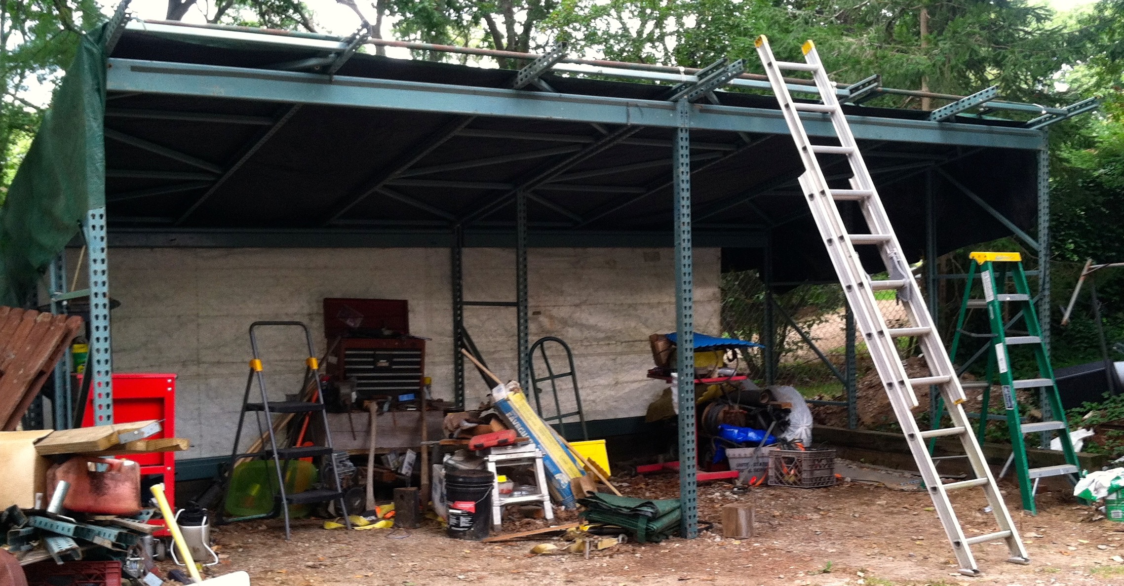

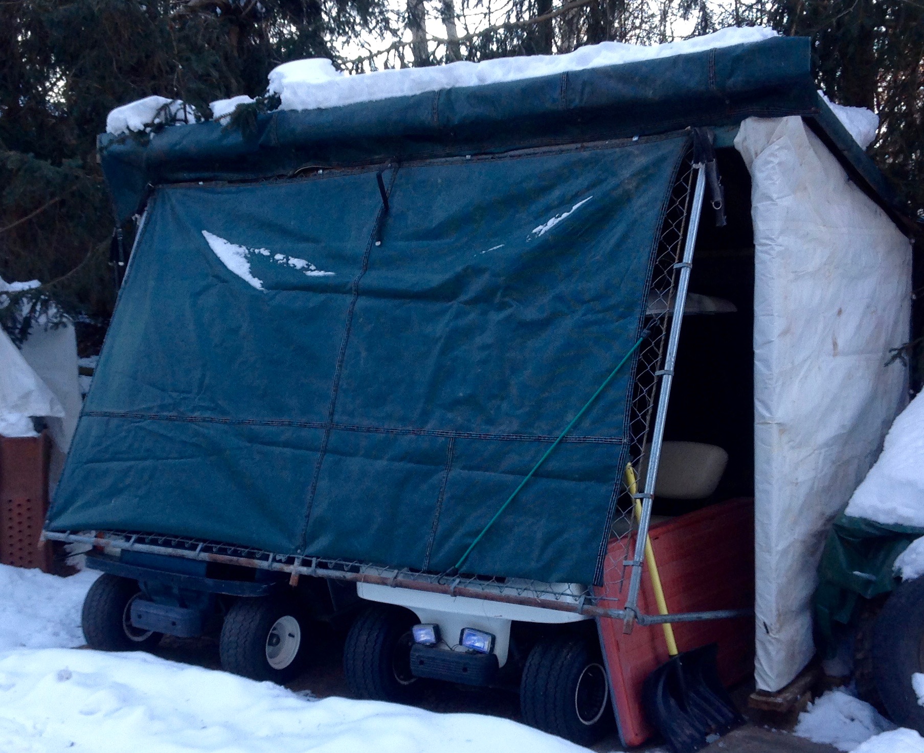

I have 4 wood sheds made from 8' tall sections of pallet rack. I the top end of one leg off about 16" down and when the rack is assembled I built a simple shed type roof with pole barn metal for a covering. Throw 2-48" x 48" pallets down on the beams and you have a rack that will hold around 1.7 cords up off the ground and sheltered from the rain. On the inside of the uprights I attached some old chain link fencing to keep the firewood from simply falling out the open spaces...works AWESOME!!

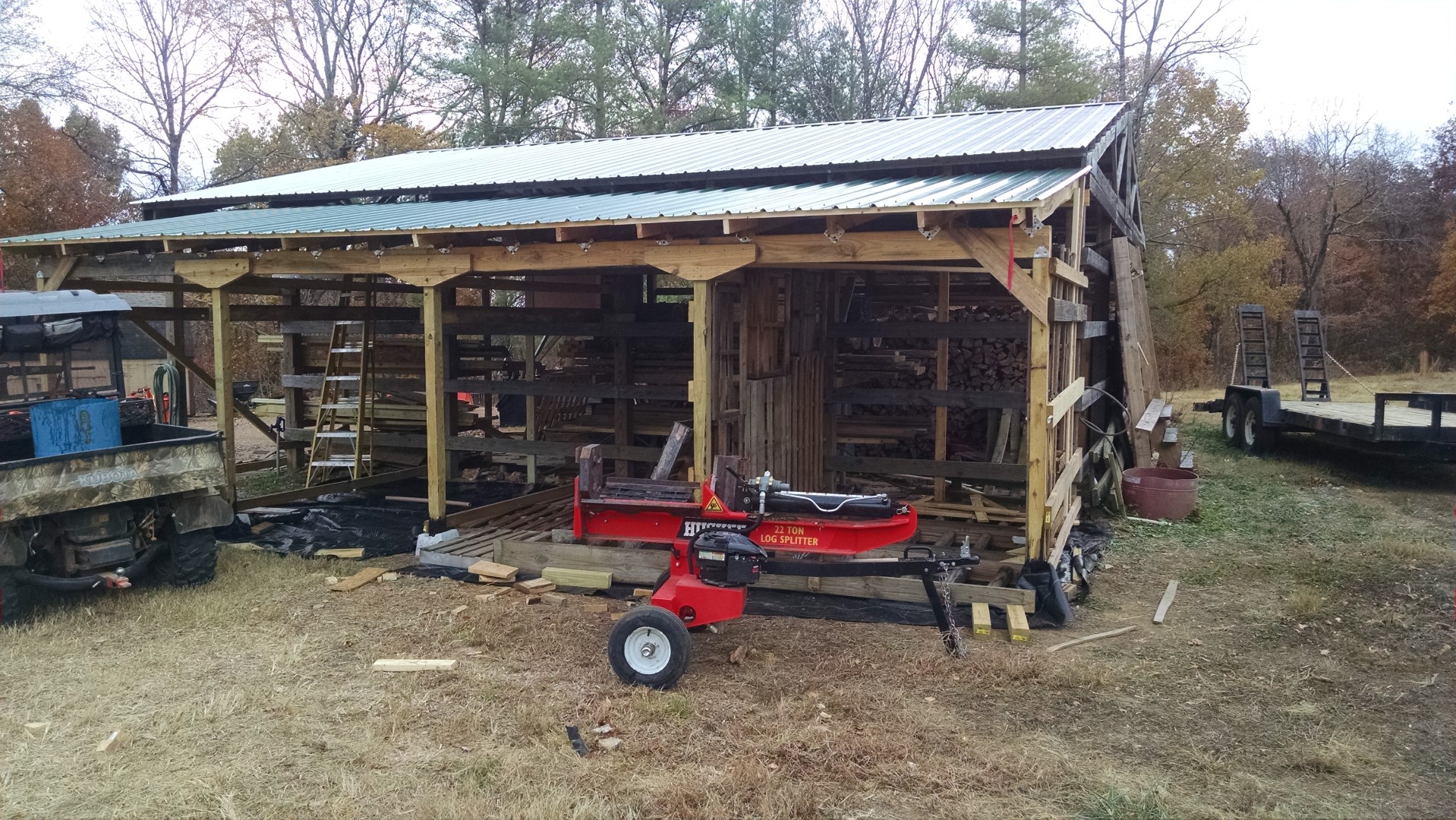

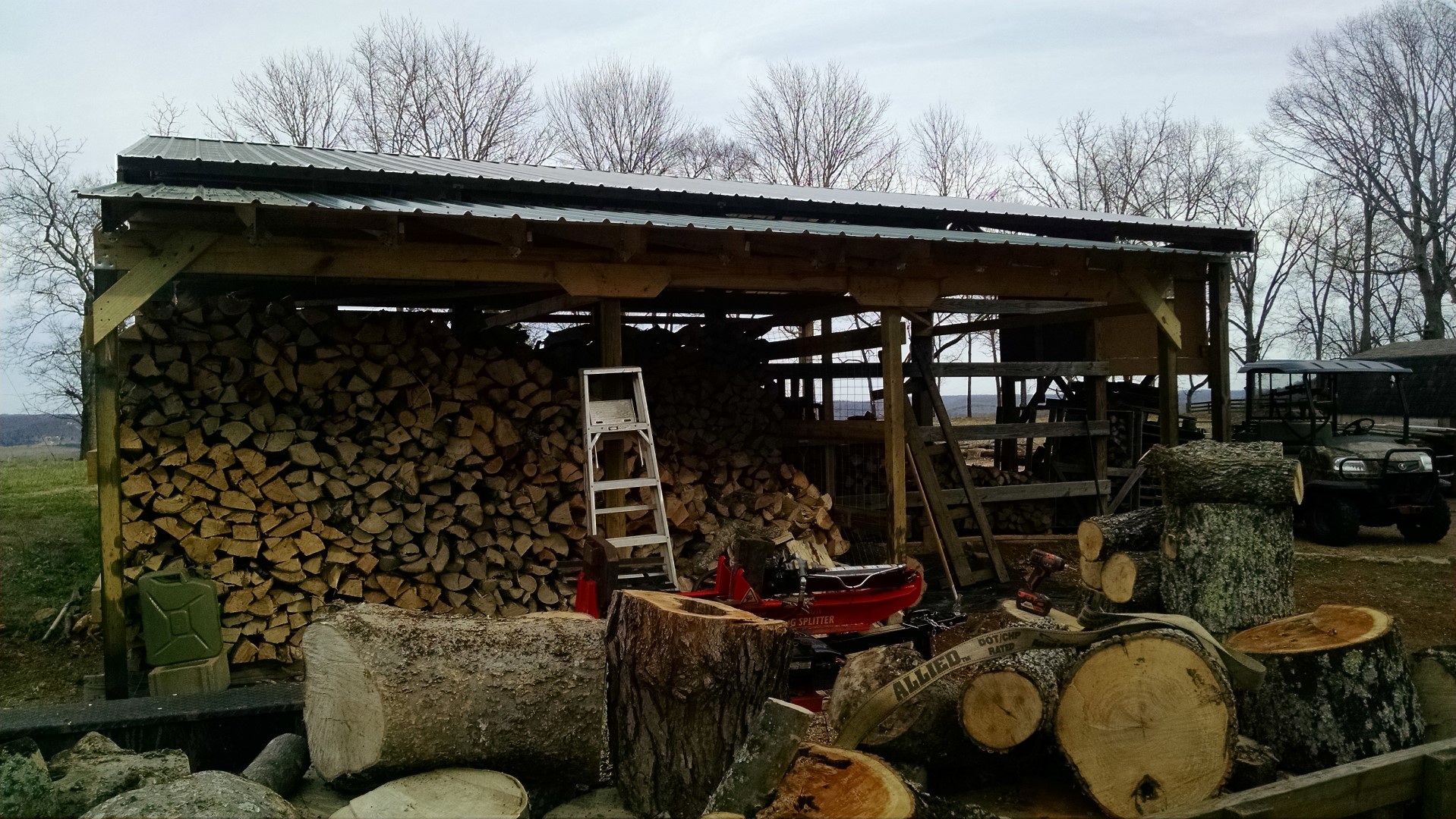

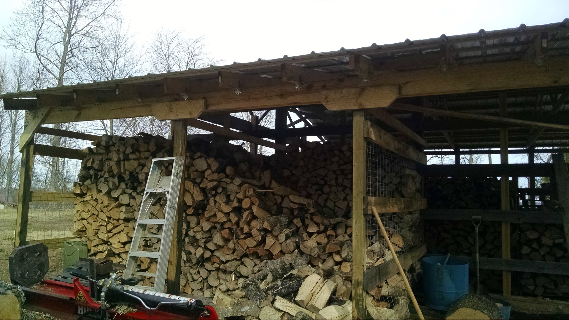

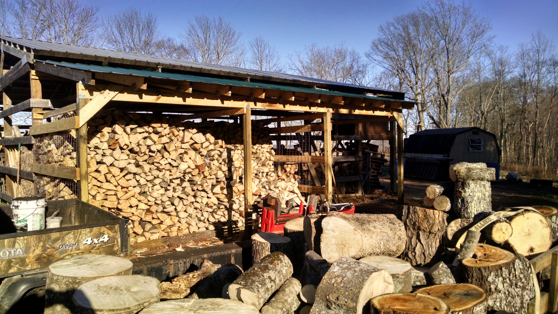

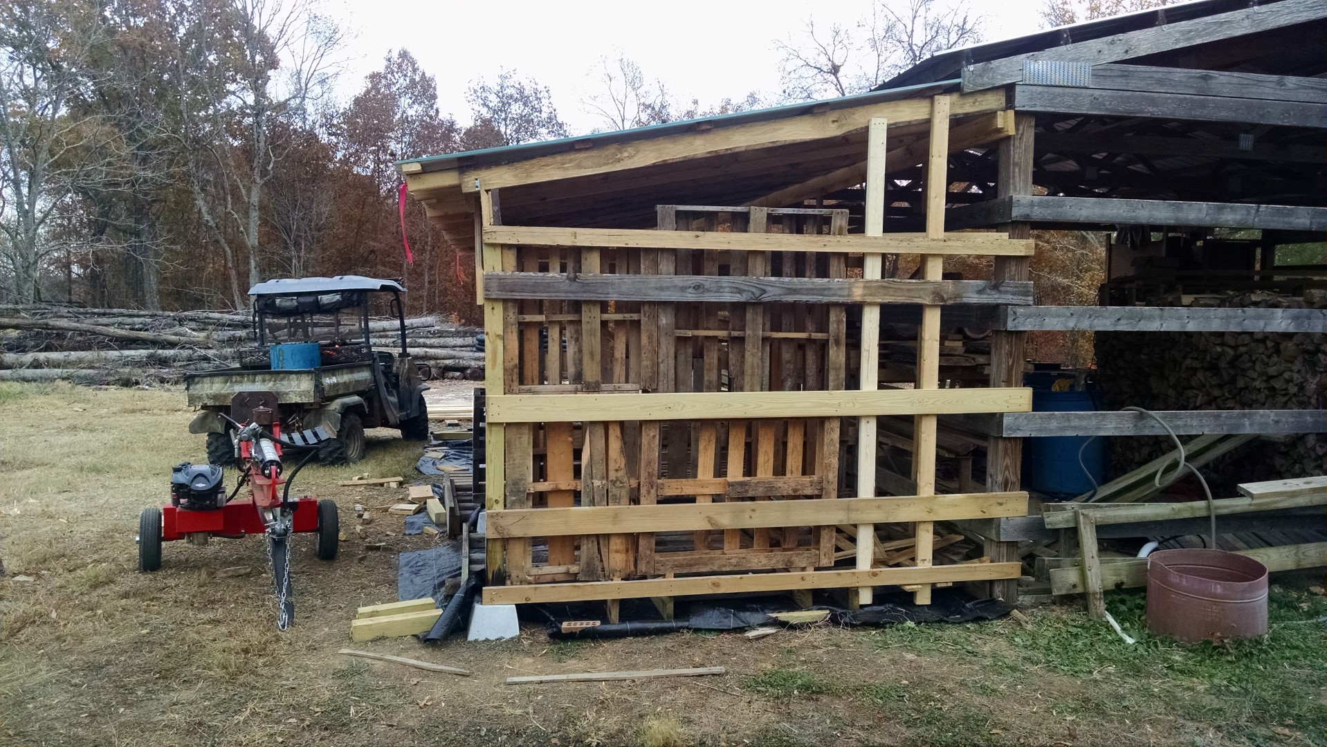

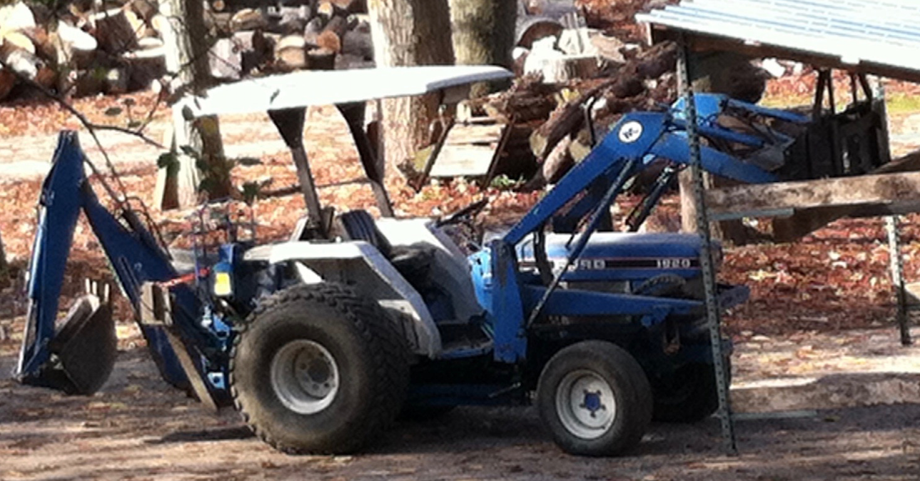

I have built several sheds from pallet racks. the one the tractor is lifting is 11' wide and 8' deep. If you look close- I cut the upright down the middle and reattached using treated 2x6 screwed to metal crossmembers. 6' high in back and 8' in front.
very easy to move around using 2 4x6's across forks and lifting
the other shed is around 10x22 with racks also ar roof supports. metal roof also

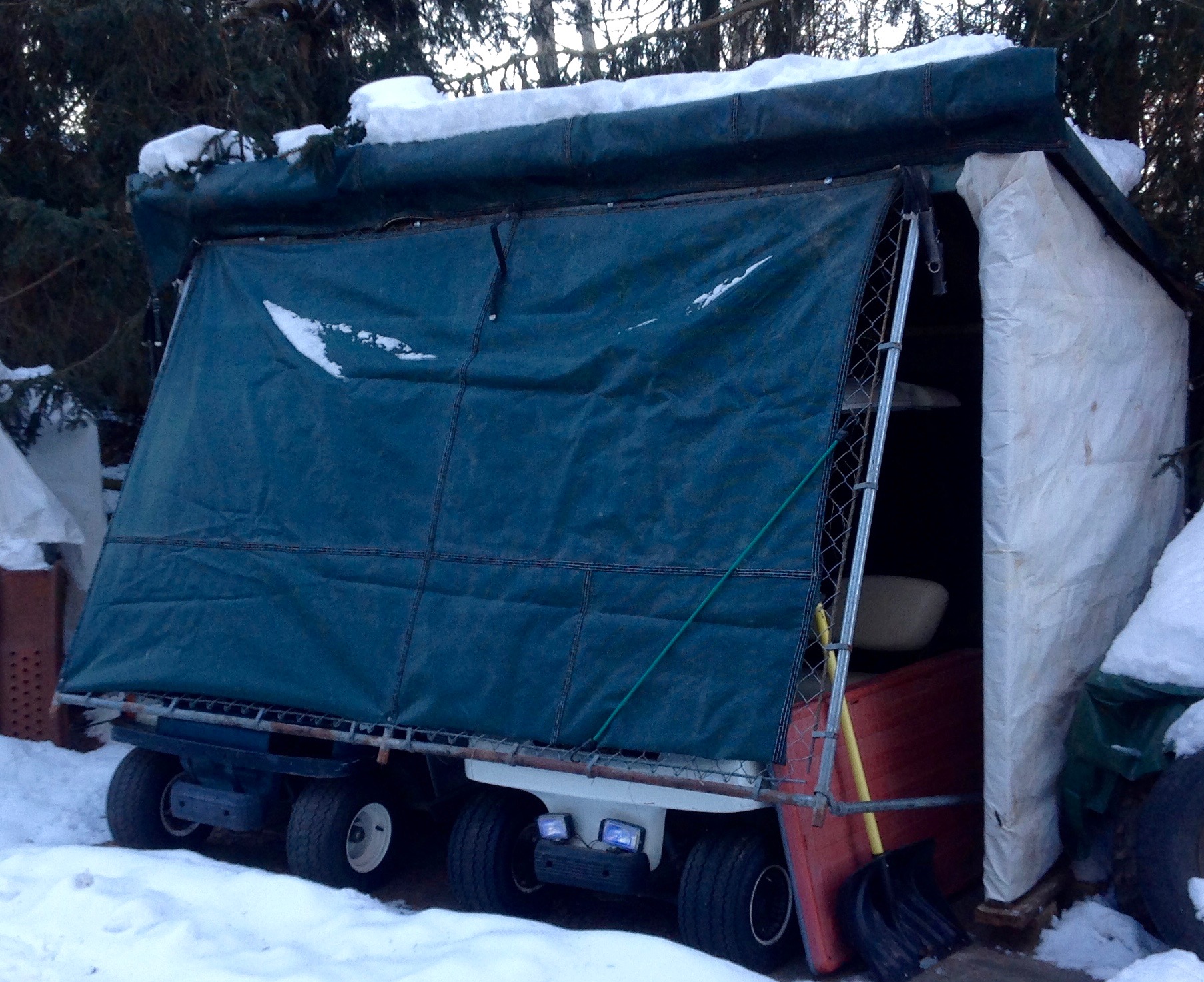

these I covered with tarp for winter and later metal
