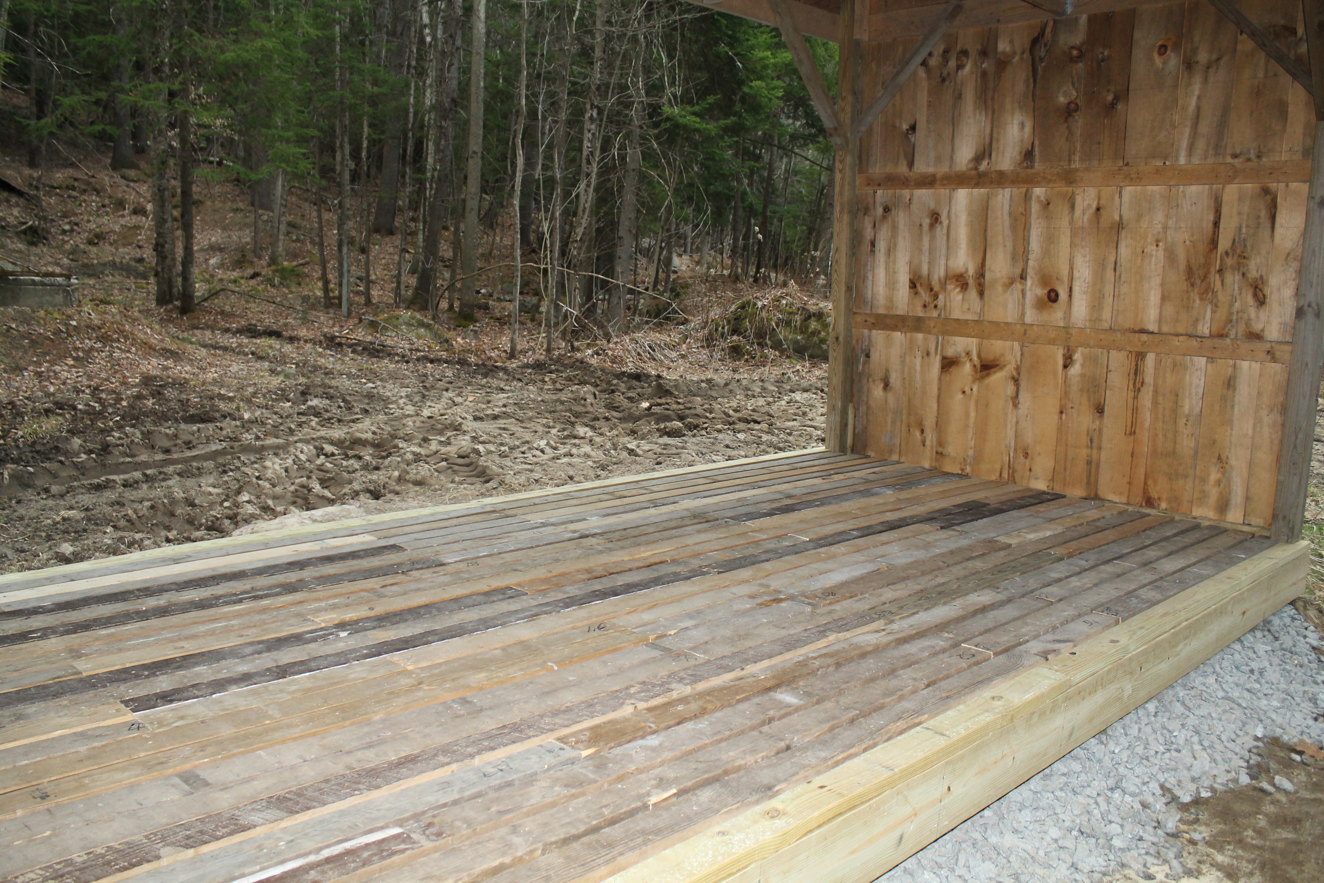

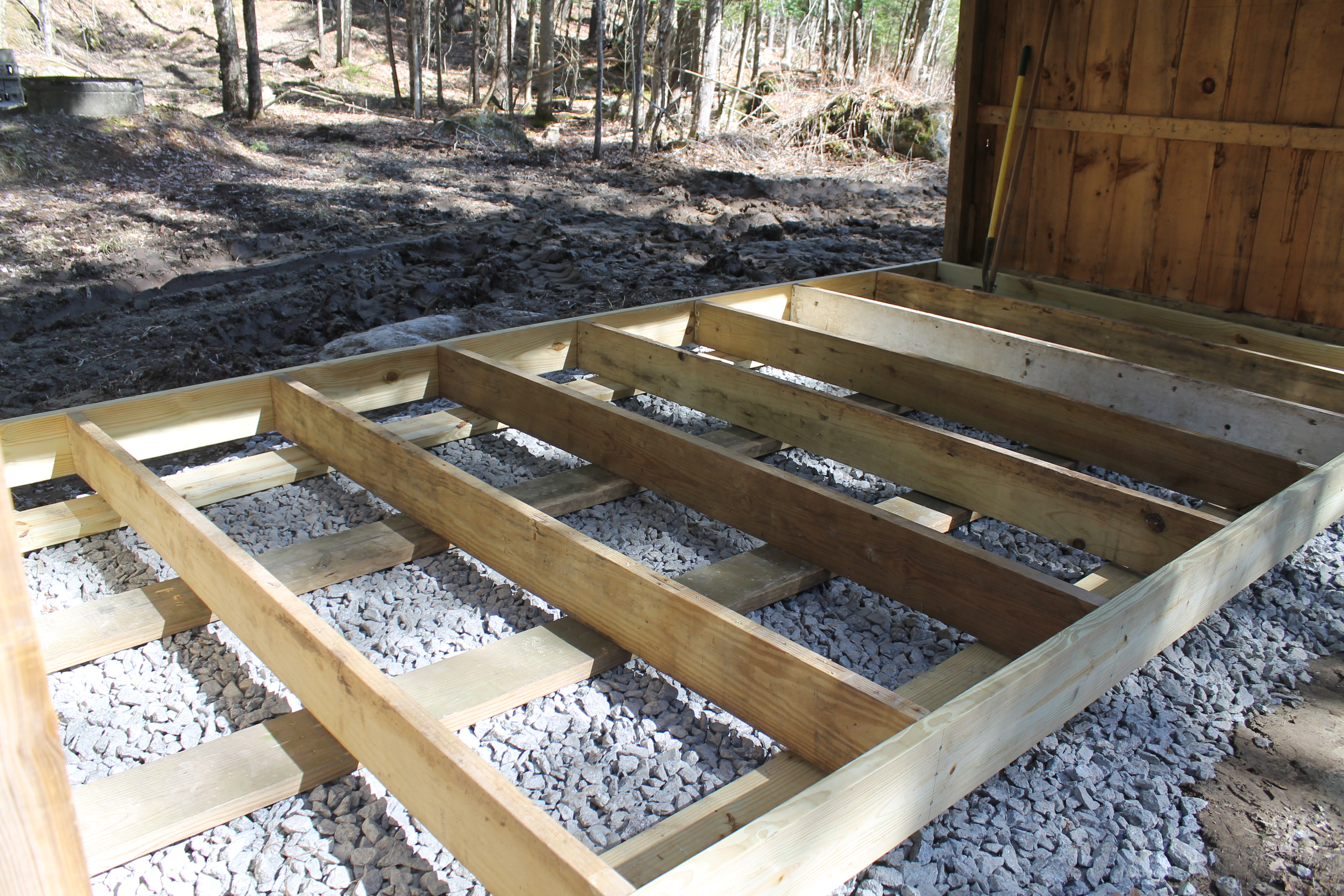

Here are a couple of pictures of the woodshed that I came up with. It has a floating deck on a crusher stone bed to eliminate the strain of 6 cords of green wood on the building frame.
