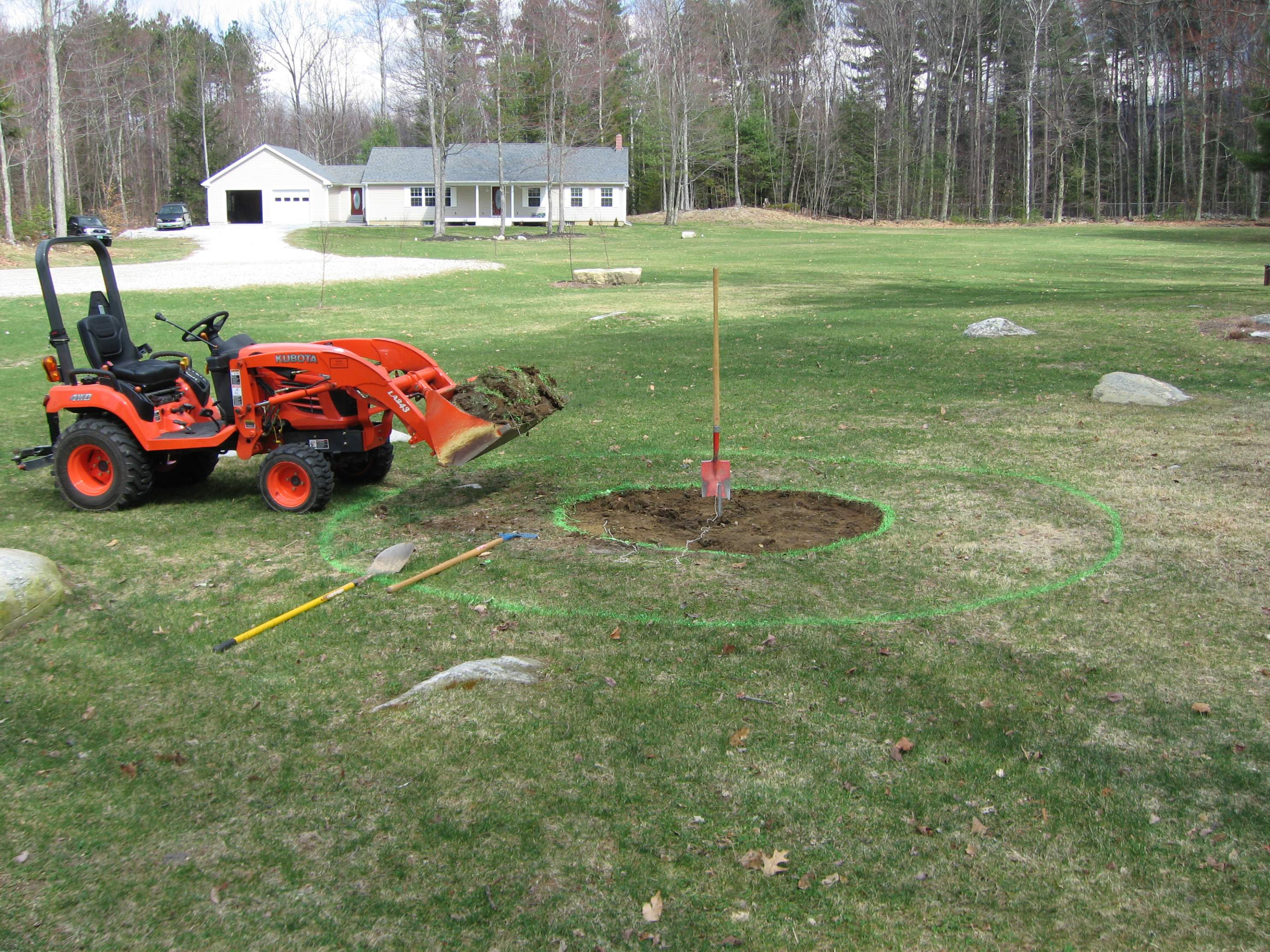

We bought a chimnea but it just wasn't big enough for having people over. We saw a rocksolid episode on DIY about firepits and that was that. And since my daughters boyfriend is a mason, who due to the economy is unemployed, we thought this is the perfect time. So here we go. Day one was layout and dig the hole. The rocksolid guys built one 5' in diameter but the boss said that was weenie so ours will be 6' outside diameter, foot thick walls and 4' inside. Great place to kick back and relax around the fire. The hole wasn't to bad but I did have 3 rocks that the had to have a little sledgehammer time. I need the exercise anyway. Hopefully day 2 is concrete.

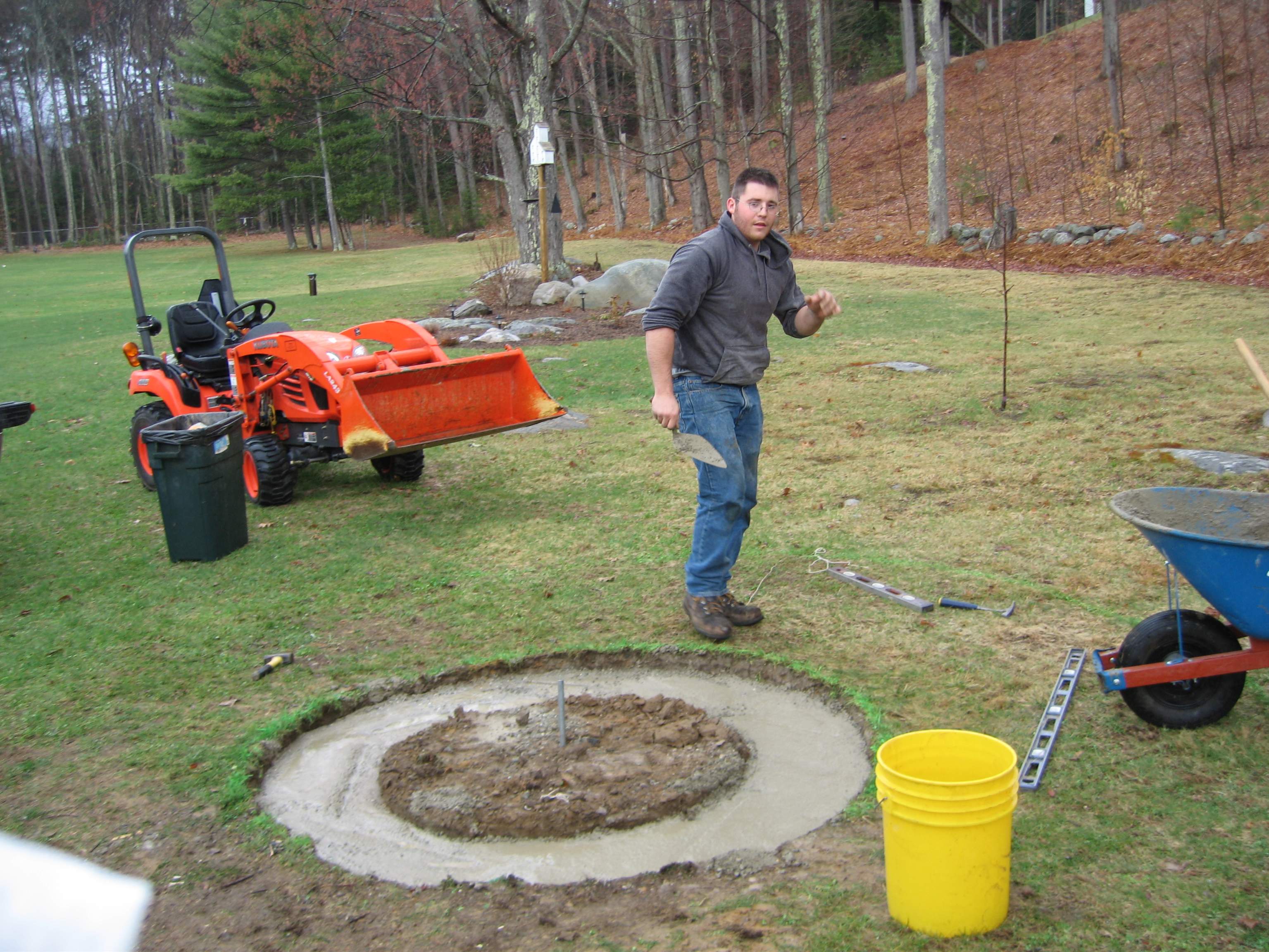

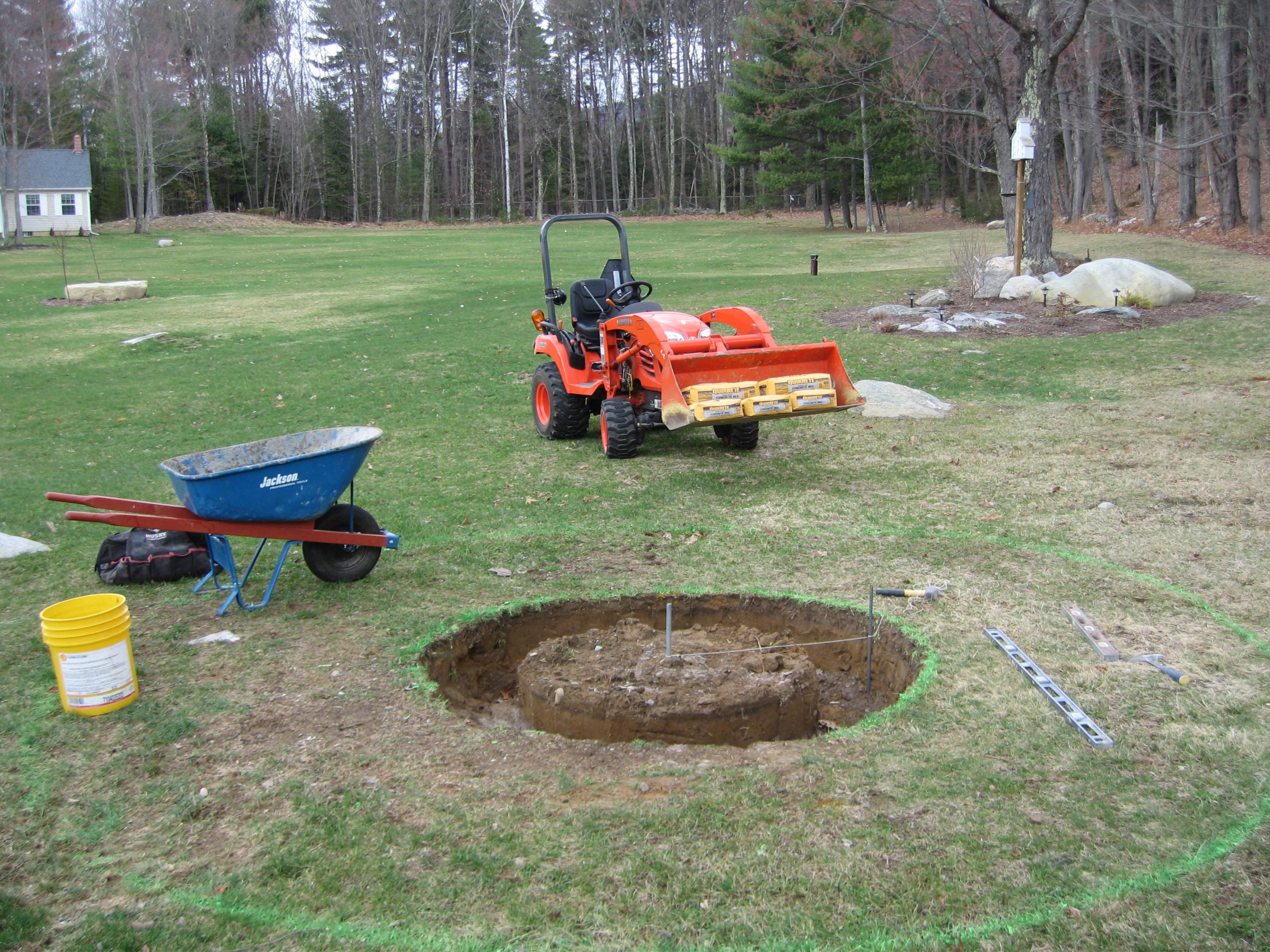

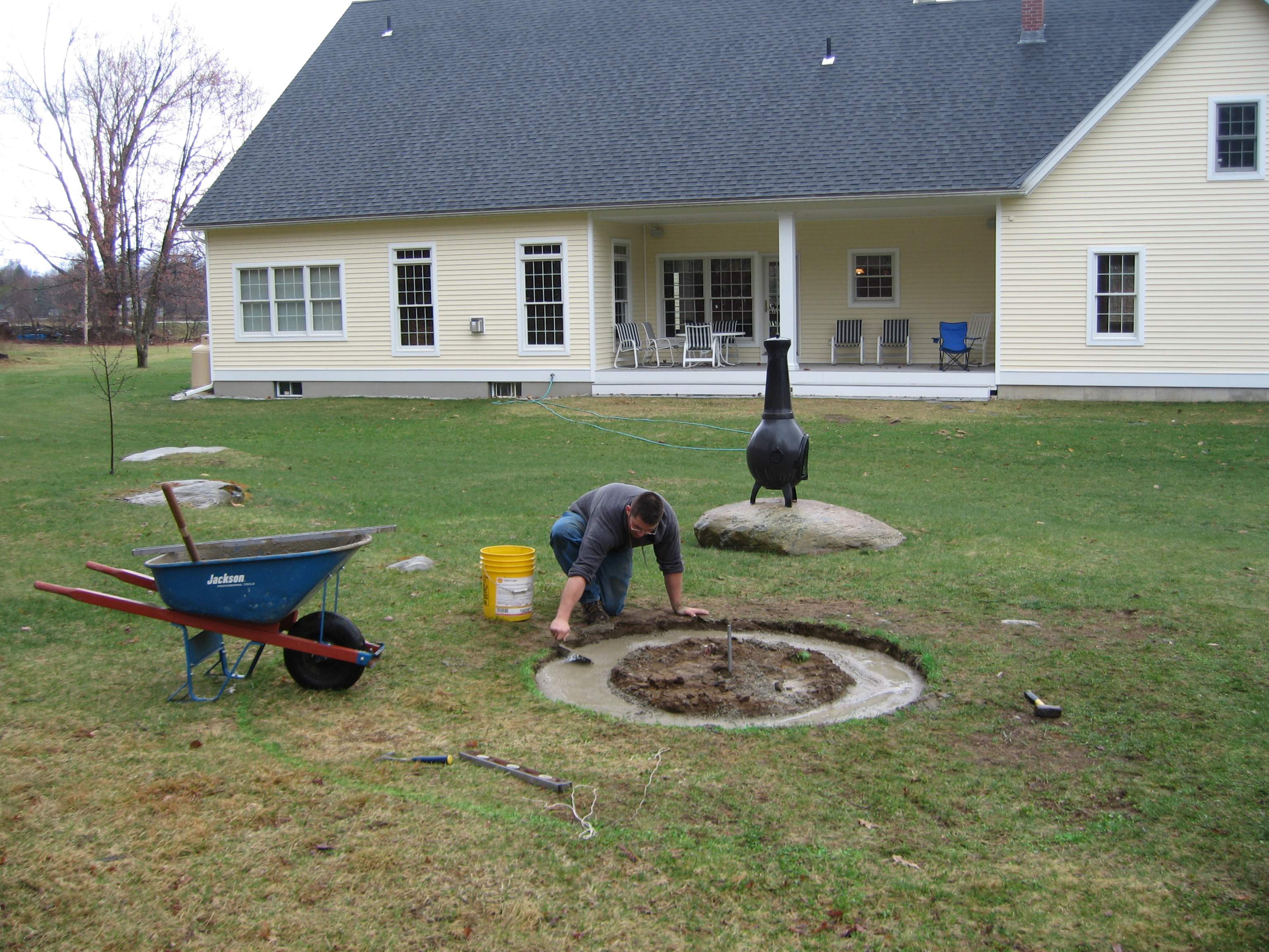

Day 2. Kyle, the mason, explained to me that although very nice, my hole was bigger, deeper, and more rock free than it needed to be. What should have been 8 bags or so of concrete turned into 18 and we even found some of those rock pieces to throw back in. If we decide to can the firepit, I do believe I have enough concrete to build a small missile silo.
The weather man said 60's and fair. It's in the 50's and rainy. Regardless, the concrete is done and level. If we can get the rock here on time, the fun starts this weekend. The tractor has been great. All the hole material got carted away and the concrete was put right in the bucket and brought over to the pit without a lot of bending over.

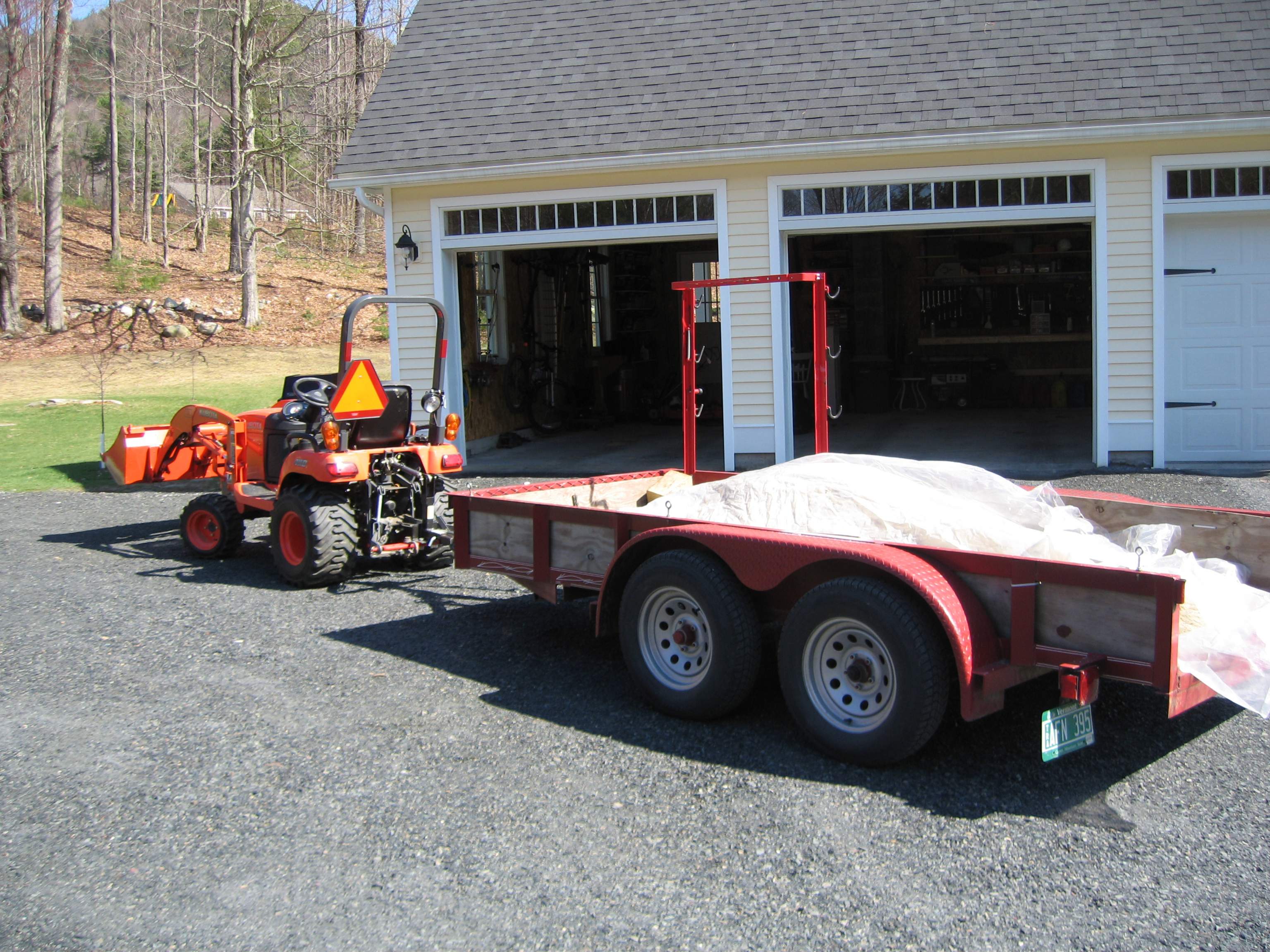

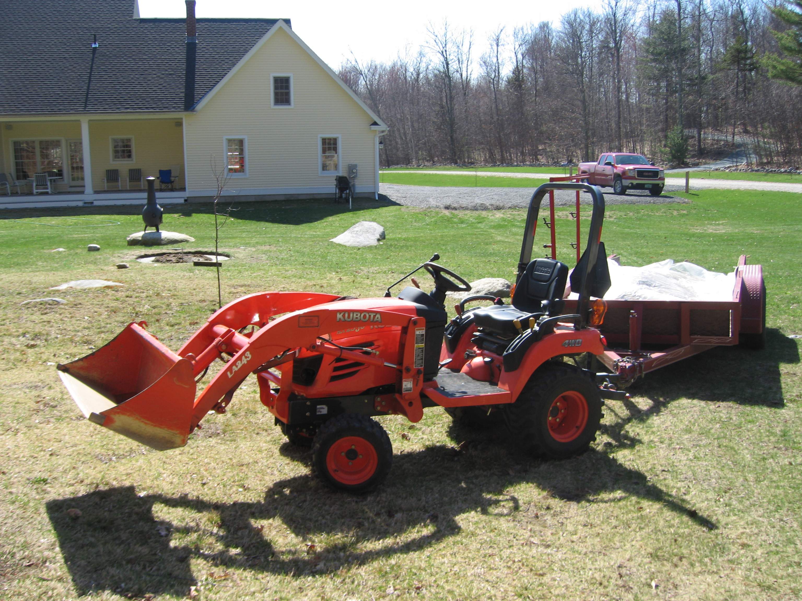

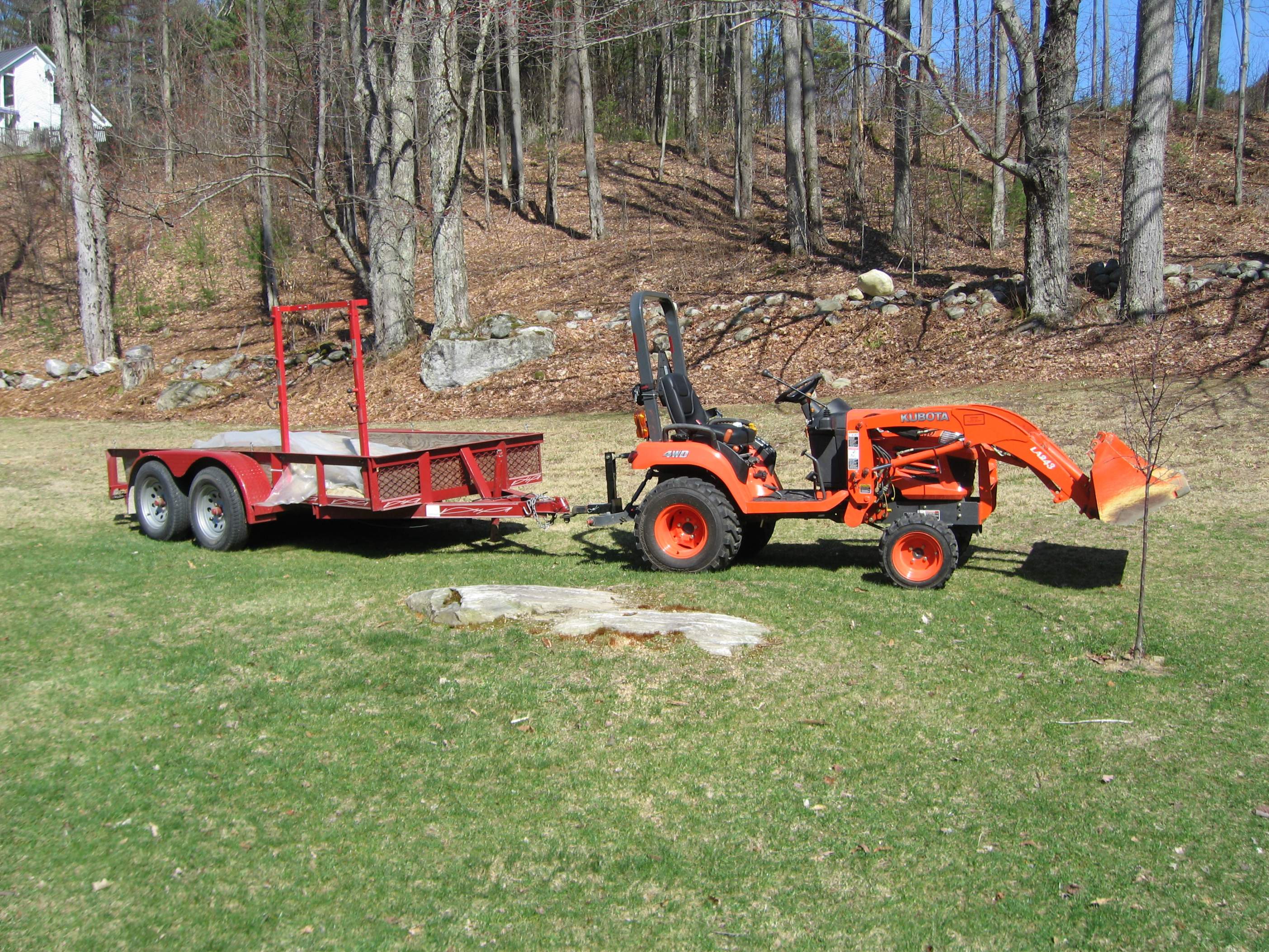

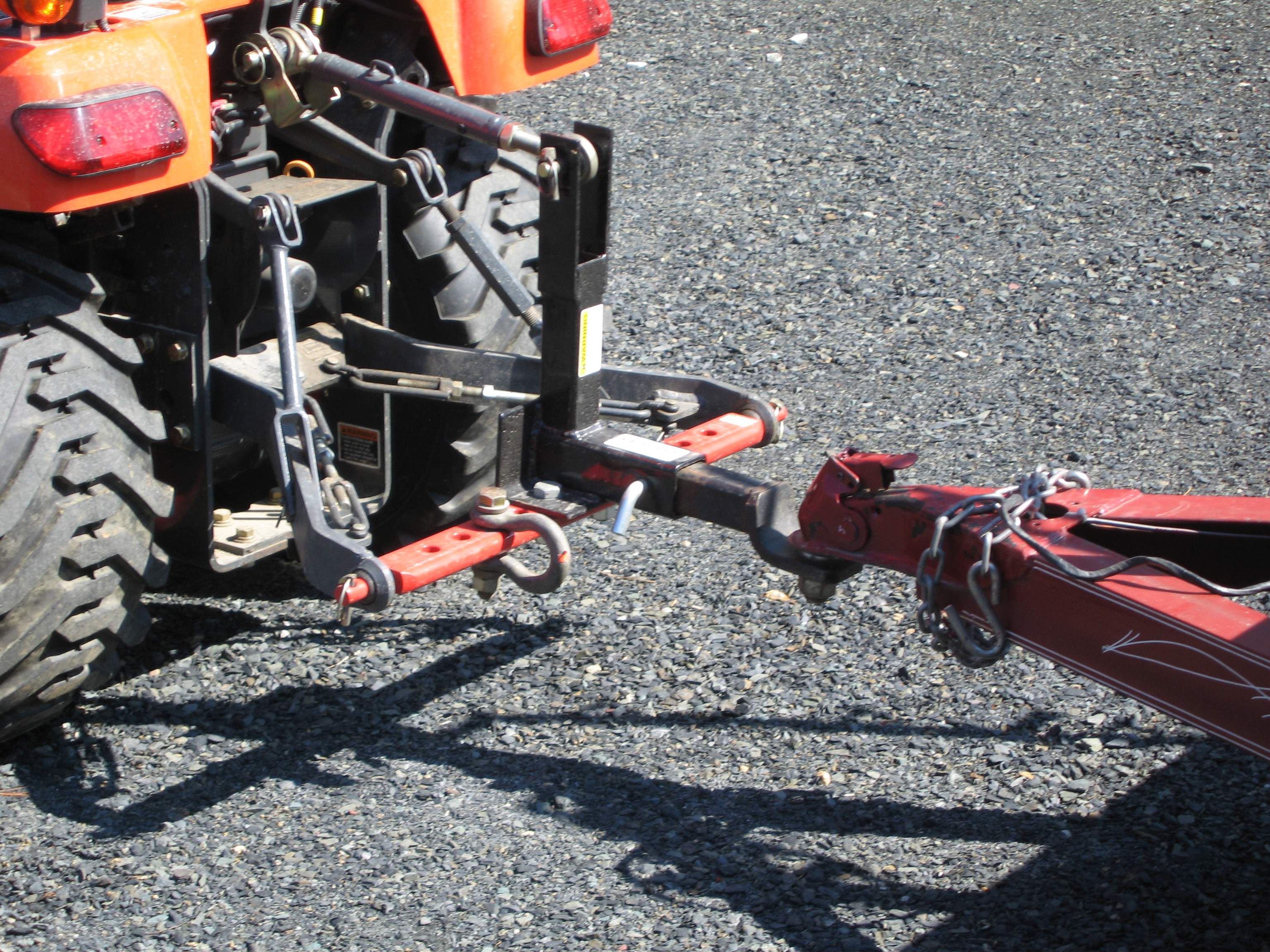

So we have 2 pallets of stone coming tomorrow and I got the firebrick this morning. Sometimes things line up just right. I got a ton of masons sand in my trailer and put it next to our work area for tomorrow. Trailer and sand weigh in at about 3000 lbs. The BX moves it no problem but I still go slow and stay off the banks. The trailer mover is great. I keep it on all summer. I use it for trailer loads of mulch so I can drive right up to the beds and use it around the yard and neighborhood as a mobile work platform. Bring all the tools, drop it, do our work then bring everything on home. Works great. So tomorrow we should see something above ground.

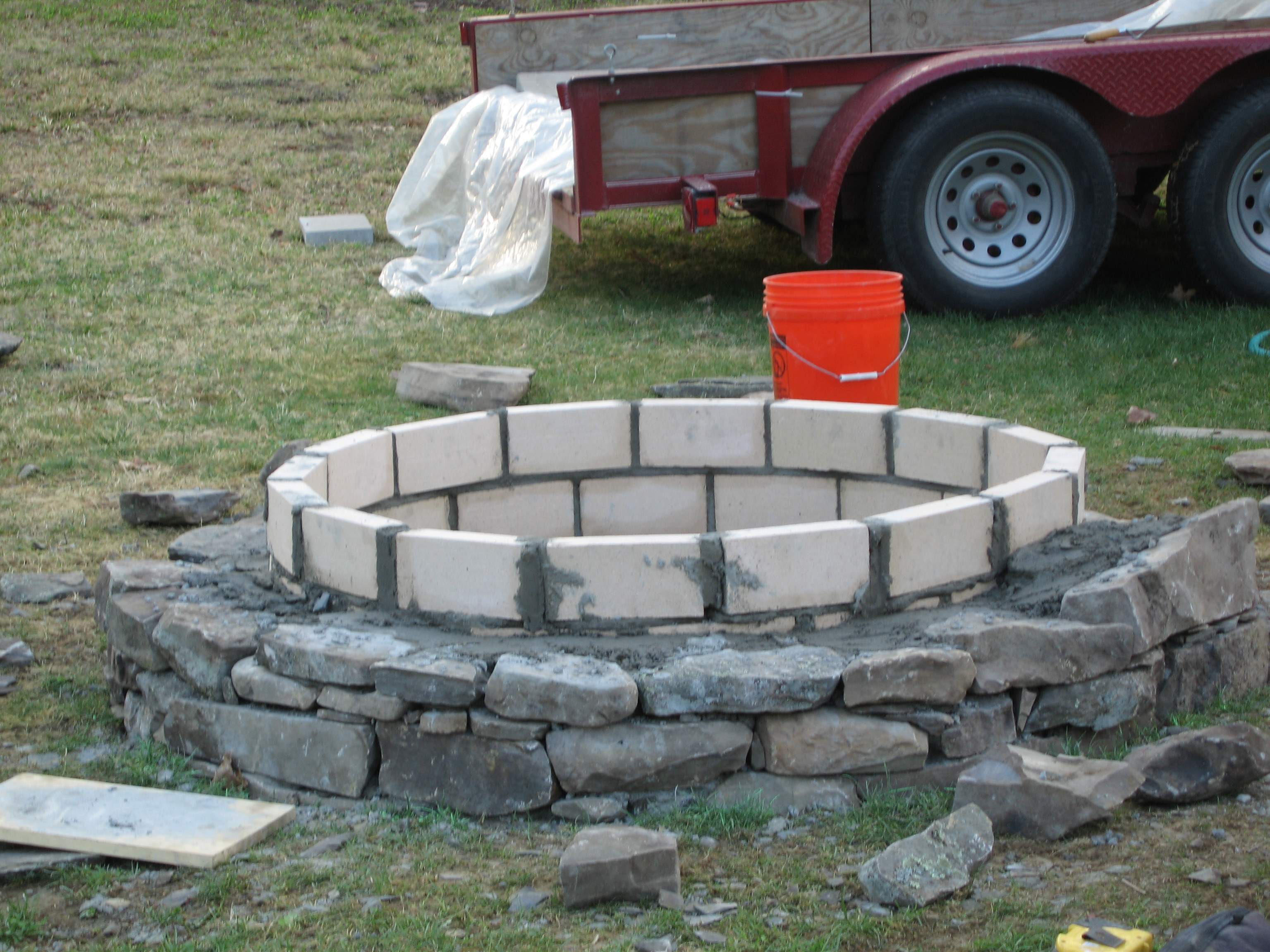

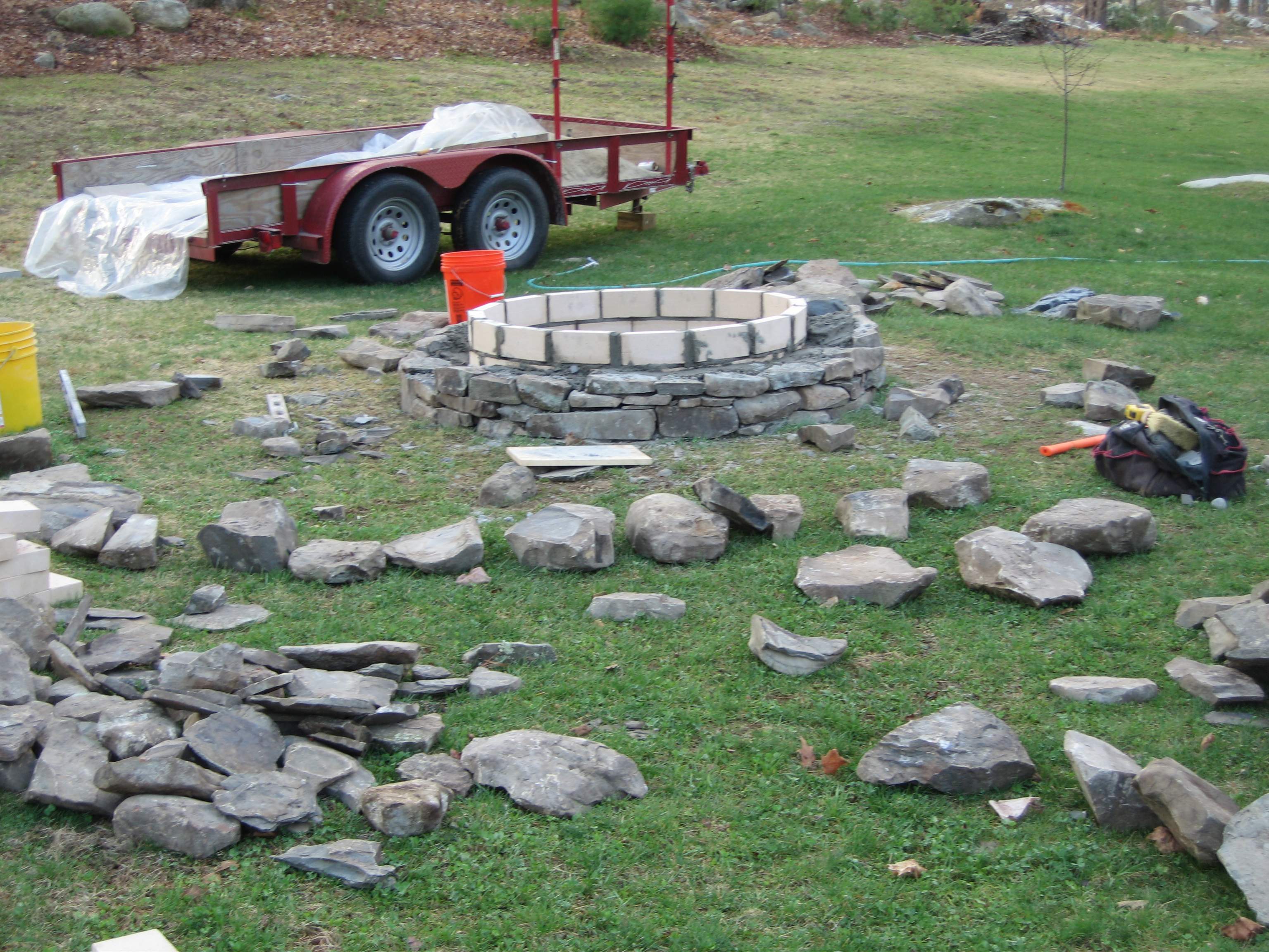

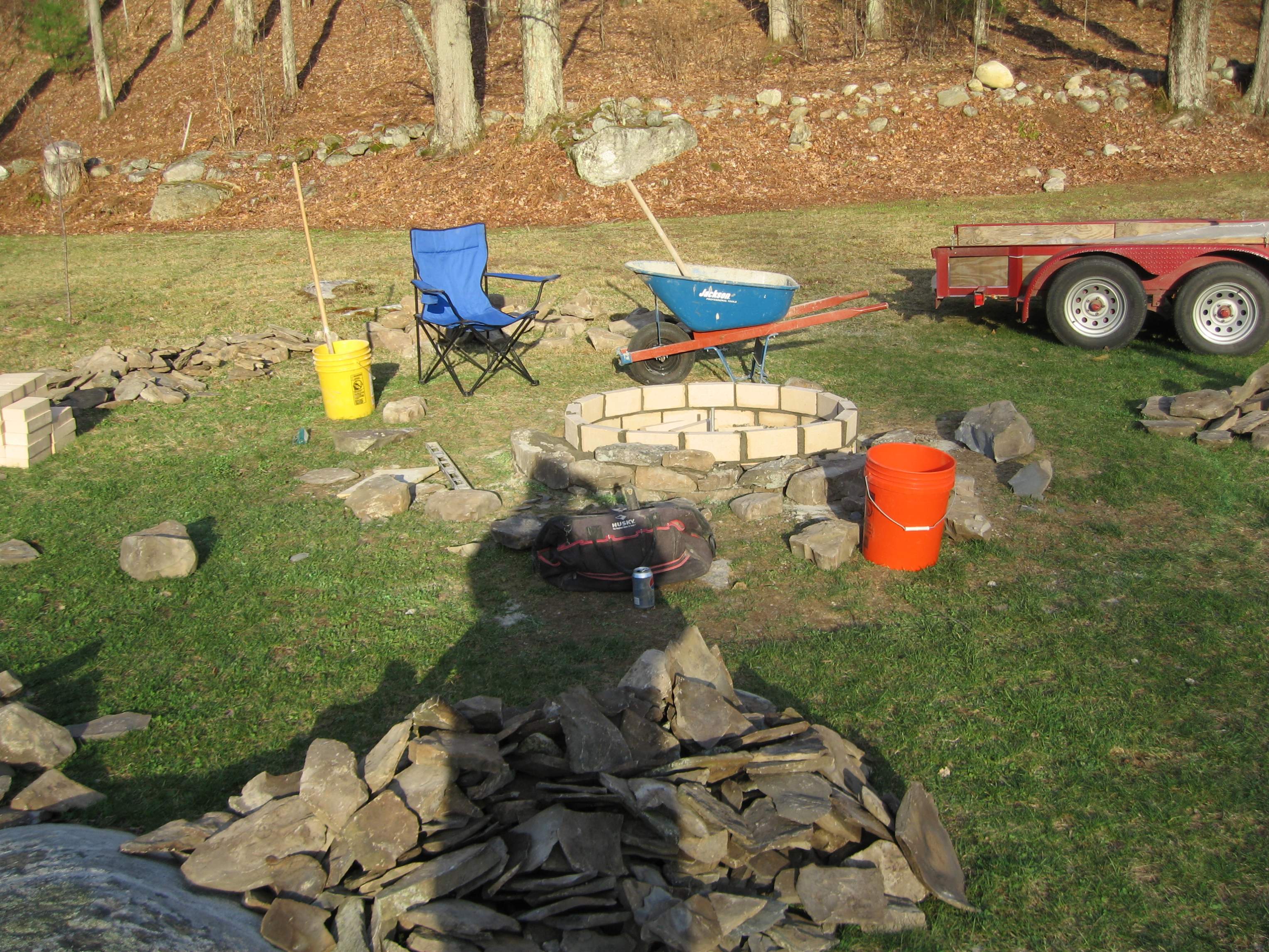

Saturday, sunny and 80+ degrees. The rock is delivered. Maybe I should have asked, but it came in a dump truck on 2 pallets and was "dumped". The morning was spent sorting rock and putting it near the work area. I would have had him dump it closer but I didn't want him driving over my water line. Hey, more tractor time. We have 2 courses of brick up and some stone started. I'm learning as we go, but the thing is one big puzzle. The brick is easy but you have to find that one stone to fit. That will be slow. We're undecided on our height so we are giving it the "chair" test as we go. Today should go faster since we know better what we're doing.

Not much exciting happened today. We decided on 3 courses of fire brick. The finished height should be around 18". For fire viewing and performance that appears to be a good height. We used a lot less brick for a bigger pit than the DIY guys. I'm assuming their bricks were sized different. They called for 60 bricks and we used 48. The brick is done and we're onto just stone. Some goes easy and sometimes you spend a half hour for that one stone to fit. Today should be close to finish if we get an early start. Then it's on to the patio portion. If we get it done today I'll post pictures and break out the costs for everyone.

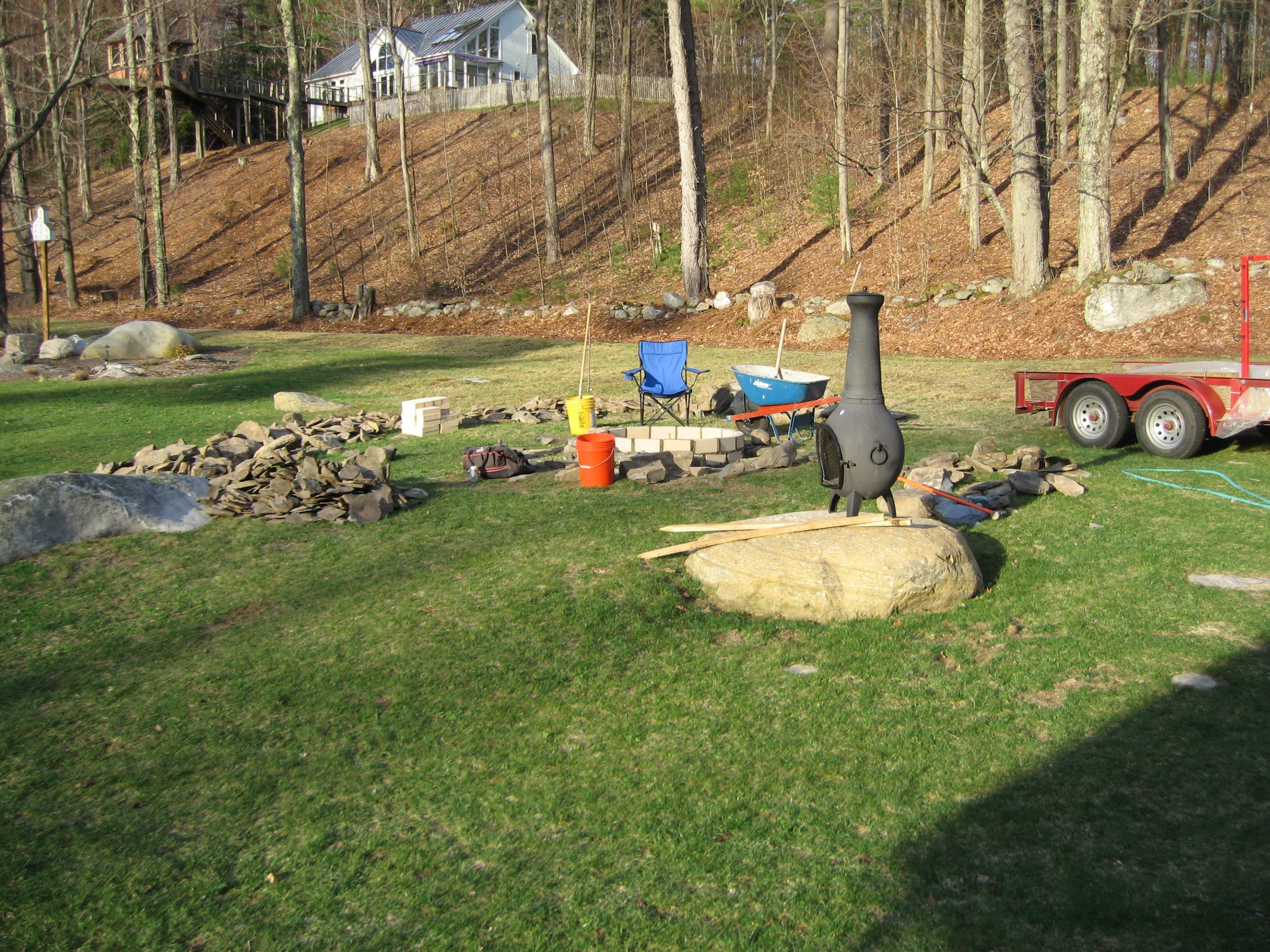

Today was a long day as it was pretty hot. The firepit is pretty well done except for cleaning out the inside and putting in some stone which is what I think we;re going to do. Sorry no fire pictures for a few days as he wants it to cure for a bit before we do a fire. The patio portion is next but may be on hold due to some social obligations. The total cost was in the $1200 range.$630 for stone, $50 for fire brick, $20 for sand, $50 for mortar, $80 for concrete, and $400 for labor. My labor was free. I dug the hole, laid out stone, and mixed some mortar. The tractor really made things a lot easier so I had to sneak it in the final shots.
