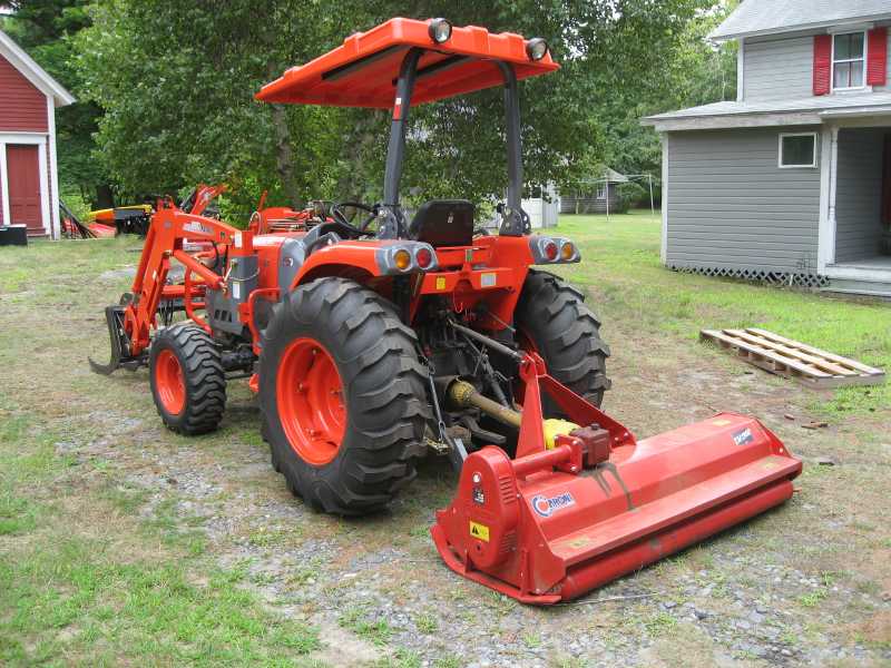

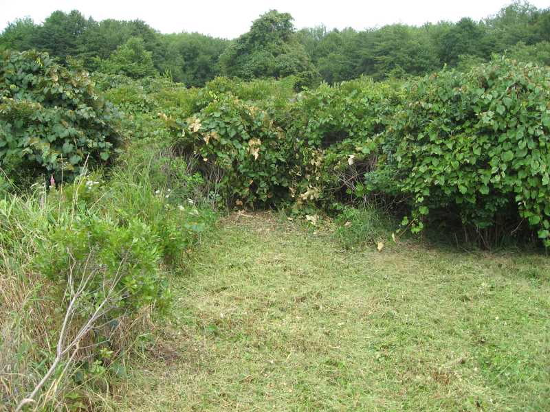

A medium duty flail can cost less than a finish mower but cuts much smoother than a bush hog. Check out the Caroni TM1900 from AgriSupply which could be run on a 30hp tractor.
