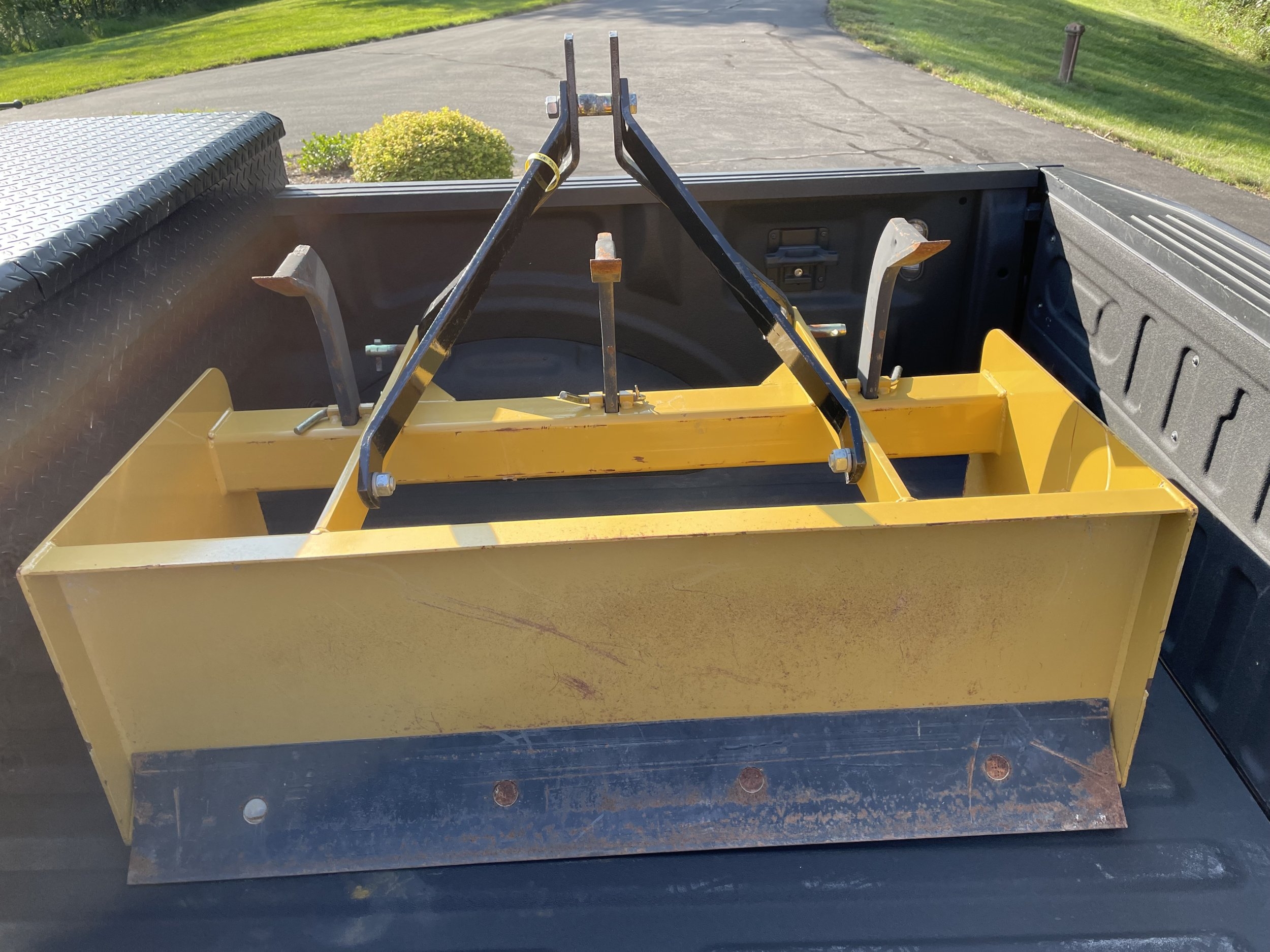

I finally found a box blade at a cheap enough price for me. I paid $350 for a 48“ box blade and found it on Tractorhouse. The stuff on Marketplace was all over the place on price and quality and when I did occasionally find one it was too far away. It’s had light use and was a little heavier duty than I expected. I had to drive about 35 miles and it was at a New Holland dealer.

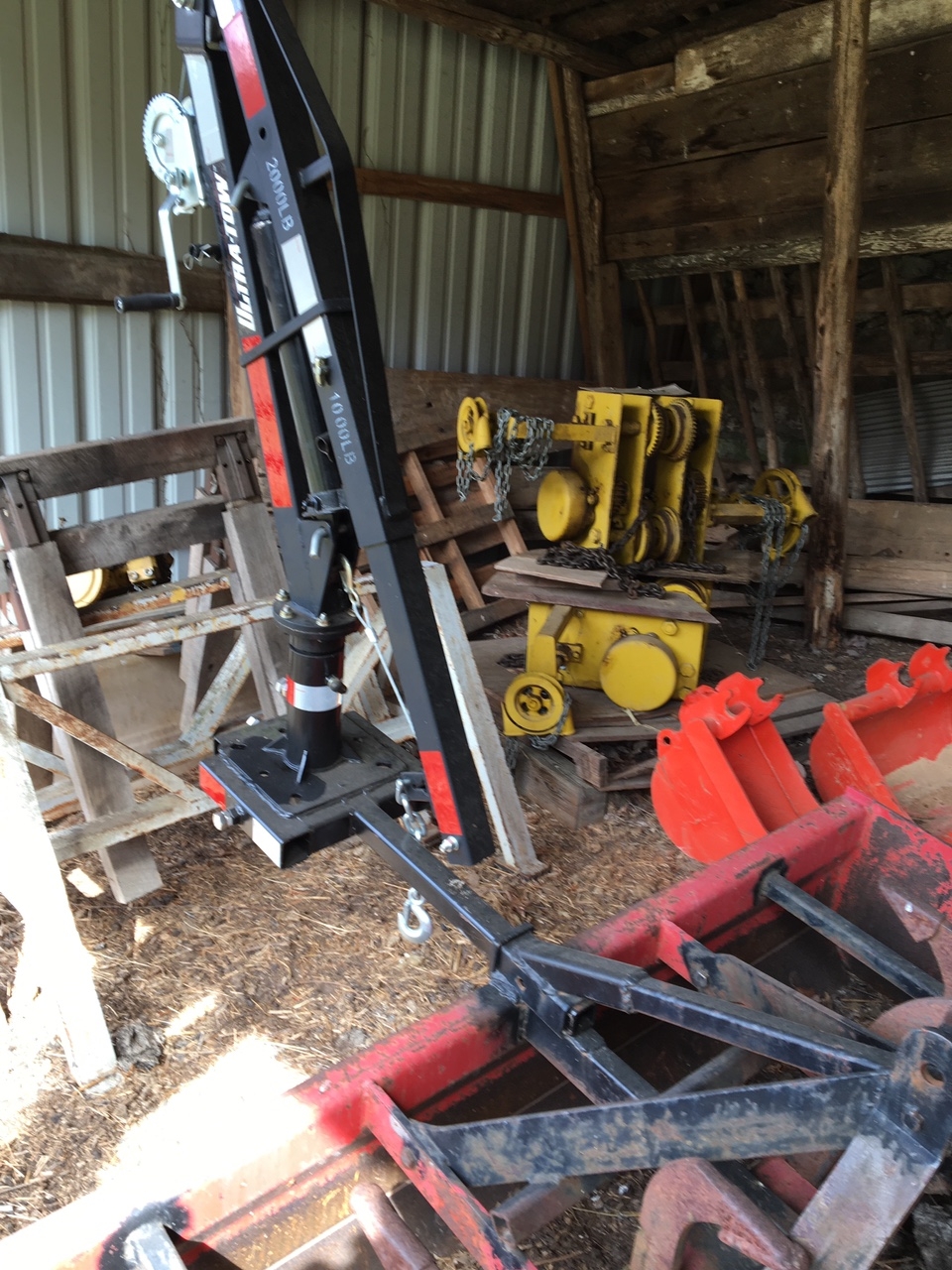

Best thing to do after buying a cheap box blade is to weld reinforcements and hitch frame before it bends. So much easier fix before a bend. Add a receiver hitch or tool pockets. Box blade now stores the hitch crane. After buying Land Plane hadn’t used the box or grader blade.

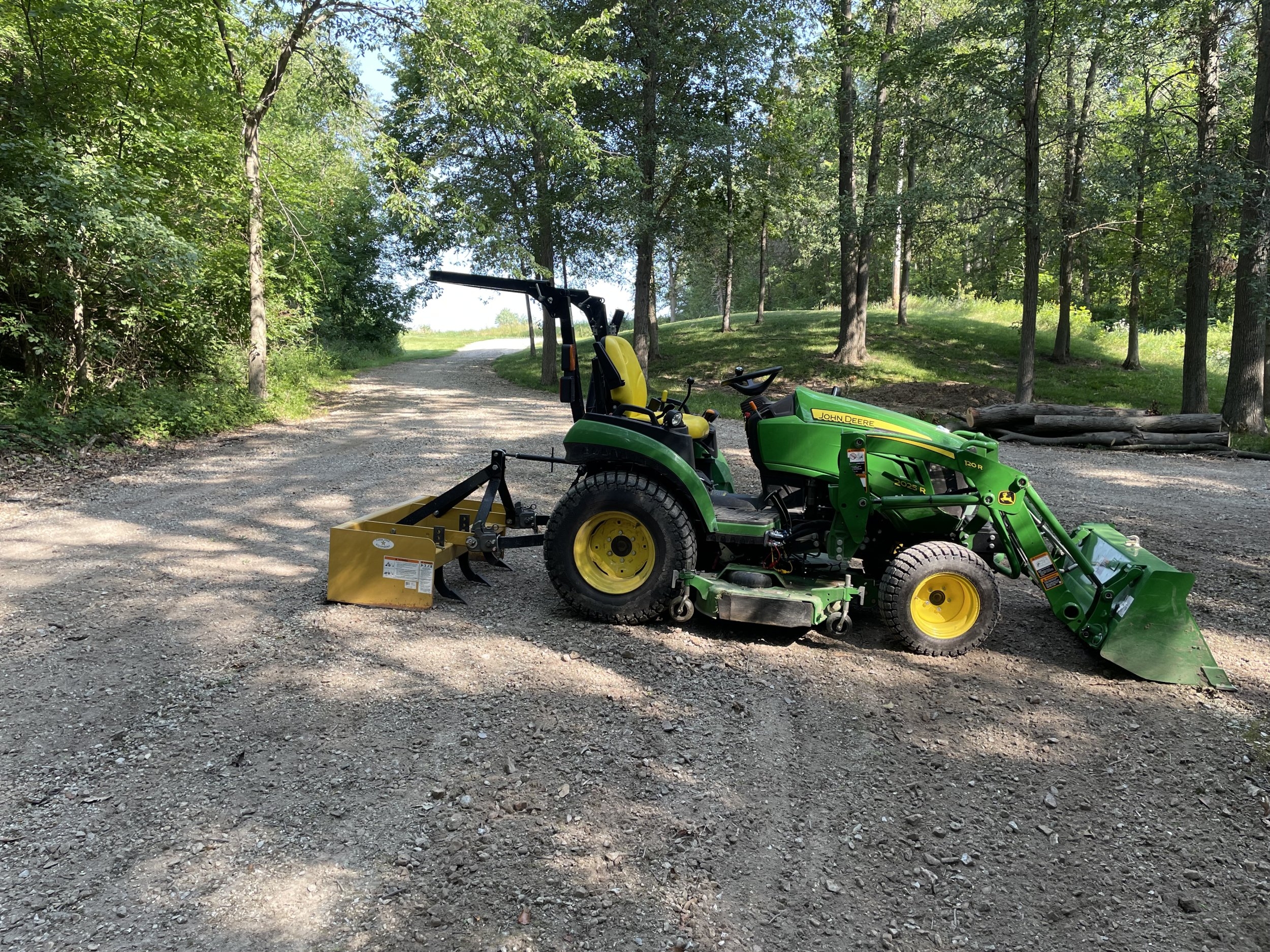

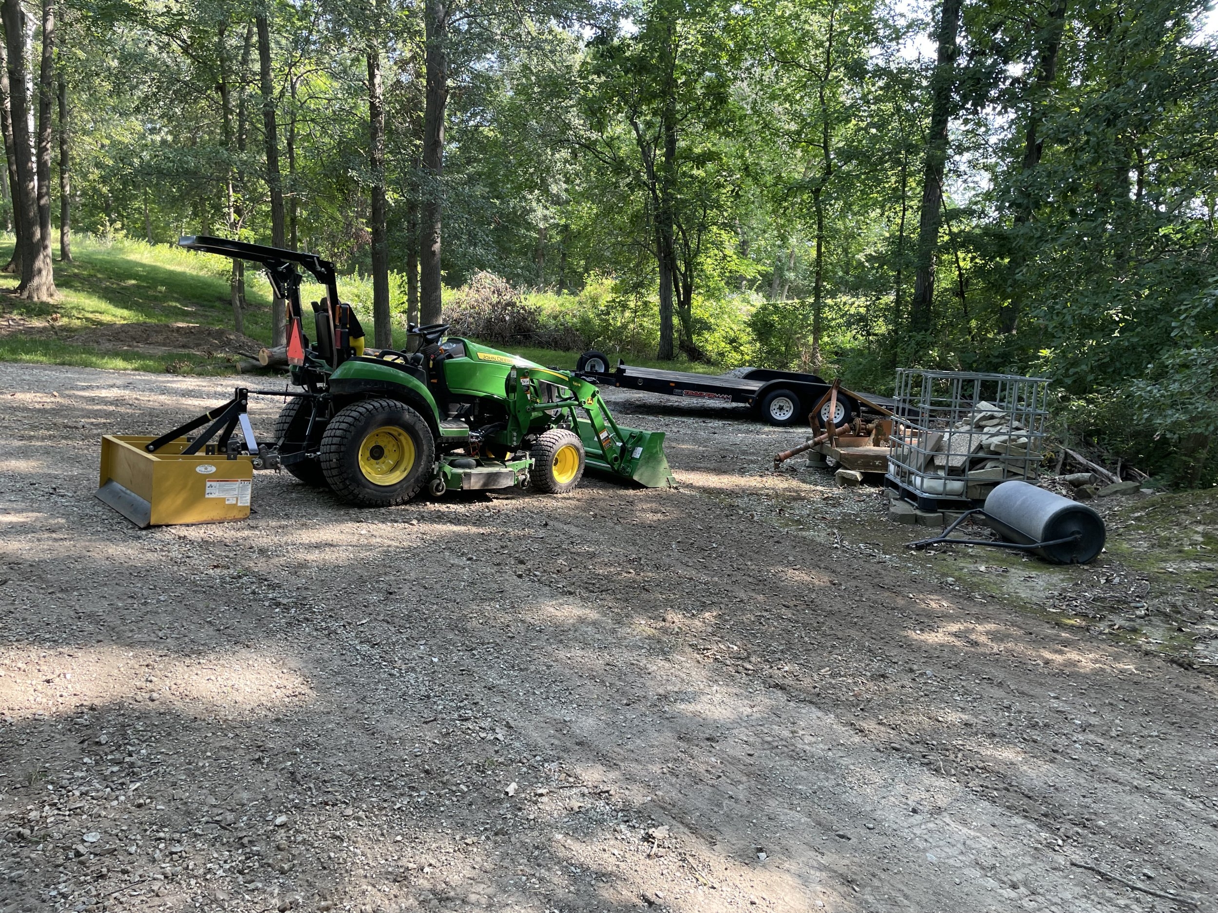

I had a chance to use it today, my driveway to the house is paved but I have a second driveway and storage area that is gravel. It was easier and worked better than I expected. Where a rear blade tends to bounce up and down every time the tractor tires hit a bump the box blade stays put. Having quarter inching on the three point helps also.

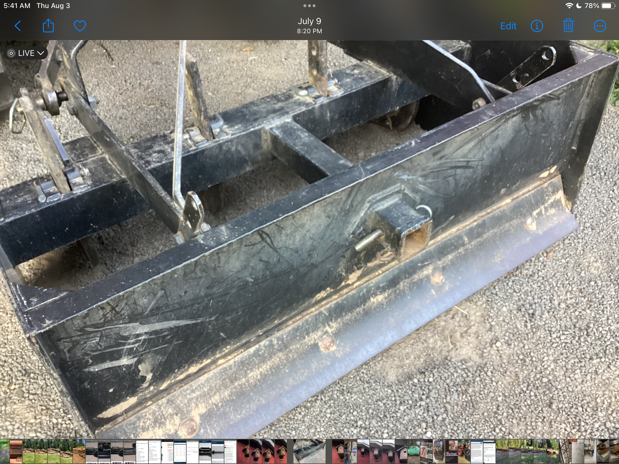

I'd like to add a receiver tube to my 5.5' box blade. It would be easier for me to cut a hole in the rear blade and run it through to the front cross member, but I"m wondering if that is going to weaken the blade?
/ Finally found a box blade. #15
This is what I did when I bought it.
If anything it made it stronger.
iIt’s very handy.
/ Finally found a box blade. #16
That's what I want to do. I see what looks like a reinforcement gusset on the outside. What thickness did you use? Did you also place a gusset on the inside of the blade?
/ Finally found a box blade. #17
Fishplate on outside is 1/4”.
Although it probably didn’t need it, I thought it looked good. Inside is just welded.
I purchased the receiver tube at harbor freight.
