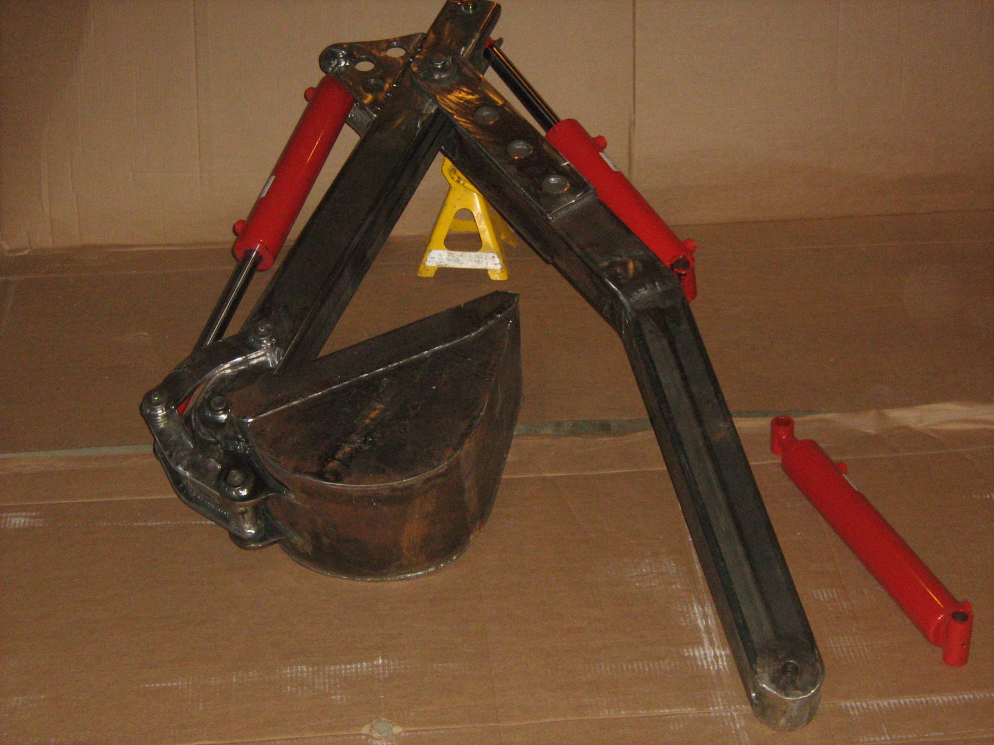

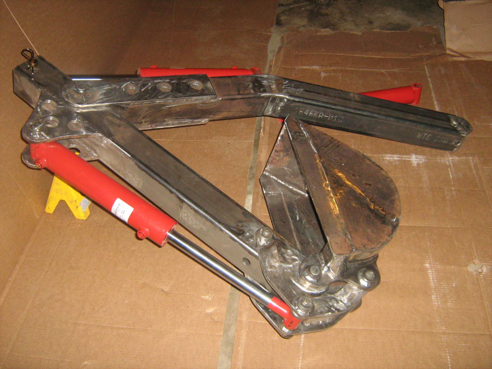

Take a look at the second photo when Iplayfarmer first began this thread. He calls it an angle and I called it a toe. I should have looked it up and used the same terminology, sorry. As for what it's for: I can't speak for Iplayfarmer, but in my case, it makes room for mounting the cylinder operating the boom. As I was putting the mockup together I could see a problem getting the boom, dipper and bucket folded up for transport. Adding that angled piece solved most of that, I hope.
Got it. Thanks for the explaination.
Now you have me curious to check the backhoes at work to see how Case addressed it.

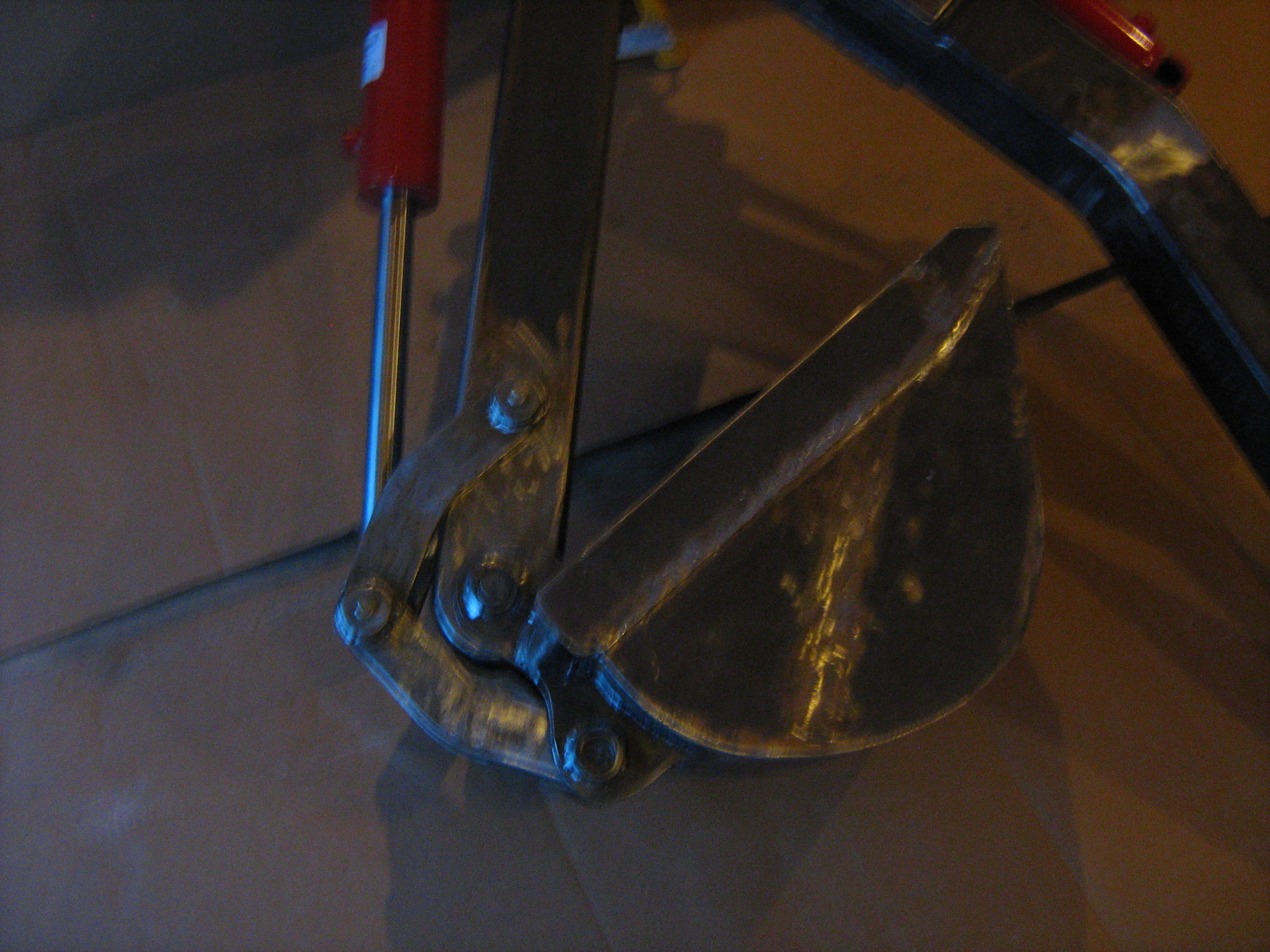

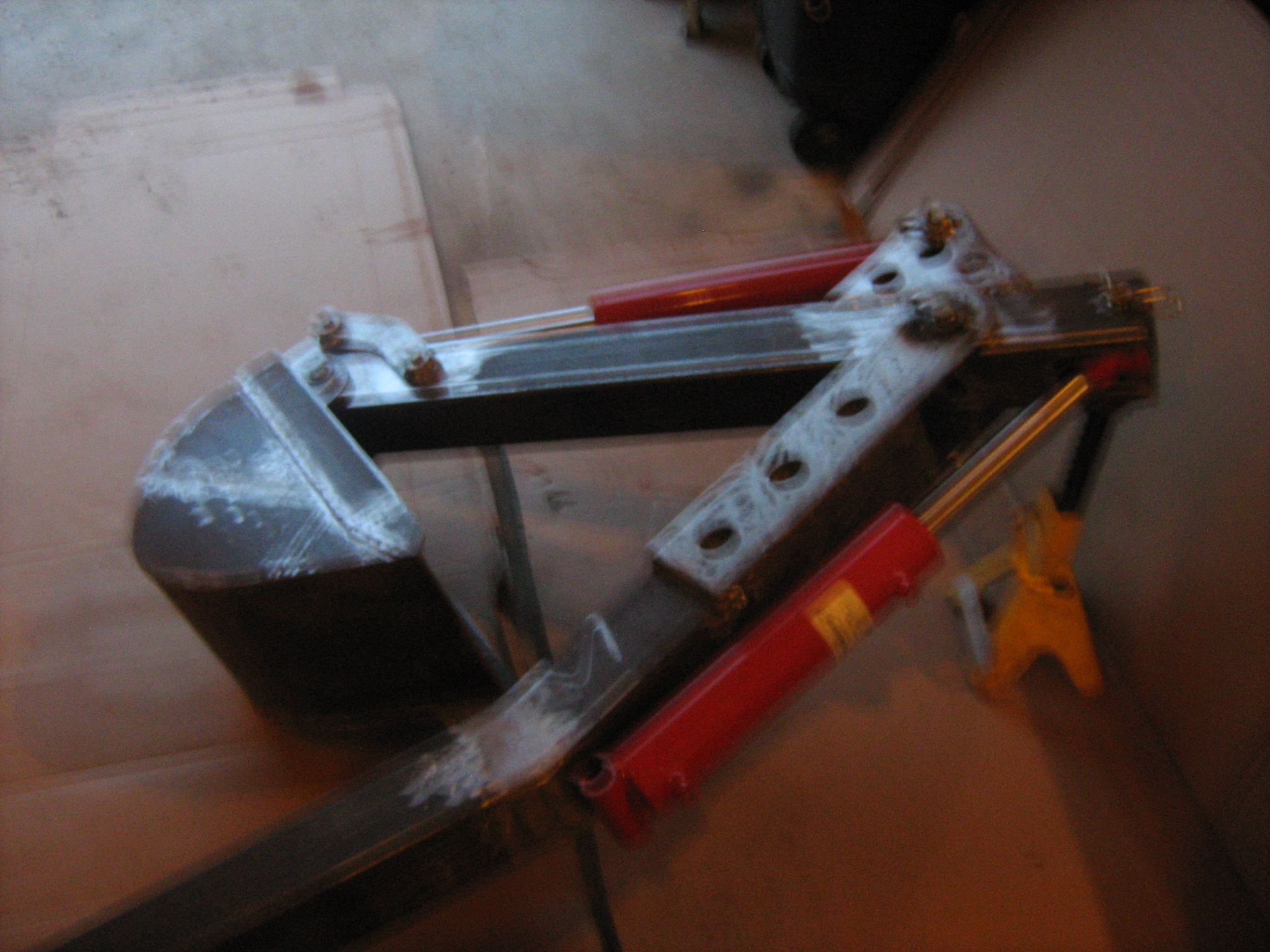

Here is what i've got done so far (I'm not using plans, just building by the seat of my pants. I took some measurements from a Kubota Bx25):

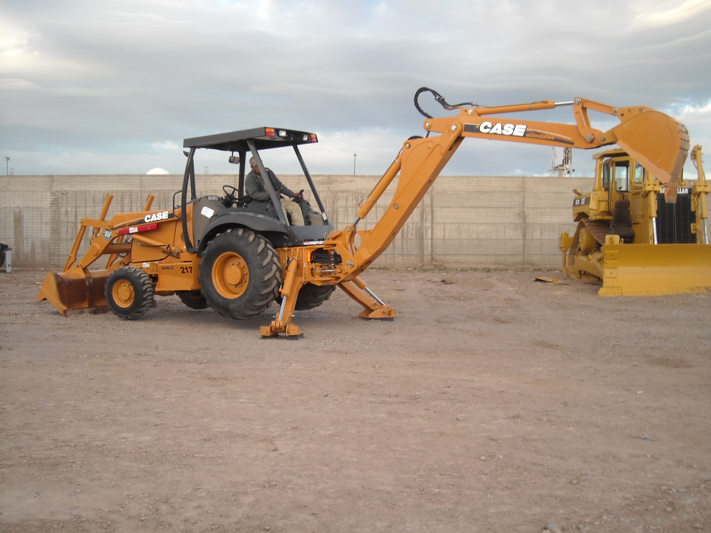

Guess I don't have to wait until tomorrow. Got to love the internet.

Thanks rcurrie. I can see you know your way around a welder. That has the look of a very sturdy machine! You called this a subframe. Are you ready to tell us what this going to get married to?

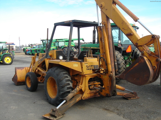

Before the use of ductile iron for the booms, the 580C addressed it a little differently.

I will be making a subframe for a Kubota Bx 2350. Hopefully when this is done it should hook up similar to a Bx24 setup. My welding skills aren't that good but I figure thats why grinders were invented.
