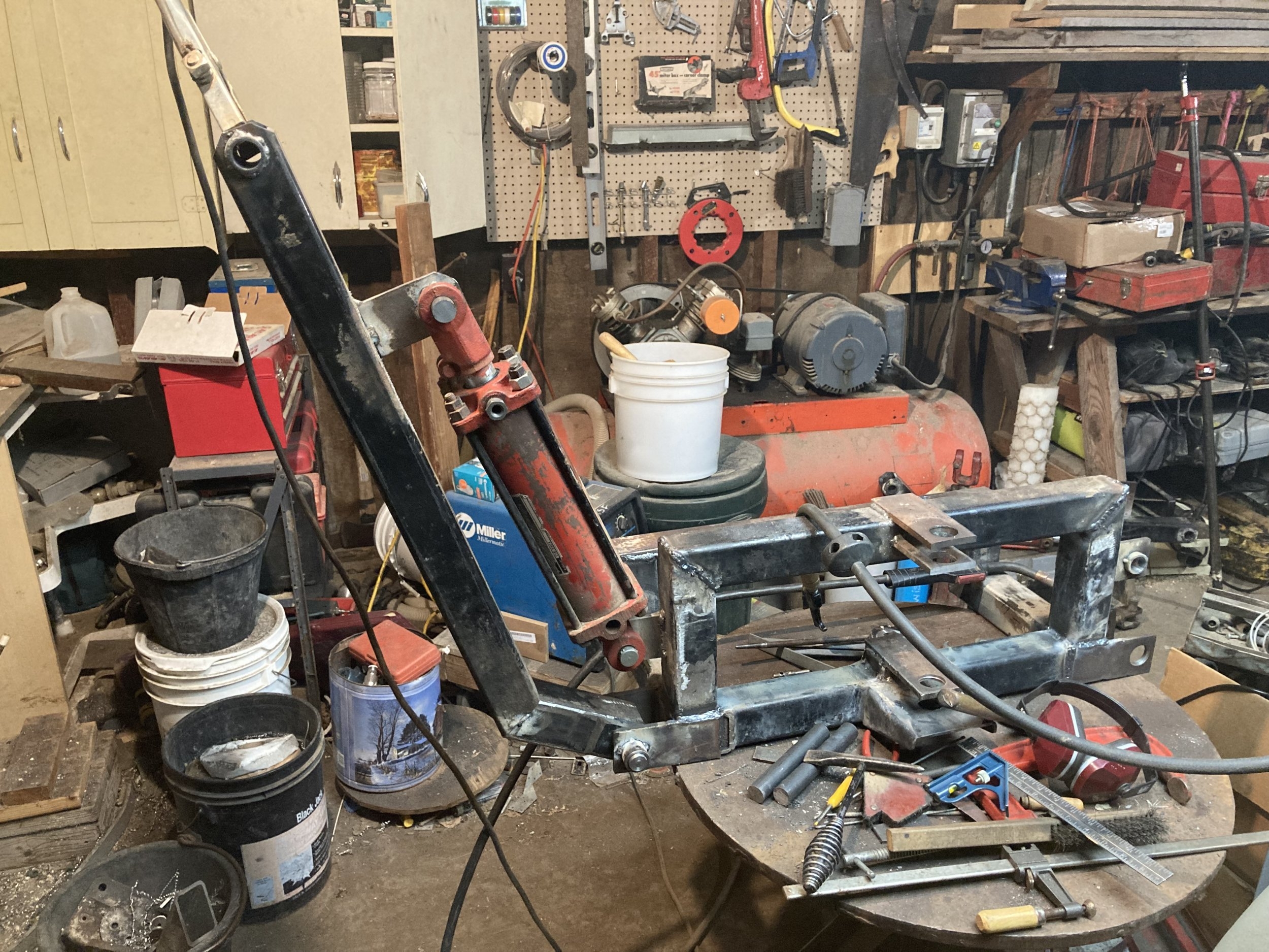

How much trouble do I get in for resurrecting a 13-year-old thread? Do I get some level of forgiveness if I am working to complete a 13-year-old project? I've picked this backhoe project back up... this time with the intent to mount it on my antique Terratrac GT30 crawler tractor.
So far I have the main frame and the boom cut out and welded together. I also have the stabilizer feet welded up. The main boom is still in the shed from years ago when I started. I don't think I will post a lot, but I wanted to catch people up on the reality that this might actually happen.
/ Finally Building my Backhoe
#186
Here is a picture showing the main frame welded up with one stabilizer foot pinned in place. This picture also shows how incredibly cluttered and disorganized my garage/workshop is.

My status update so far...
I have the subframe that mounts to the dozer all fabbed up. In the attached picture, the subframe is not finished. I had to get it in place before I could figure out a set of braces that hold it more solidly to the frame. I ended up drilling a 1/2" hole into the angle iron bracket above the subframe and cut some 1/2" bar that I welded to the subframe. It will probably show up in the next few steps of the process when I am posting pictures.
The next step is probably the swing box.

#192
Here is another picture of the subframe with the mainframe attached to it. Things must have gotten a little warped in the final weld-up because I had to tap on the main frame to get it to settle on the pins of the subframe. A little time with a die grinder will probably fix this.
It's a journey resurrecting a 13 year-old project. It's almost like trying to following someone else's incomplete instructions. I had some parts cut out and fabbed in the original push. I'm not sure I remember just how I intended for everything to go together.
