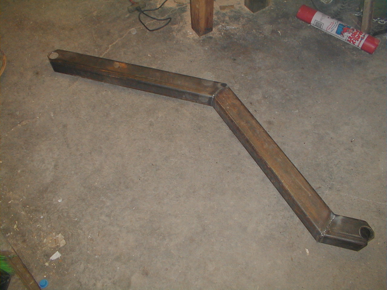

I snuck off for an hour tonight and welded up the skeleton of the boom. I'm going weld plates on the side of the boom accross both seams later, so I ground the welds down to allow the side plates to mount flush.

I hate grinding welds; but sometimes it has to be done. Keep the pictures coming as progress is made.
/ Finally Building my Backhoe #68
I agree one of my least favorite things to do, counter productive.. :)

I kept wondering if I could have minimized the grinding if I were a better welder. I chamfered the joint good and deep and I turned my amperage up a click, but I still had protrusion above the surface. That said, I had to grind less that I would have had to do a few years ago when I had started welding.

I'm using 1/8" 6011 rod. I'm running it on DC+ at about 90 amps.

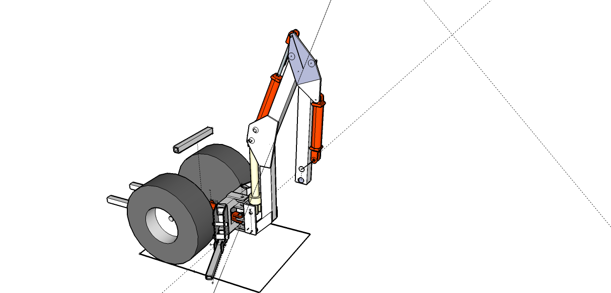

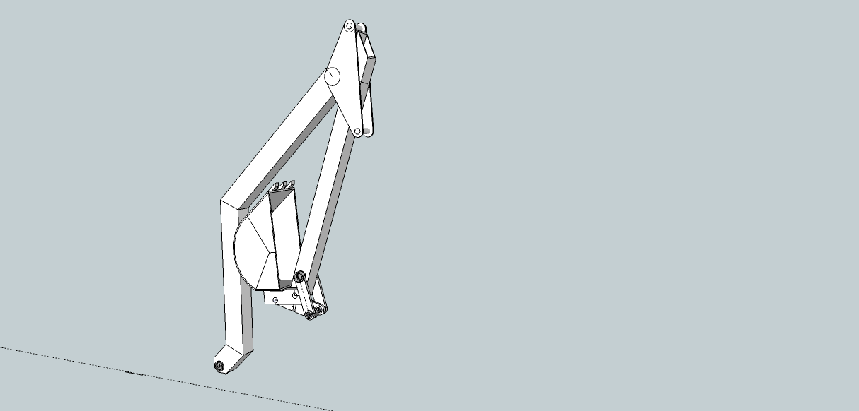

Per the PM request of a few other members, I'm attaching a .zip file with two partial sketches of the backhoe plan. I've redrawn various parts of the backhoe multiple times as acquired materials or got new ideas about the plan. As a result I don't have any single sketch that covers the whole plan. These two that are attached will give a good idea, though.
Seems to me that you should be welding at 125 amps? This will give you much better penetration and get that bead to lay down more (less grinding). Also, you might try running them on AC (it believe they are intended for AC or DC reverse polarity). You must be experiencing a lot of stuck rods?

BTW, I was welding today and tried 6011 at 90 amps. Seemed a bit too cool for me. I went back to my normal 105 and it is much better for me. Will try the 125 suggested next and see what I get.

Was able to open the zip files and use Google Sketch up to view the files.
Nice work.
I've not been able to generate that much detail using Sketch up. I need to learn how to do it.
Bravo!

I'm no welding guru, so someone else's advice is likely better. The little chart on the side of my welder said to use 85 amps for 1/8" rod. That's all I had to go on.

As for detail in sketchup, I've found it very handy to make groups and then open the group to edit it. I.e. if I want a square tube, I'll make a square and then make that square into a group. I'll open the group, and then pull the square into a tube. For me sketchup has been a super useful tool. There are a lot of design flaws that I discovered in sketchup that I never would have found with my previous pencil and paper sketching methods. 3D is very nice to have.

I would say 90 Amp for the 1/8 6011 is a bit on the cool side but it is within the recommended range. Range being 75-120 or so for that rod. It depends what is the thickness of the material you are welding. Since you are using 1/4 tubing I would say you could crank that puppy up to about 100-110 Amps. You will get better penetration and smoother welds (possibly).
You might want to give E7018 rods a try. They weld very smooth and the end result is stronger if used properly.
