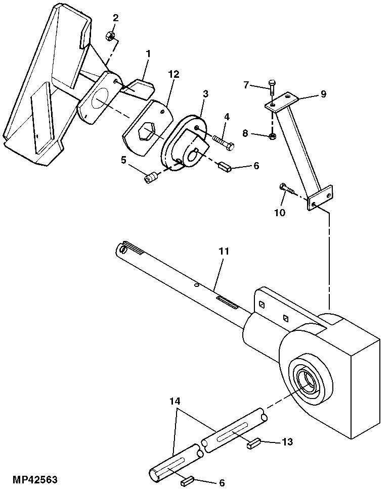

after looking at the parts breakdown, it looks like
they are using a different auger gearbox in that blower.
the collar that houses the shear bolt is the same though,
but there's a new "plate" between the collar and impeller.
i wonder what the chances of the old steel impeller fitting in
that new blower would be, knowing that the shaft size
is the same.
might be an easy swap out to get the best of
both worlds.....
and Happy New Year to everybody!
:D

Easy for me to say this sitting here...BUT, looking at that pic, what I'd probably be inclined to do would be bring the plastic joke of an Impeller to one of my friends to have him fab up a 4 bladed STEEL impeller to directly replace the existing one.
