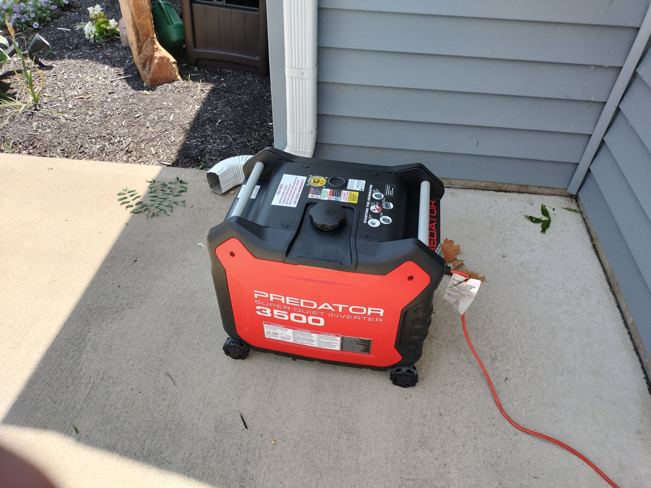

After massive storms ripped through western IN last night, I finally bought a 3500W Inverter Generator from HF. It will run almost 24 hours on 5 gallons of fuel.
So far, quite impressed. Easy setup and starting, also very quiet. Rumor says we could be without power for 6 days. Looks like I can keep the freezers running and the air fryer too 😂
Wish I had not waited so long View attachment 808683
Bought the same one about 5 months ago, they had a coupon thing going so I paid $720 , have only put 1-2 hours on it so far. Changed the oil after about 1/2 hour of use. Seems to start very easy when it’s warm outside but not very easy when it’s cold outside. Kinda surprising how heavy the little thing is, if it wasn’t so heavy I’d probably store it inside the house during cold weather to insure it would start Easy when I needed it. I probably should have bought the next smaller size, they are quite a bit lighter so would be much easier to carry by hand and probably would put out enough power for the little I would use it. Power outages have been pretty rare where I live and rarely last more than an hour, about 30 years ago Power was off for about 24 hours because of a serious ice storm.
