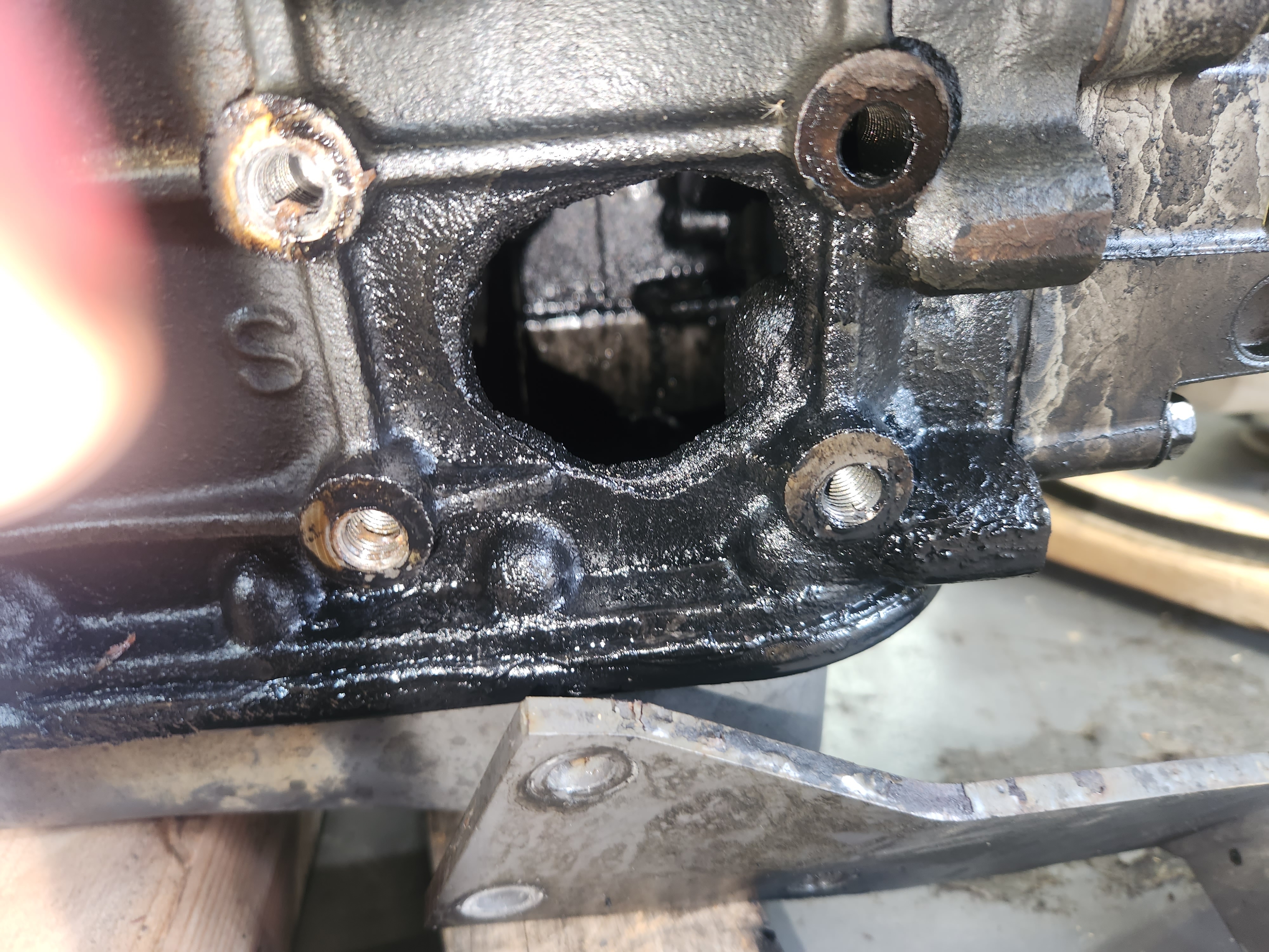

A question for the OP. Did they ever tell you what the root cause of your engine problem was ?
No. When I was there Wednesday (posts 104-106), they had pulled out the old engine and installed the new one. I was told that the old one was in a crate (probably the one that the new engine arrived in) and was going to be shipped back to Massey Ferguson for analysis. The dealer's mechanic had not pulled the head nor dropped the oil pan.
Pictures in post #1 were of the hole in the right side of the engine, but I knew there was a hole(s) on the left side hidden behind a bracket, so it couldn't be seen from the outside. Turns out that bracket was the left rear mount. Here's a photo that he took of the left side with the (bent) bracket before he crated it:
Strange diagnosis? When I was at the dealership last week, I asked the mechanic if he had dropped the oil pan after pulling the engine. His reply seemed strange to me: "Didn't have to, the oil pan was full of antifreeze". I had not seen that on the dipstick after the engine blew.
The service order I got today said: "found antifreeze in oil because bad head gasket caused engine to detonate". I'll take that with a grain of salt. I more strongly suggest that the errant connecting rod cracked the water jacket.

Of course there was antifreeze in the oil, the engine exploded. My guess is you’ll never hear what the cause of failure was. I took apart a small engine years ago that had a rod failure. The connecting rod bolts were almost worn completely smooth, most of the threads were missing.
/ Fergie's in ICU #137
@dicktill didn't really specify what he was doing when it came apart ... I just assumed that it was, and had been running for a bit ... Which if that is the case ... A leaking head gasket theory seems a bit of a stretch ... If it happened on start up after sitting for quite awhile ... Maybe ...
