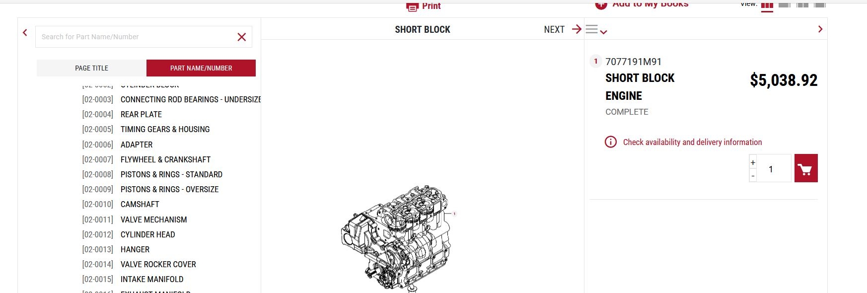

Strange diagnosis? When I was at the dealership last week, I asked the mechanic if he had dropped the oil pan after pulling the engine. His reply seemed strange to me: "Didn't have to, the oil pan was full of antifreeze". I had not seen that on the dipstick after the engine blew.
The service order I got today said: "found antifreeze in oil because bad head gasket caused engine to detonate". I'll take that with a grain of salt. I more strongly suggest that the errant connecting rod cracked the water jacket.
I have to agree. If there is antifreeze in the oil, then one should look for the source. The couple of holes in the side of the block (and one shiny crankshaft rod journal) only show part of the picture of the internal damage.
However, I would ask what color the antifreeze was in the pan.
If all the oil in the pan was a white cream, then you've had water getting into the oil for quite some time.
On the other hand, if you have nice translucent yellow (or black) oil plus green antifreeze, that is an indication of a catastrophic event and rapid mixing of oil and coolant.
I have an old Ford Industrial engine to tear down. I'm pretty sure there is something bad that happened internally. After it stopped running, I realized that I had massive blowby and yellow oil... which now I know means the engine already had one foot in the grave, and I hadn't realized it at the time.
