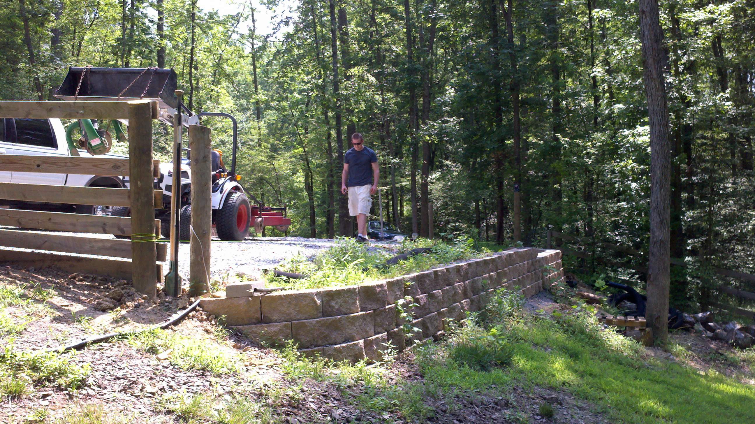

Oh man am I annoyed. This will be attempt number 3 to reply. Apparently adding pics keeps kicking it back on my phone. Anyways, I decided to run the posts at 8' spacing and get rid of the 4' section completely. After sketching out quite a few drawings and measuring a bunch of times, it worked out that the new corner post actually ends perfectly at the end of the retaining wall. The retaining wall is why a gate wouldn't work. It looks really nice so far, and as soon as I can upload pics from my computer I'll post them for your amusement!

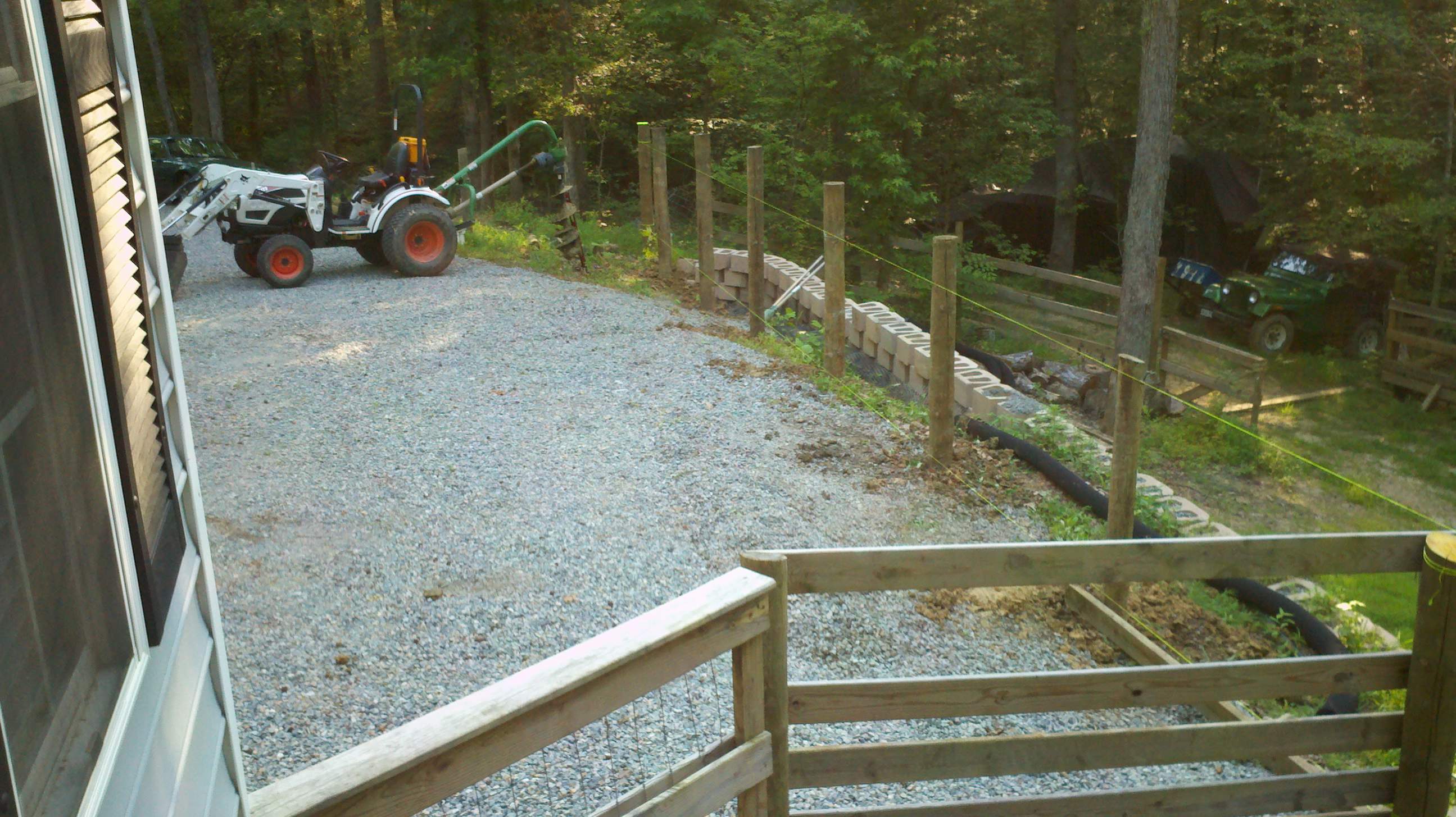

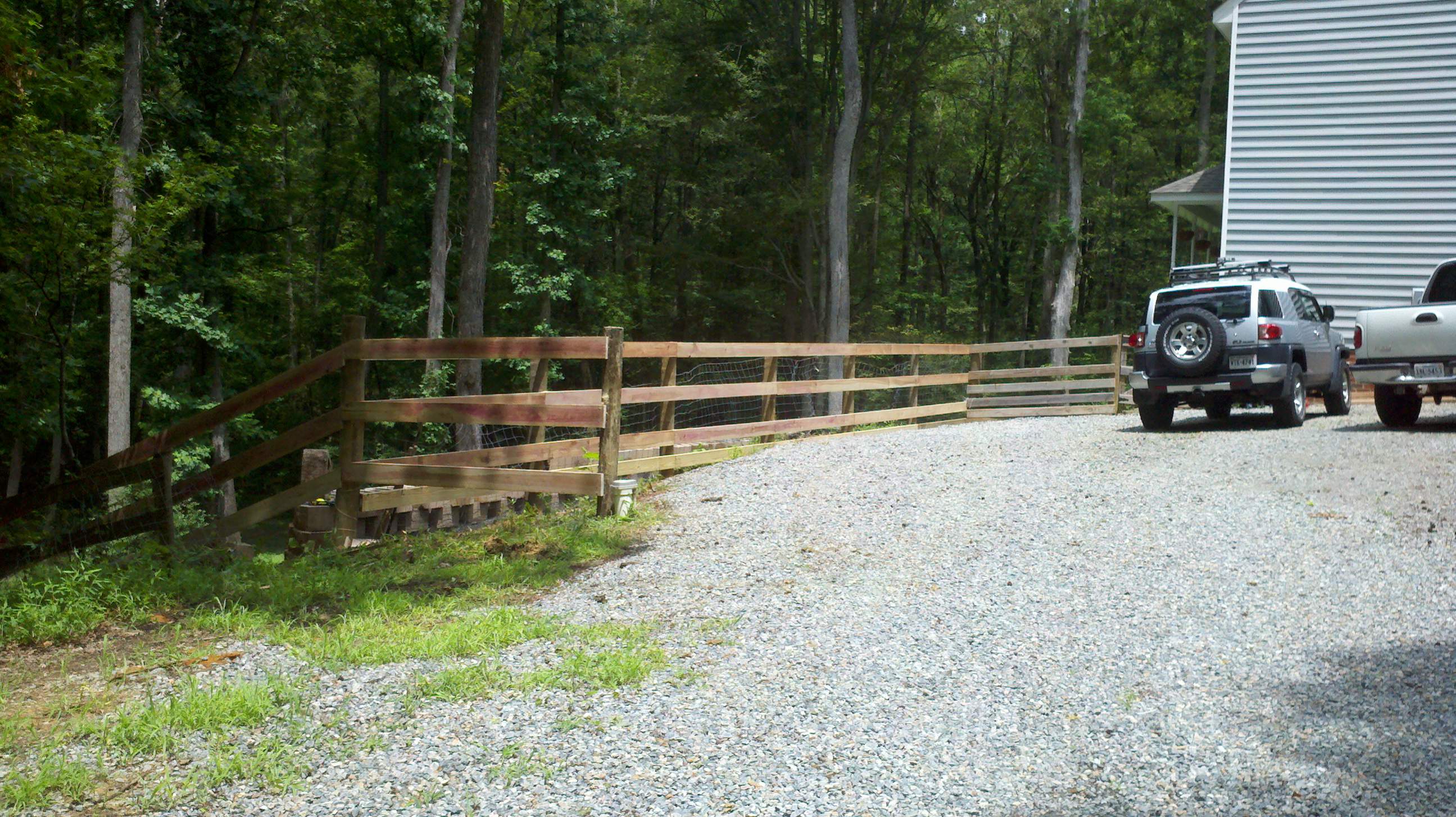

So here are the pictures of what I ended up with. I think it looks really good! I still have a few more areas to finish up (the end closest to the house and the gate) but it is definitely a huge improvement over the last fence I built. I guess with every project you learn a little more and improve a little bit. The spacing is 8' between posts along the length of the driveway, and then drops to 7.5' spacing as it drops down the hill. By taking out the 4' section that I was originally planning on, everything matched up beautifully and the final result looks great!
/ fence spacing question #14
Looks good. Seeing the photos, it make more sense with the small wall there. If you dont plan on a stain or other water proofing, you might want to at least put something on the top or the post to keep water out.
