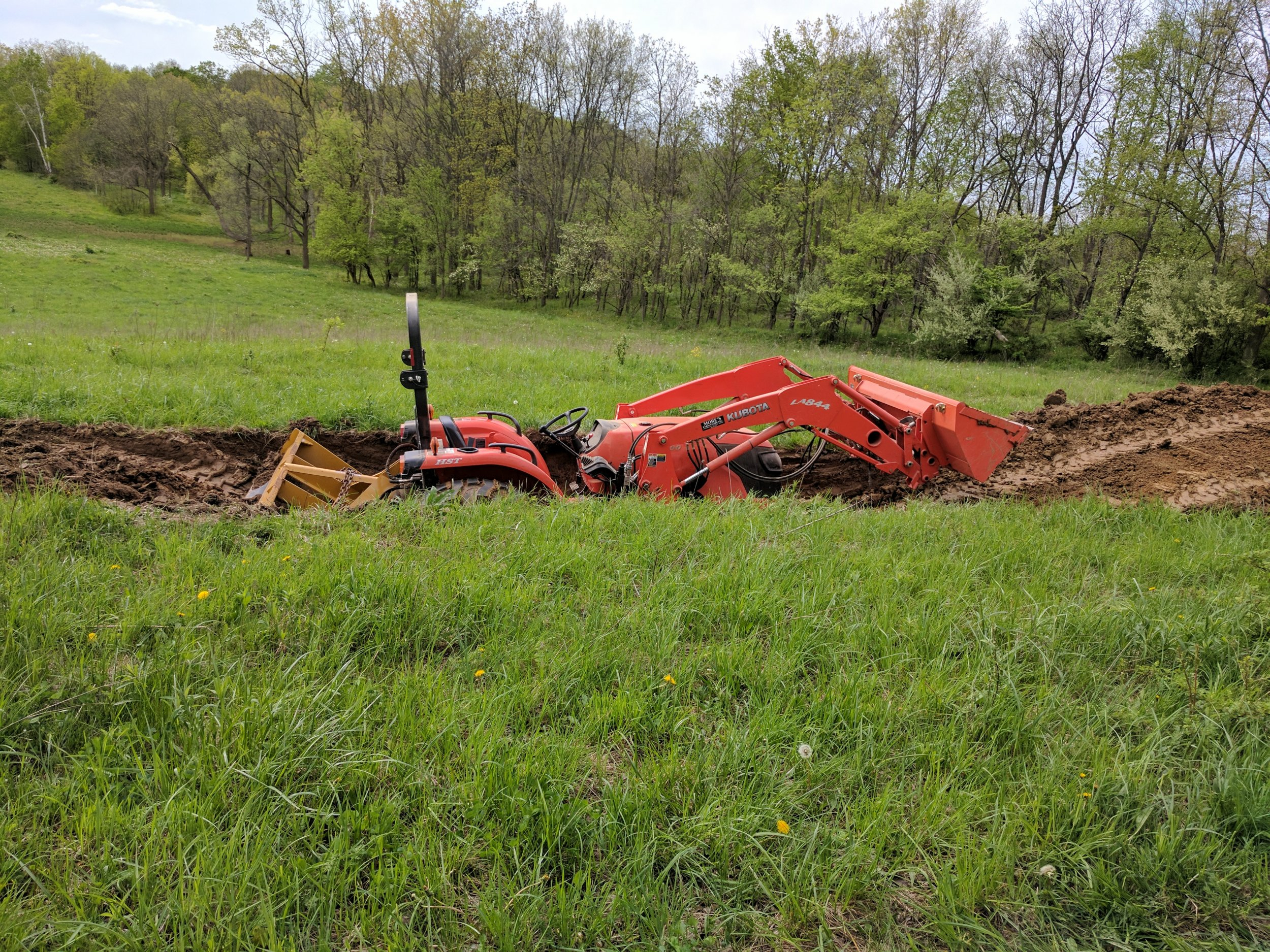

I dug a grave for a horse a while ago. 72" bucket width. 6' deep. Make sure you have extra weight on the front to get down-force & 4wd to back out of the hole. keep the ramp angle shallow. Necessity is the Mother of Invention. I also recently dug up a water line break with my bucket. In this case the bucket size gives you a hole big enough to stand for repairing the line and for getting to the exact location of the break.
