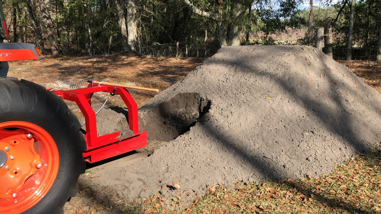

I attach a bucket attachment spade on my [AFFILIATE=1, nofollow=true, newwindow=true, title="Kubota"]Kubota[/AFFILIATE] L3400. That said, I'm very carful to make sure it's exactly centered on the FEL, and dig only when there's been a good rain and the earth is as soft as possible. I go in at a shallow angle from multiple directions, then more directly to break down the edges of the hole. This works fine. But I never try to plunge the thing in more vertically and then try to pry out a large chunk.

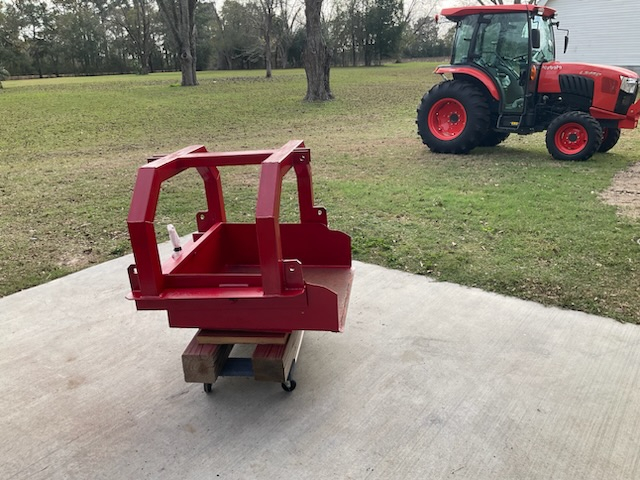

Pond scoop, or called a dirt scoop around here. I have one I bought slightly used at a farm equipment graveyard for $200. (no FEL here) Definitely old school and it has it’s limitations but works well once you figure out its quirks. Dig a trench or skim going forward or scoop from a pile in reverse. People ask “why not a FEL”. Well currently they are back ordered for about a year, cost $6000, and I don’t have much use for one, I mostly mow.

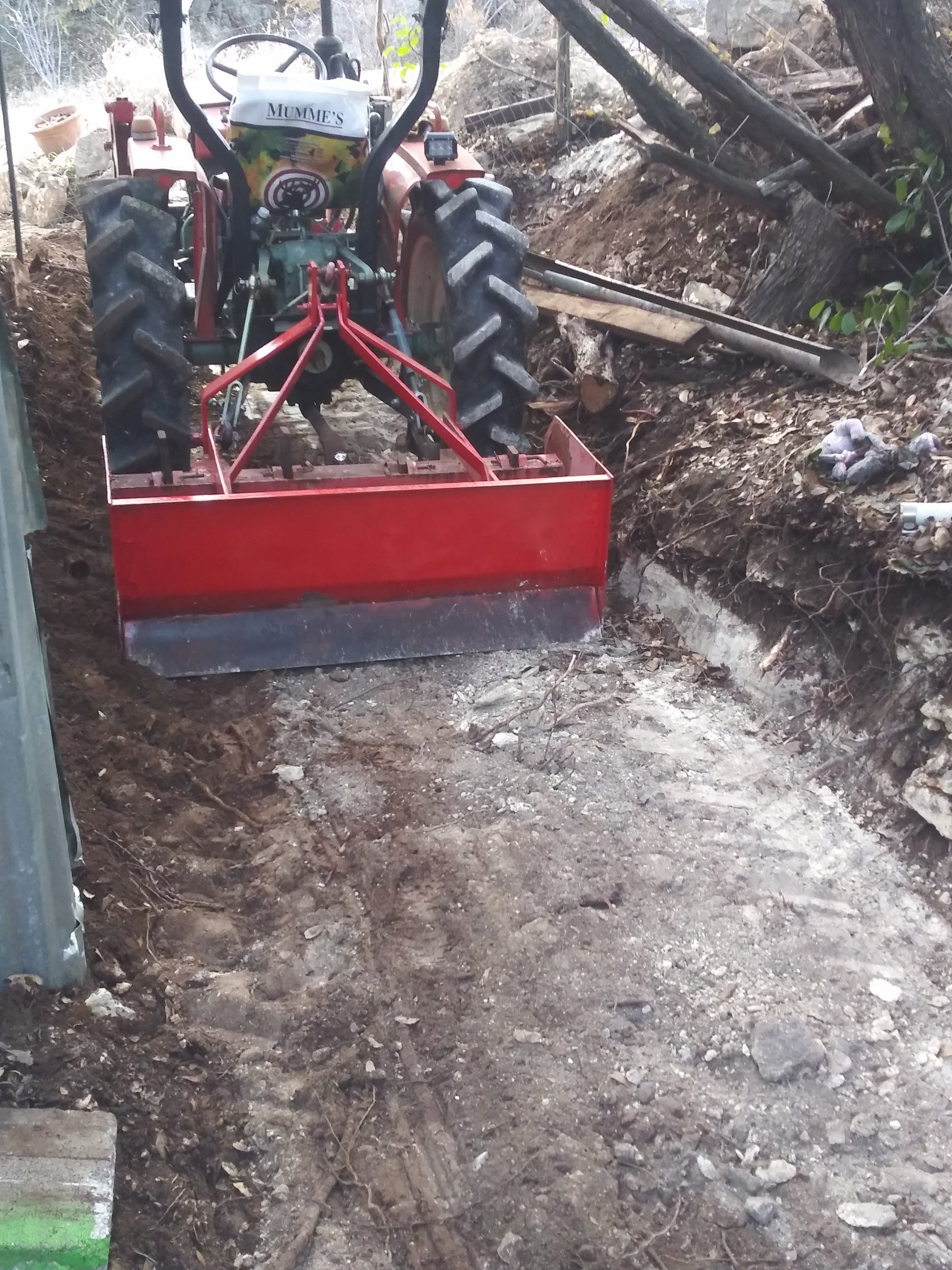

I can at least give you my experience. I bought a NH TC24DA with 60” FEL smooth edge bucket back in 2004. That tractor with FEL weighs something like 1500 lb. I typically used for mowing using a 60” MMM. In 2010, I went to build a 28’x48’ outbuilding and had decided to put in a 4’ deep perimeter foundation. Our soil in central IL is a little bit of black dirt sitting on feet of clay. Instead of renting a Backhoe or a small Excavator, I dug that footing and foundation with this little tractor, something I wouldn’t realize the damage from until almost a decade later. I’m an engineer and should’ve known better. I’m also frugal and decided to use the investment/tool I had sitting there! It had done the job, but in 2020, I was moving some loose material and all of a sudden the tractor quit moving and sank in the middle. Yep, the tractor had literally split in two. Now, in 2014, I bought a Cat 289D CTL to work forestry on some other property we have. That machine weighs nearly 12K lb. It has an 84” tooth bucket but the moral is that this machine is purpose built for digging virgin ground. A compact, utility, or ag four-wheeled tractor is not purpose built to use a FEL (regardless of edge) for the same. There are lots of good points in this chain, if you choose to still do so. Taking small/thin bites, pre-processing to break up if possible, etc. Using a tooth bucket just gives you a false sense of security IMHO. Again, all lessons learned…and I have worked for Cat for 26 years now so have seen my share of what happens when the wrong tool is used for the job 😁

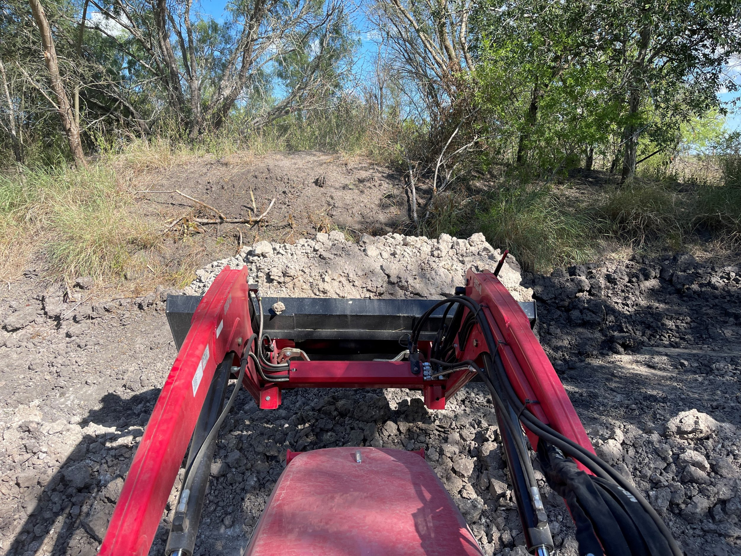

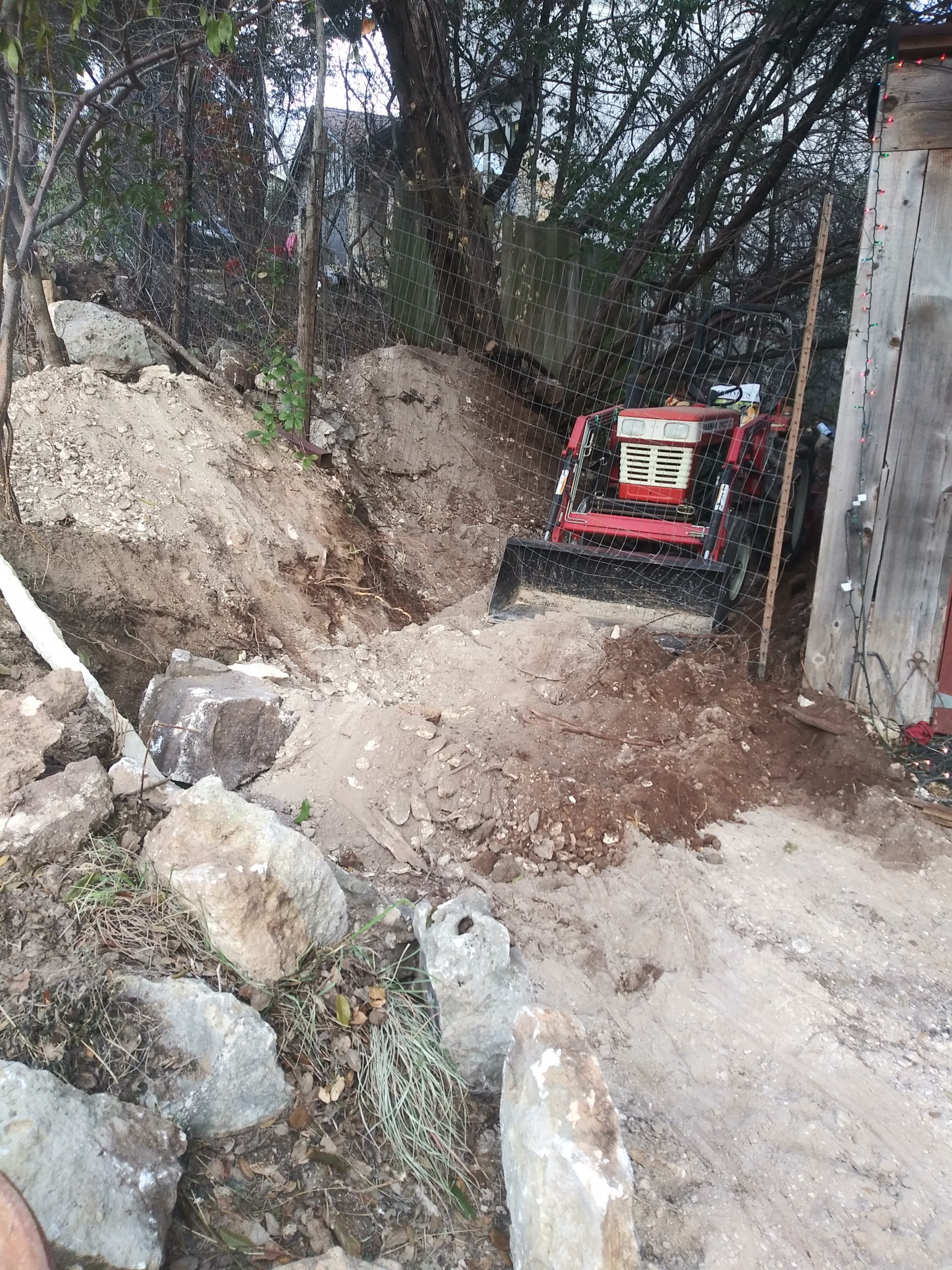

I just carved out a rock hillside with a light weight flat tooth bucket on a koyker 80. Went real slow and used the rippers when I could. Had very little space so bucket did most of the work.
Went slow but job is getting done. Just pushing along the top of the rock scraping a few inches at a time.
Might as well use it. If it breaks just fix it.
View attachment 778428View attachment 778429
Not sure on the Koyker 80, but on the K2 K3 and 200 +series FELs they designed the FEL to Tie into the rear axle with heavy supports, a large cross support in the middle where the FEL uprights are and then forward running supports that mount at the front of the tractor.
At least with This style of mounting, much of the stress/force is transferred to the rear axle and is spread out. These new tractors mostly ditched the design and mount mainly to engine side supports.
Koyker's older design May not be Pretty and limits engine access a bit, but if you are going to dig with a non industrial CUT chance of success is probably improved.
