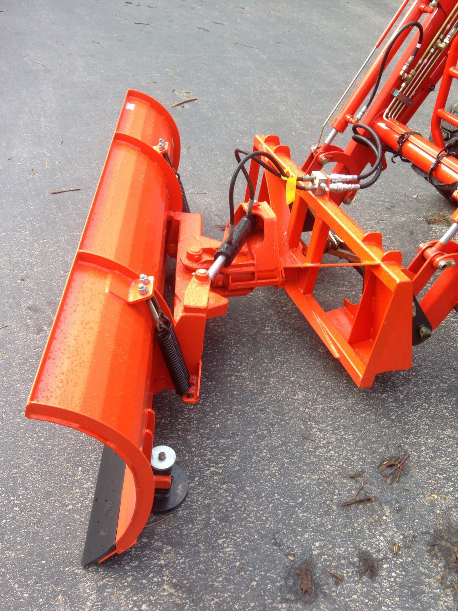

I'd want to see the trip mechanism - looks like the whole moldboard tips? And it looks pretty heavy - no spec listed. Is this for a skidsteer? Looks rugged.
Jim
/ FEL plow for Kioti DK45se #3
Jim
ditto on a "trip function" way to easy to find something under the snow. a trip function allows the blade to angle automatically when you hit something, vs destroying the blade or destroying what ever you hit.
The full moldboard does trip and it weighs 845# according to the information I was given when I called. It is made for a skid steer, which will fit my tractor as it has the universal skid steer attachment on the loader. Any and all opinions are appreciated.
/ FEL plow for Kioti DK45se #5

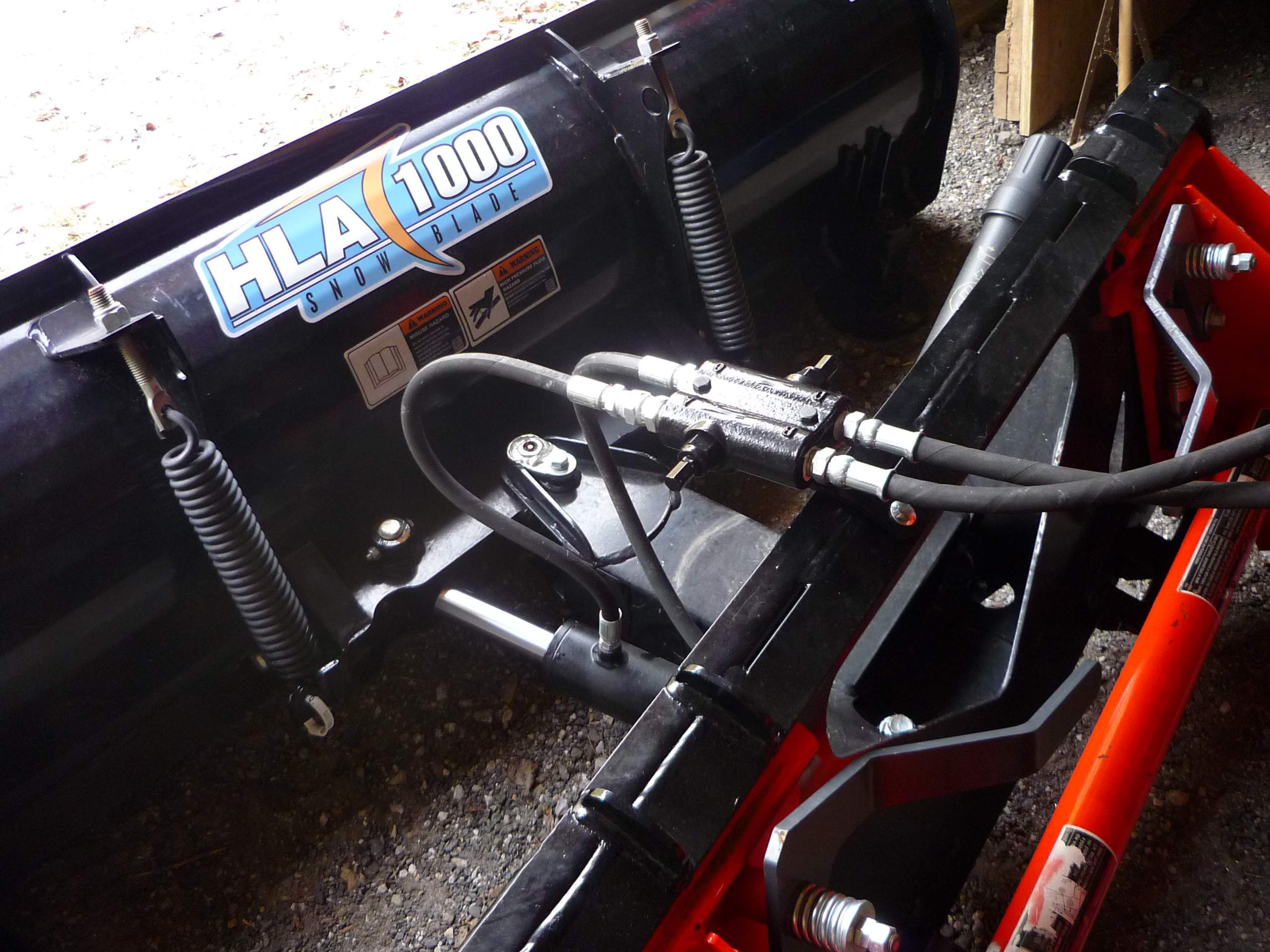

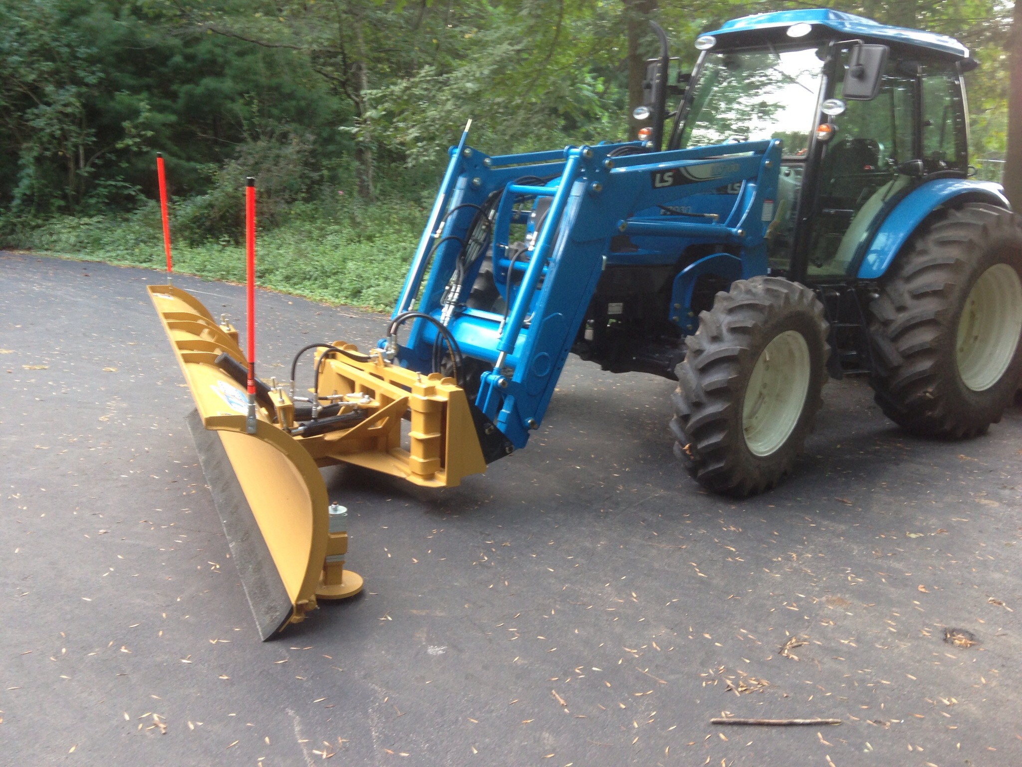

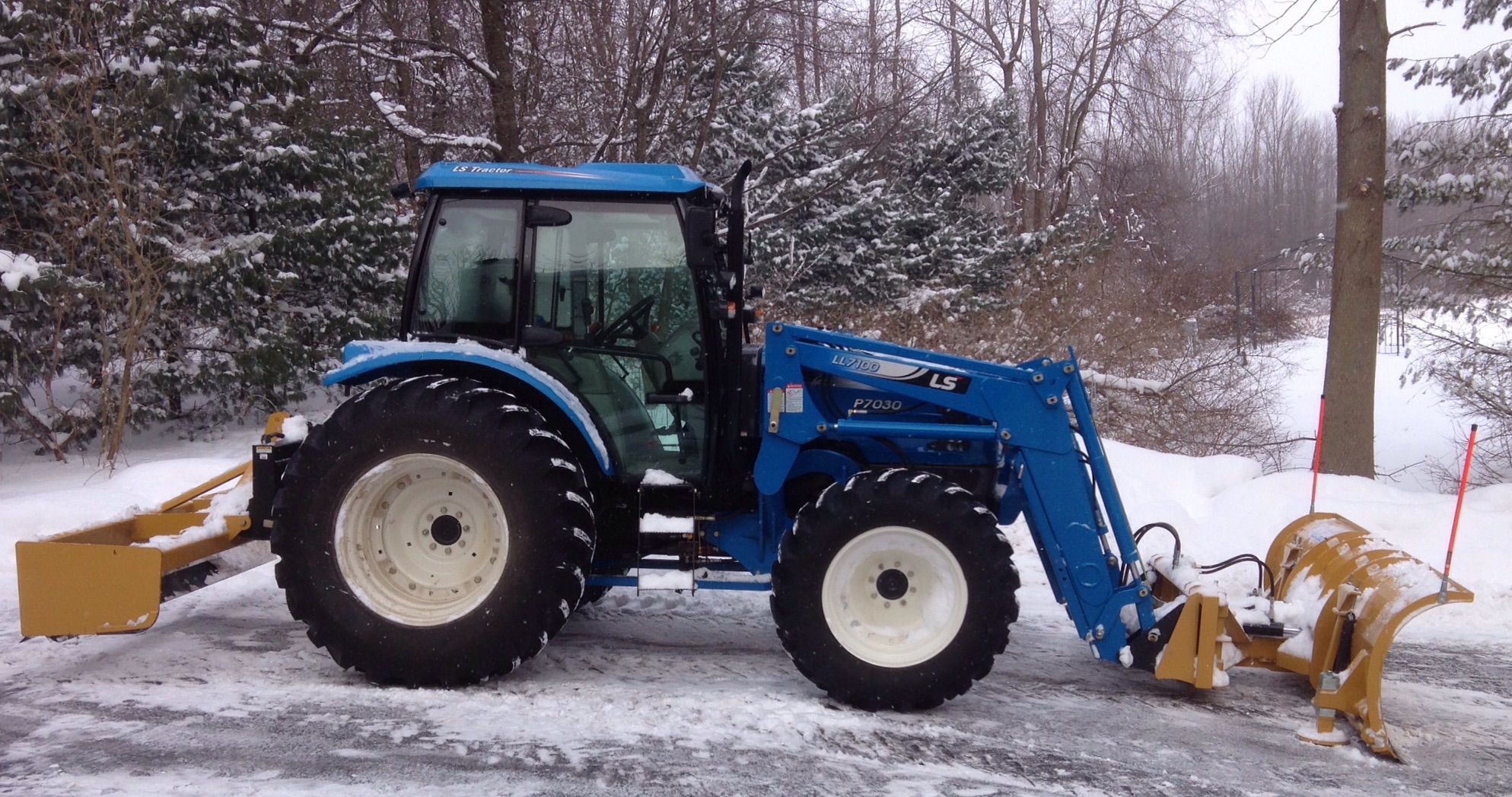

Look for a true plow blade, that one you linked to is a pusher, not a plow. A real plow will roll snow up and outwards from the blade, that one won't. At best it will just slide off the side and push the front of your tractor around. Check out the HLA blades, they are true plows. I had a 2000 series on my Kioti and have a 3000 series on my LS.
HLA Snow
/ FEL plow for Kioti DK45se #6

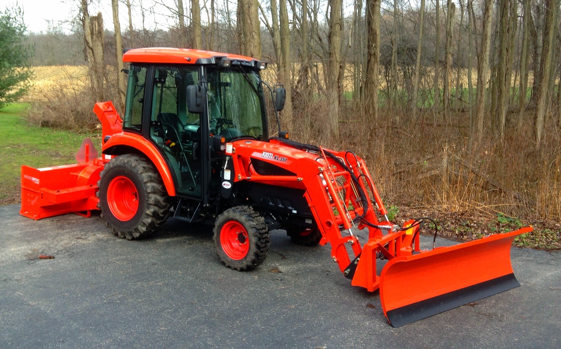

I like the HLA plows too. Check them out. They are made in Ontario, by a company that knows how to move snow. Notice my avatar... The pricing seemed very competitive, unless you can find what you want used, which while not impossible, may require some luck. (seeing those cabbed tractors with fine plow set-ups in the snow makes me yearn for a cab. But it won't work for me the rest of the year...)
