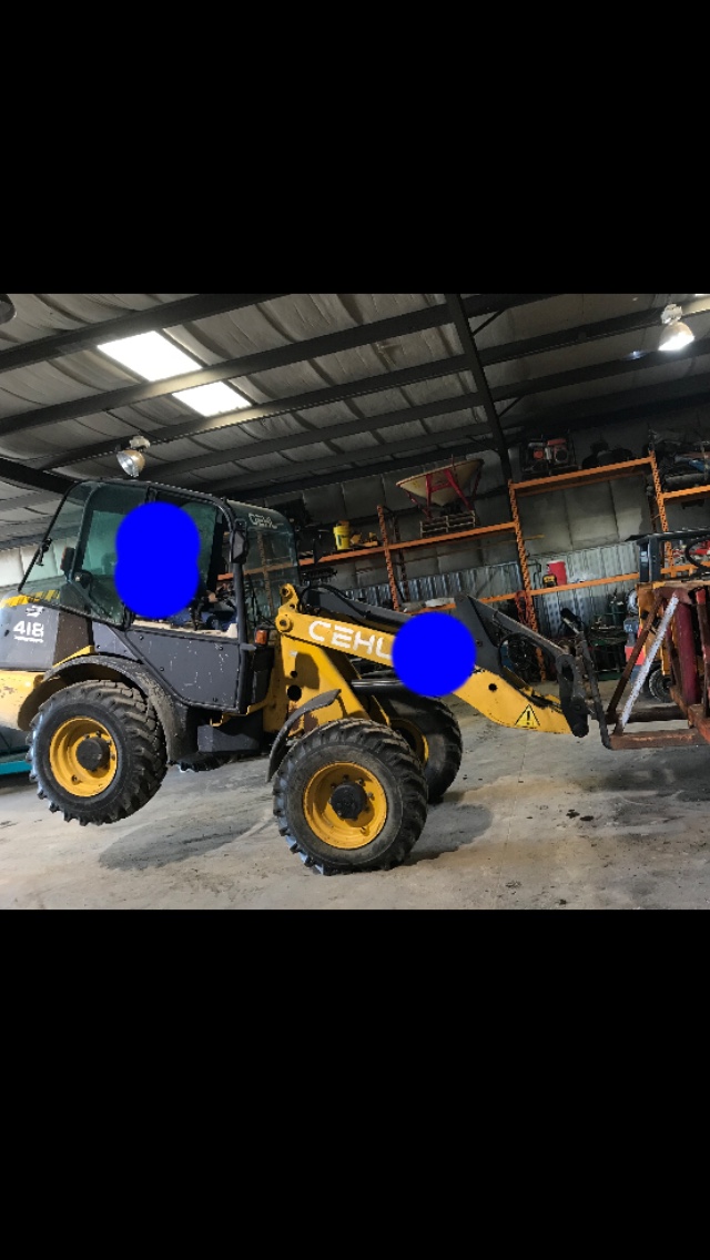

I haven’t read this whole thread but I’ve read at least a dozen before. It takes a substantial amount of weight on the back to lighten the front axle load. Anyone who thinks adding something simple like a box blade is saving the front axel is wrong. My tractor loader still has the hydraulics to lift the back end off the ground with loaded tires and a box blade. It doesn’t take a genius to see the base tractor weight plus 1000 pound is harder on the front end than just the base tractor weight. I’ve done at least 2 small scale demonstrations with a plastic loader.

Here’s a picture a buddy send me. I’m sure if he had another 1000 pounds of counter weight and was actually able to lift the load the front axle load would be less, right? IMG_4615.JPG

Any weight behind the rear axle moves the center of gravity rearward on the tractor, reducing front end weight. JCoon is only right IF and WHEN the rear axle comes off the ground from lifting too much. BUT! If you have sufficient rear ballast, the rear NEVER comes off the ground before the relief valve hits, thus, reducing front end stress. It's that simple.
