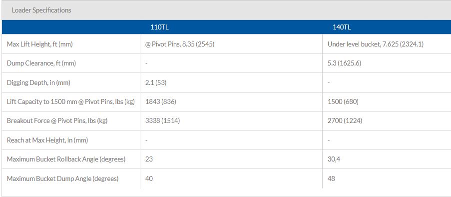

What we're talking about is how specs can be advertised vs real world performance and the confusion that can cause comparing spec sheets. Attached are NH loader specs for example. IF you had the 110TL loader and read those specs you'd think "I can lift 1843 lbs". But since that's at the pivot pins and to a ~5' height, someone needing to lift a 1700lbs pallet and put it on a 7' high rack might read that and think 110TL loader can do it. In reality, it might not since that weight would be centered a couple feet beyond the pins and needing to go a couple feet higher. However a competing model may only say it can lift 1700 lbs, but that number is taken at full height and 500mm forward of the pins, so even though it is rated "lower capacity" by the spec sheets it is actually more capable of performing the task.

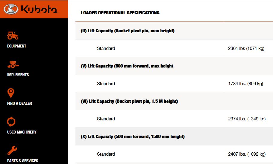

Also attached is example from Kubota LA1055 loader specs - it is an excellent example and from it you can really gauge what the machine can do vs something like mine that only give X lbs at max height at pivot pins and breakout force - leaving you to guess what you really could do with a load.
