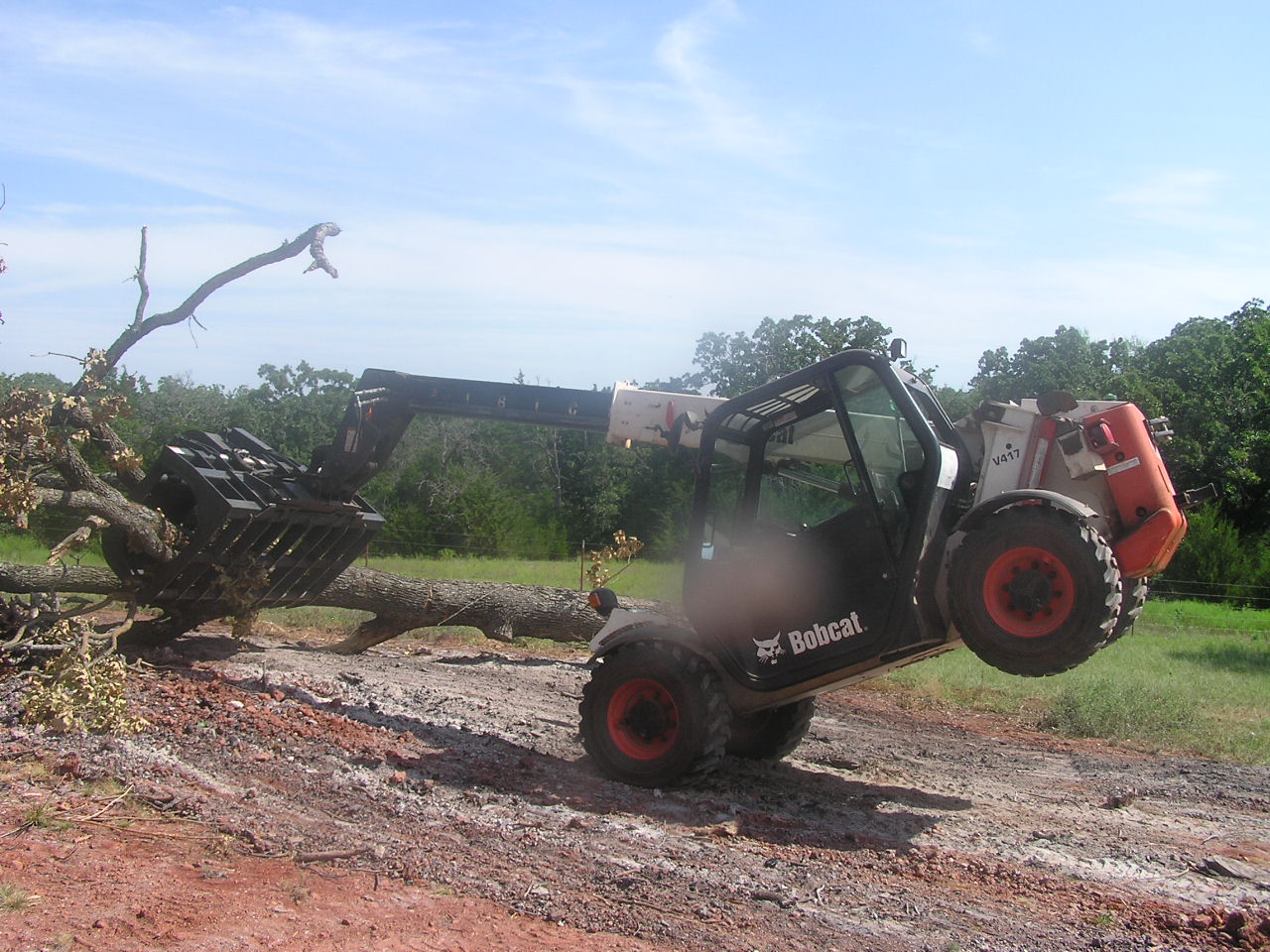

Xfaxman - takes some cojones to climb out of your rig - just to take your own tipping factor picture. The tree on the ground - the boom firmly gripping the tree - all this must provide a fairly good deterrent to the unit pivoting on the front axel/wheels and going down - - right?? I wonder - can the Bobcat even pivot on its front - like a tractor.
I've had my previous tractor in that exact same position - only it was due to a heavy load of wet sand in the FEL bucket. I dropped the a** end of the tractor so fast, it bounced at touch down. The entire tractor was starting to pivot and "fall off" to the right hand side. Felt like the rear tires were three feet off the ground. However - in retrospect - I'm sure they were on six inches off the ground.
Got off the tractor - only time in my entire life - - my knees were actually knocking together. I'm not ashamed to say - I was scared.
/ FEL Lift capacity #26
Not really, it is very stable with the rear end up in the air.
I wonder - can the Bobcat even pivot on its front - like a tractor?
No only the rear pivots:
This shows max body lean with the rear axle against the stop:
Here is one rear tire off the ground:

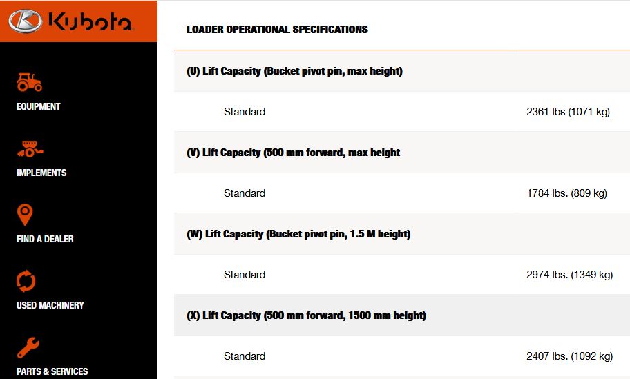

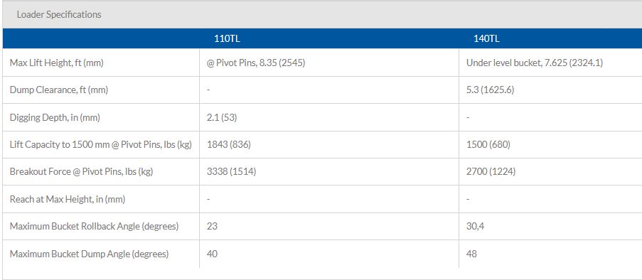

That video made me laugh. That guy really ought to be careful. Especially when he says with ballast" this baby will lift well over 2000#".
That PDF is a good explanation of how things are measured.
Look at the breakout force, and lift to 1.5m specs. Because between those two is where most of us run the loaders 90% of the time anyway
