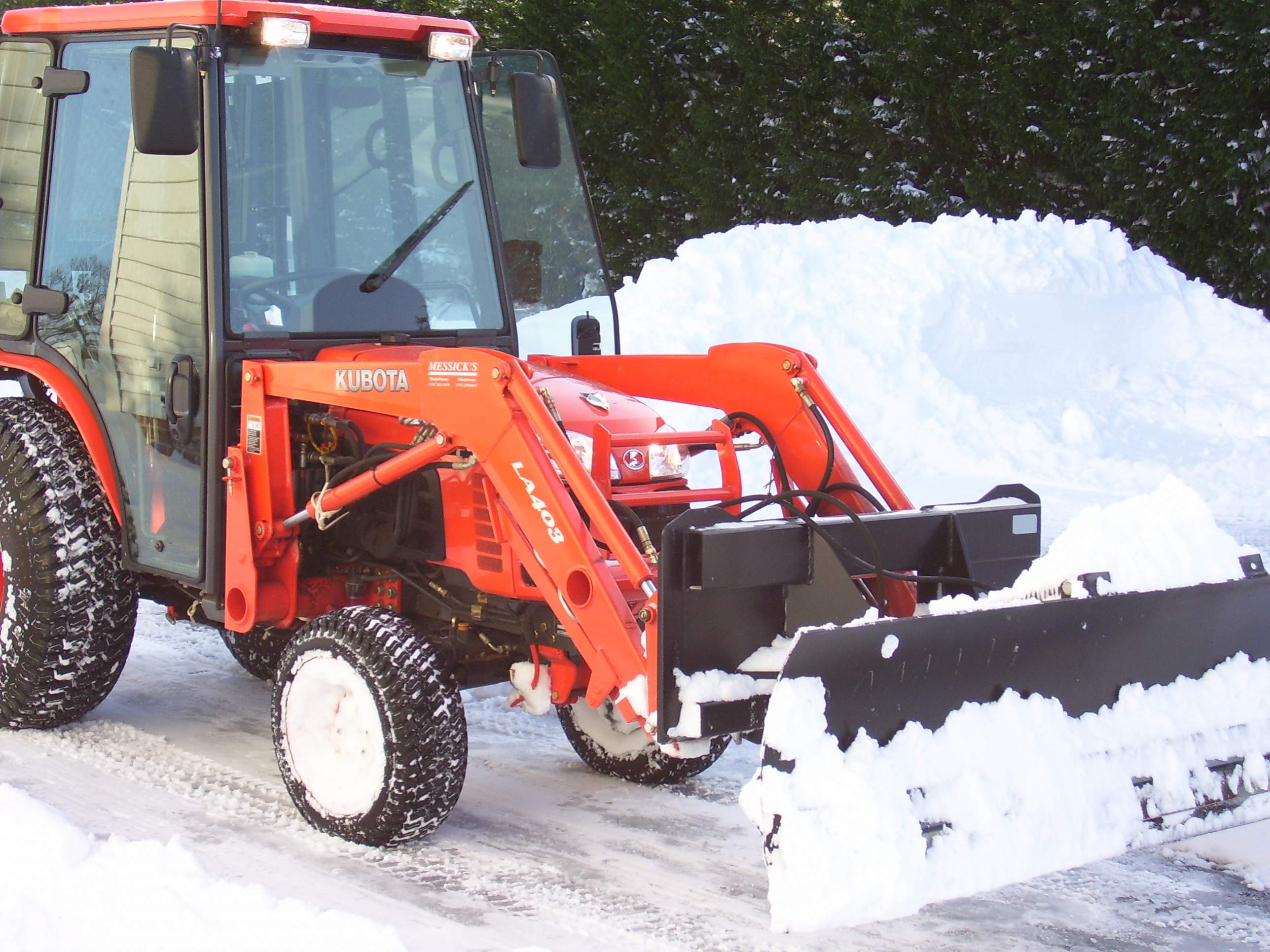

Lots of forums here that have the information you want..from snow plows mounted to the bucket ,quick attach plates(remove bucket),sub-frame mounted front blades.I had a sub-frame mounted snow plow on one tractor:worked well but you lose the Front End Loader(at least the tractor I had),I currently have a Curtis snow plow attached to my FEL (QA plate) works very well for me.I can change from bucket to plow in minutes.

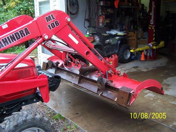

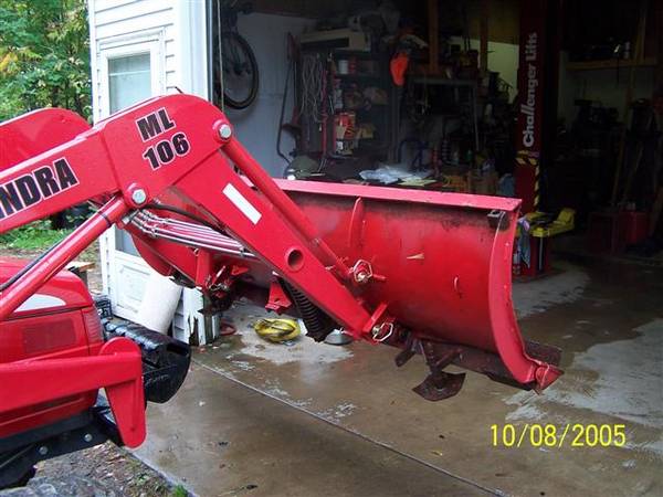

I changed the bucket pins on mine to 1" pull pins. That way I can take my bucket off and attach an old 7' plow blade to my loader arms. I don't have angle power angle so can only straight blade but it works for me. Later in the season when I need to move snow I put the bucket back on.
Just an FYI, Syracuse, NY averages about 100- 114" of snow per season according to several websites. I live 20 mi. north of Syracuse in the snow belt east - southeast of Lake Ontario. We average between 135-150" per season which is why most people I know have 4x4's and / or tractors. 15 - 20 miles north of me (or due east of Ontario in the heart of the snow belt) you can add 20-30" more snow per year.

I live about a 100 miles North,worked in that area for ten years;they measure snow in feet.:D I also have a FEL mounted plow,8ft. Curtis with power angle...tractor weighs 6500lbs.
