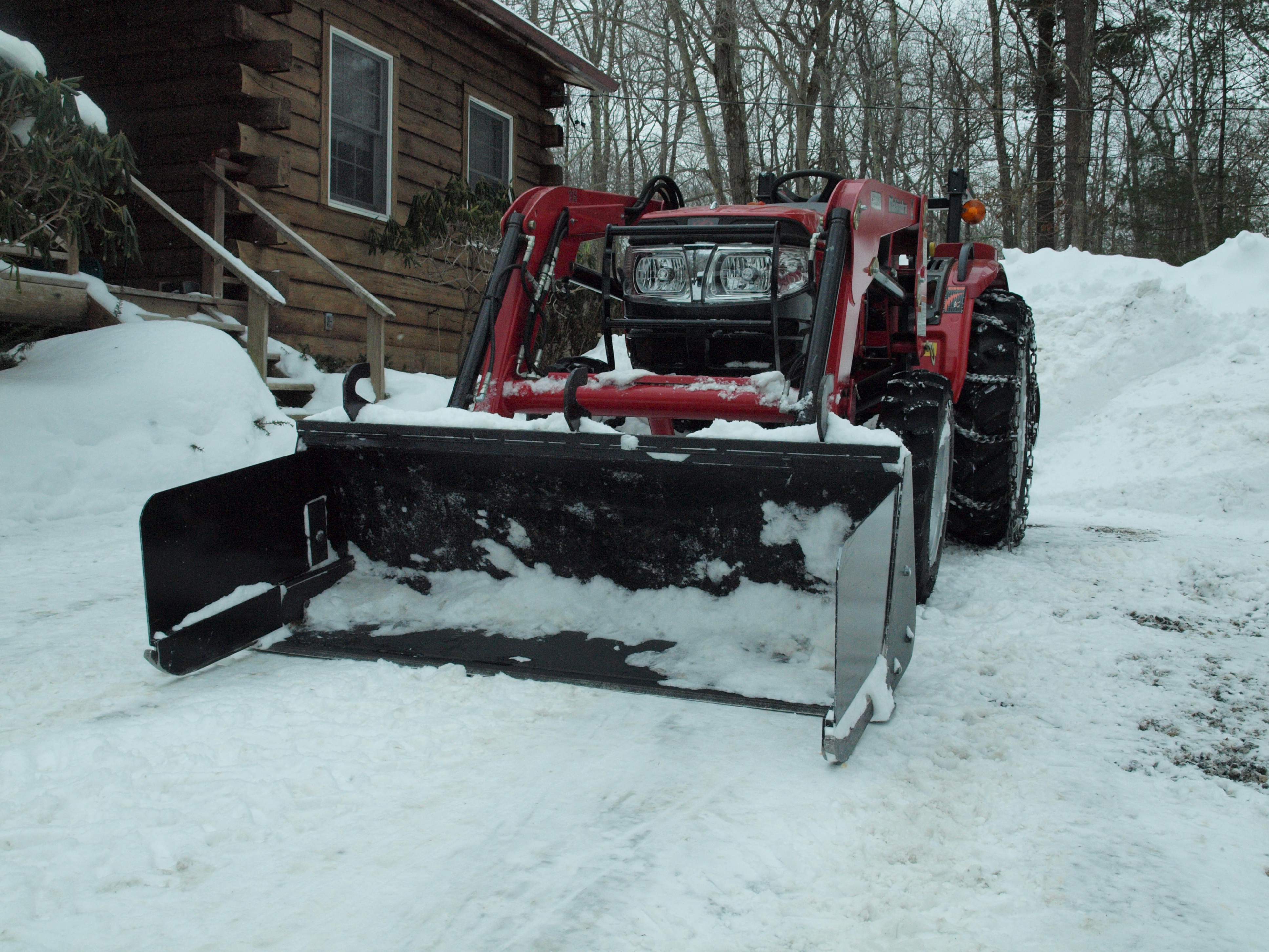

I've done my drive and landing (about 200' worth) and all gravel with a fel and rear scraper blade. I added sides to the bucket and cut the time dramatically. Long drives would be better served with a plow and what my rear blade acts like. I have done a 1/2 mile drive once for a 15" dump with the rear scraper . It was a pain. For a deeper dump, one is better served with the fel first and to clean up with the rear blade.
