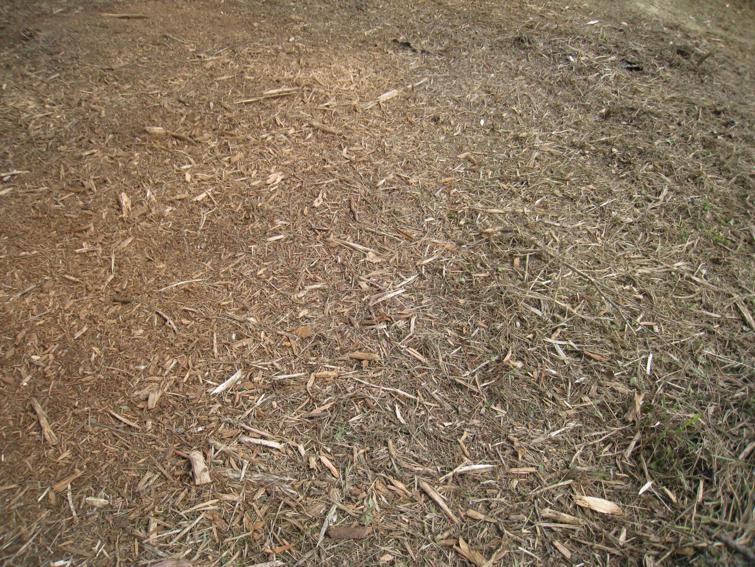

First off if you havn't ever ran a foresrty mulcher wouldn't recommend doing it yourself. Pay someone who is in this line of work, Depending on how thick the 40 acres is you'll probably spend more renting a skid steer with a head verse getting someone in there with a purpose built machine. Trust me skid steers aren't ment to be in this line of work 100% of the time. On average I can clear 1-11/2 acres a day in 6in. to 8in. trees any thinner progress just picks up have done 5 acres in a day but small 2in. brush, an this is making it look like a park when i finish you could take a lawn more over it. So go got to figure out wat you want it to look like want it to look good I can tell you now don't expect anything over 4 to 5 acres a day, unless your cutting grass. So 40/5 =8 on a good note times rental a day verse somone with a machine built for the task of clearing acres I think you'll find it will be cheaper in the long run to have a larger machine come in.
Because you want it to look like this a not like a bomb went off on your land cause it takes some getting use to. just my two cents:D
