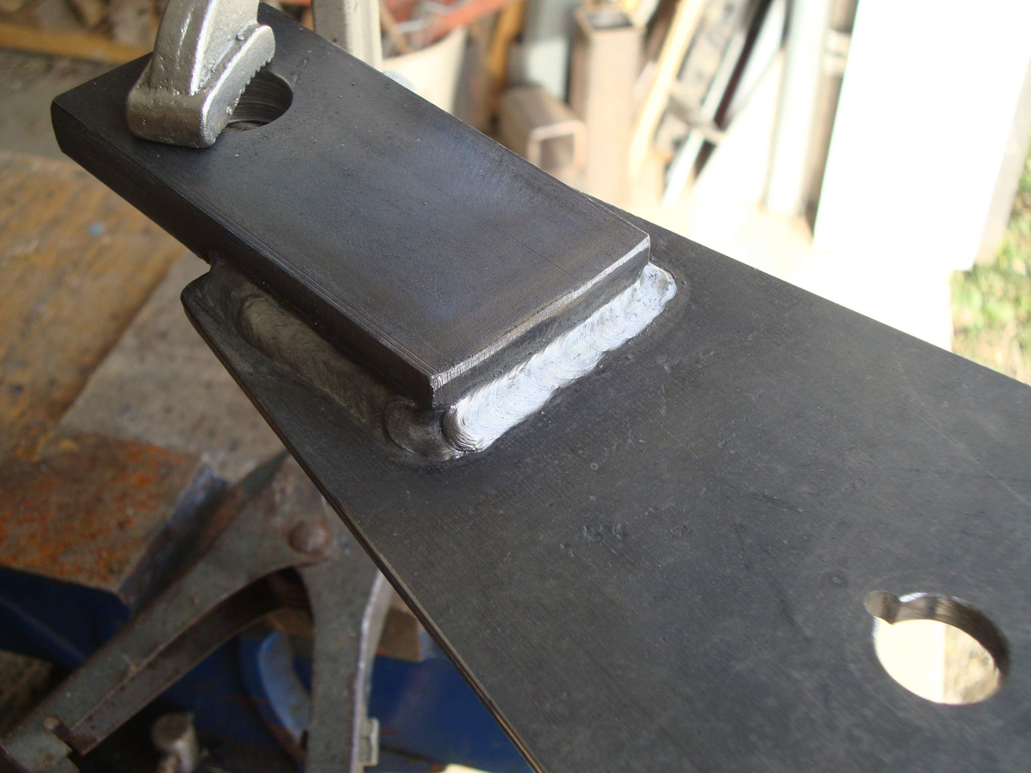

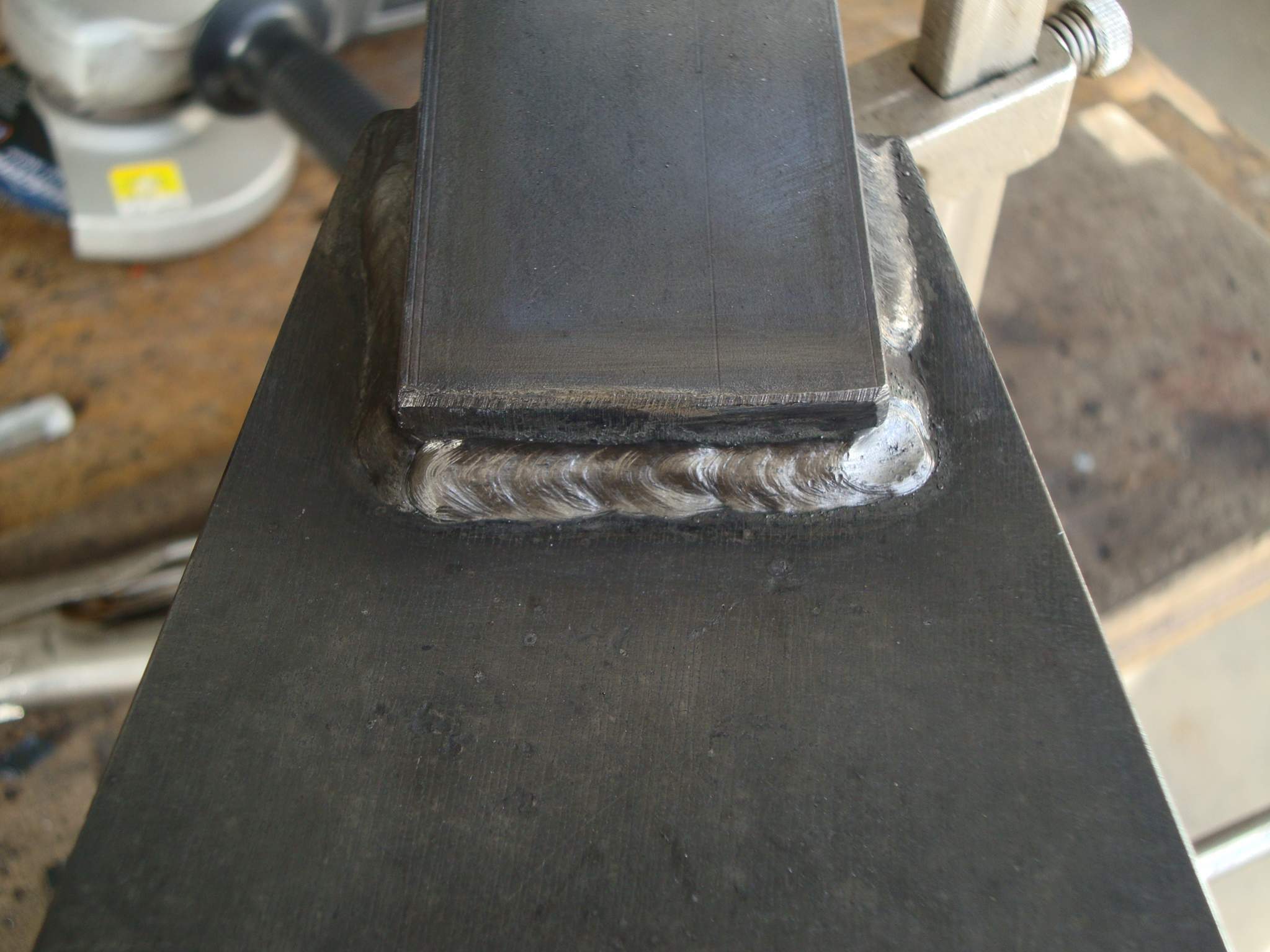

These are from today, using 1/8" 7014 @ 120 amps DCEP. One piece is 1/2", the other is 1/4" plate, part of a snatch block project I'm working on. 120 amps is what the welder says, it may be actually a little higher or lower.

Looks good Sean:thumbsup:

Those do look nice!:thumbsup:
I'm sure you could give a rat's azz less about my opinion, but I'll give it to ya anyway:D. I try to never to stop on the corner like that, I would much rather stop in the center of a weld zone. It's a structural thing!;)

Very nice.:thumbsup: I dont think those are going to be comming back appart:thumbsup:
I seem to be one of only a few that like 7014 around here. Why was that your choice if you dont mind my asking?
Are you going to leave it with a single pass of 7014 or did you cover a 6011 (6010) root pass.
My experience is that snatch blocks endure a tremendous amount of force. It would be tempting to put at least a couple more passes on it.

I am a pretty darn good welder and I try to never put just one pass on anything structural. I would have put one light 6010 root, then at least a 2 bead cap with 7018 rather than one large single pass. From the photo, it appears that he as at least a solid 1/4" fillet weld and the bottom plate is stated as 1/4" thick so more weld will not do anything for strength. The 1/4" fillet all around is sufficient for the thickness of plate it is welded too.
I am not a fan of 7014 or 7024. I think they make very pretty welds even for a beginner but I found them to be easily broken. I have to admit that I havent used them since 1974 when I worked briefly in a shop making wire pulling equipment for high lines. The shop foreman loved the 7014 because it was pretty and easy to weld with. I remember once that the shop foreman was fitting up a 1" thick lug and my brother in law (also a very good welder) had welded it out with 3 full passes all the way around with 1/8" 7014 rod. The foreman realized then that it was not located in the right spot. My BIL took a 4 pound shop hammer and hit it twice and it broke clean and sailed across the shop. The weld was solid with no slag or porosity in it, just a brittle weld. I have not used it ever again in my career as a welder. Did use some 7024 jetrod a few times on heavy structural steel, didnt like the way they ran. You could weld a long flat weld bead and everything look good when welding, but chip off the slag and it would be hollow in the middle with nothing but slag and a weld bead on each side. I will stick with my 7018.
I just finished welding up some stabilizer pads on a JD 310 backhoe that my barn addition contractor has. Three or the 4 inside tips were broken off and I rebuilt them with some weld metal build up and two with addition of flat bar. One got slightly warped in welding and I had to adjust it with a 16# hammer. The weld held without any indication of cracking on the cast steel pad. Next I am going to weld some cleats to the smooth bottom to keep the pads from sliding. Gonna use some more 7018. Hopefully he likes the work and wont charge me for the little extra's I am putting in on the shop addition. This saved him $600 for new ones.

There is enough contact are that I doubt it could ever come apart. The welds and surrounding surfaces look so clean it almost looks like mig
But 120 amps with 1/8" rod on 1/2" plate seems low to me, part of the weld looks like good penetration but some does not. This is assuming it's a single pass? like I said though even subjected to abuse I don't think it would fail, due the total amount of surface area welded.
If that were me with 1/8" 7018, I would probably be somewhere close to 140-150 amps, then you will see the penetration.
Like you mentioned though we are never sure how accurate our dials are, I actually do suspect mine reads higher than actual. That or my old welder read lower, cause they definitely don't corelate.

I have 7014, 7018, and 6011 on hand, I normally use the 7014 for clean, new material. The 6011 gets used if I can't get it clean, and the 7018 for higher carbon stuff.
I like the way the 7018 welds, but I find it finicky for re-starts and having to keep it dry is a nuisance. I used it for a while, but I usually pick 7014 most days.
The 7014 practically runs by itself, I find the 1/8 rod works really well with my old AC/DC Sears machine for some reason.
Just an amateur's opinion,
JB
I'm another amateur welder, so don't feel like you're alone here ;) Thanks for the compliment about MIG, I wish my MIG welds turned out like these.
According to ProStar's application chart, the 1/8 7014 is designed for 100-150 amps, with 120 being optimum. Their 1/8 7018 can be run over a slightly wider range from 90-160 amps, again with 120 as optimum.
I may be wrong in my thinking, but I usually try to set my current to run the particular type and size of rod I'm using.
I look more at the toes of the weld to see if I'm getting good penetration, to me high toes mean the weld is cold. Undercut and excessive spatter/glowing rods means too much heat on the other side of the equation.
I choose the rod size based on material thickness. I try to use 3/32 for anything under 1/4 inch steel, and 1/8 for anything heavier. My welder is limited at 140 amps, so material prep and multiple passes has to take place on heavier stuff. Not much call for me to weld anything over 1/2 inch plate.
As an example, if I try to run 1/8 rods on 1/8 plate, in order to make them run well the current setting is high enough that I have trouble with burn-through. 3/32 works a lot better for me on thin stock.
I'd sooner match the rod to the material and run it at the right heat for it to work well.
I've almost stopped "weaving" welds these days, unless it's non-critical and I've got a big space to fill in. Weaving hides a lot of sins IMO. Running a slower hotter puddle and letting it do the work seems to be working better.
