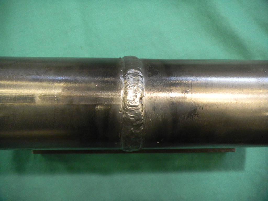

I havnt even thrown out the box of 1/16 inch 6013 rods. I had first tried welding some 1/16 inch wall box with 3/32 6011. It didnt work well.... I decided to try the thin 6013s because I really didnt want to gas weld it. No matter what I did they would not make a good joint. They would either only make a bead on one piece, or they would make a bead on both pieces with a bead of slag in between. It also didnt help that they are too thin for my shortstub to really grab onto. Kind of have to wedge them in at an angle....
/ favourite stick rod #67
First time I tried 6013 was an impulse buy at Lowes, Lincoln 6013 5lb box. These rods were horrible! No matter what machine I ran them on they got colder the further the rod burned down:confused2:. It didn't take long for me to figure out I had to really lay the rod angle over, and run them hot. I recently bought some Forney 6013, I like them a lot better.
This.
Crank up the heat.

What are you welding on???? Sounds like arc blow!
I was doing some t-joints with 1/16 wall 2x4 box. I am building a shop press/weld bend tester. And it didnt seem at all like arc blow, it just would not weld right. These were the lincoln 6013s. The air liquide brand ones and the powerfist ones from princess auto seem to work much better.
/ favourite stick rod #70
Don't you have an AC only machine?
AC is the number one killer of arc blow, that an aluminum Tig welding is all AC is good for! :D
