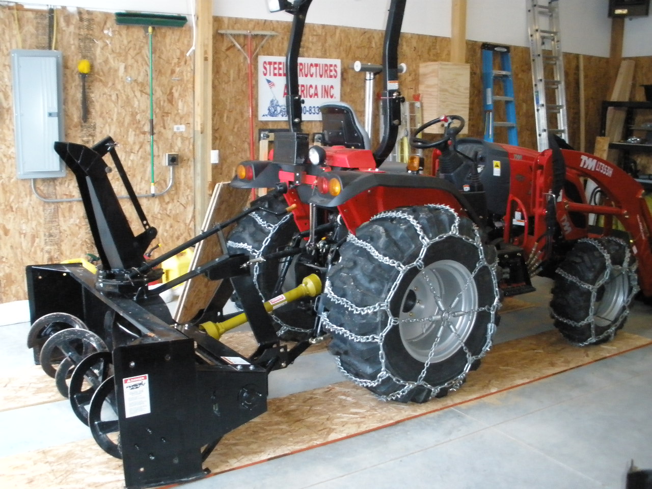

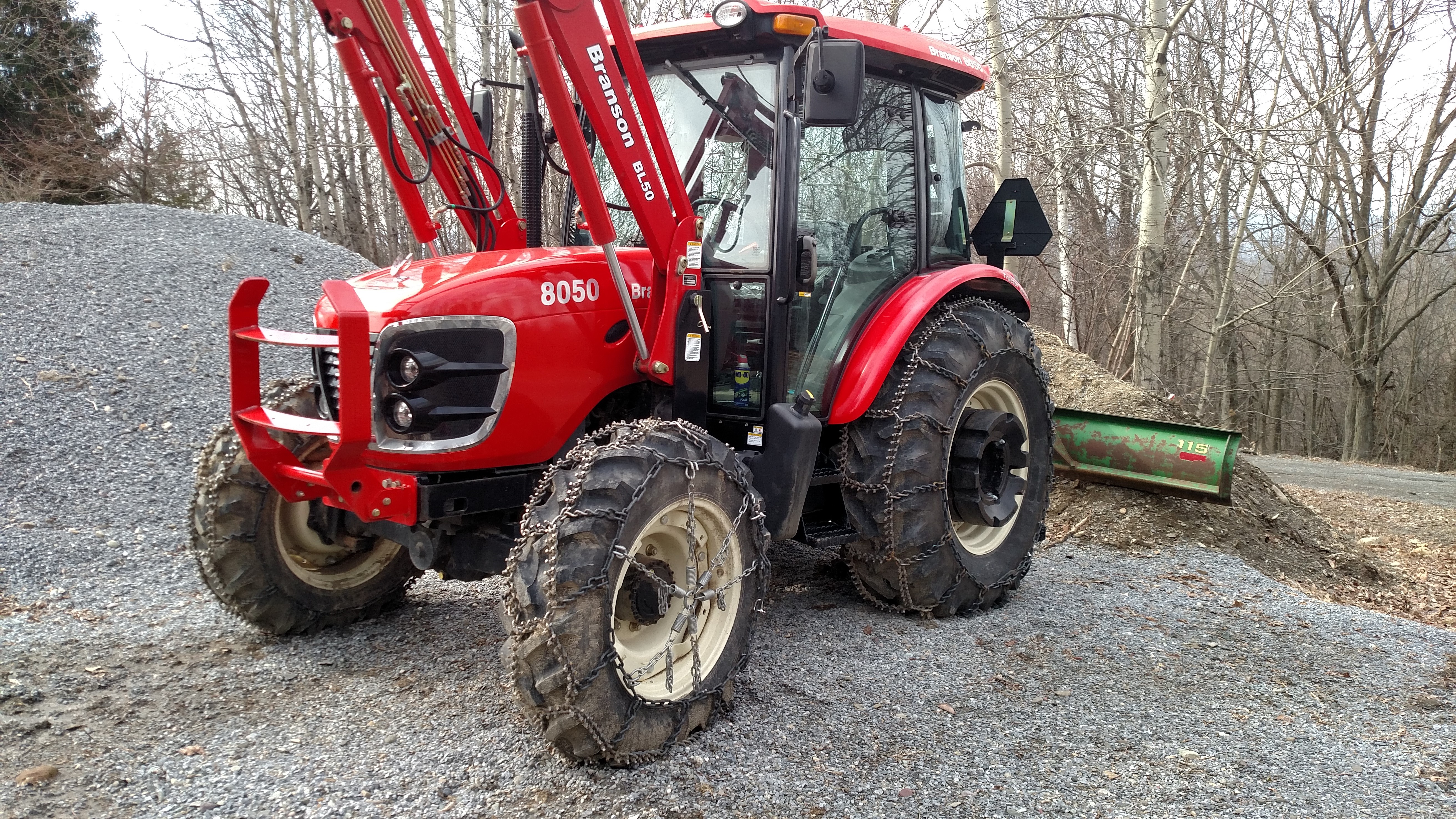

I found a local dealer for mine, but they seem to come and go. I use the euro studded chains they are more expensive but they work so much better then any other style. IH 574 chains.jpg Branson chains.jpg
The traction and ride quality is amazing, they are the best you can get for a tractor unless you are strictly going into the woods and use skidder ring type.
The duo grip type are almost as poor riding as the old double ring type every time that top link hits hard ground it is link running over a bump, so it's bumpity bump all the time.

I personally use the chain tensioners on my rear tires and rubber tensioners on the front. When I got my chains from Tirechains.com I also received a binder type tool to help install the tensioners. I like to put my chains on snug so there is no slop that might hit on anything. Others here on this site run their chains loose it's personal preference I guess. PC050154.JPG

A lot of people use tensioners but I never have on my tractor or my pickup. I have found that if I take the time to tighten them properly, they won't be a problem. All that I had was a set of ladder truck chains for my last tractor, which were a bit too narrow. I worked the crosslinks over my bars instead of between them and tightened; once I learned which link they needed to be hooked onto I never had a problem. A pair of pliers works well to hook the fastener down.
