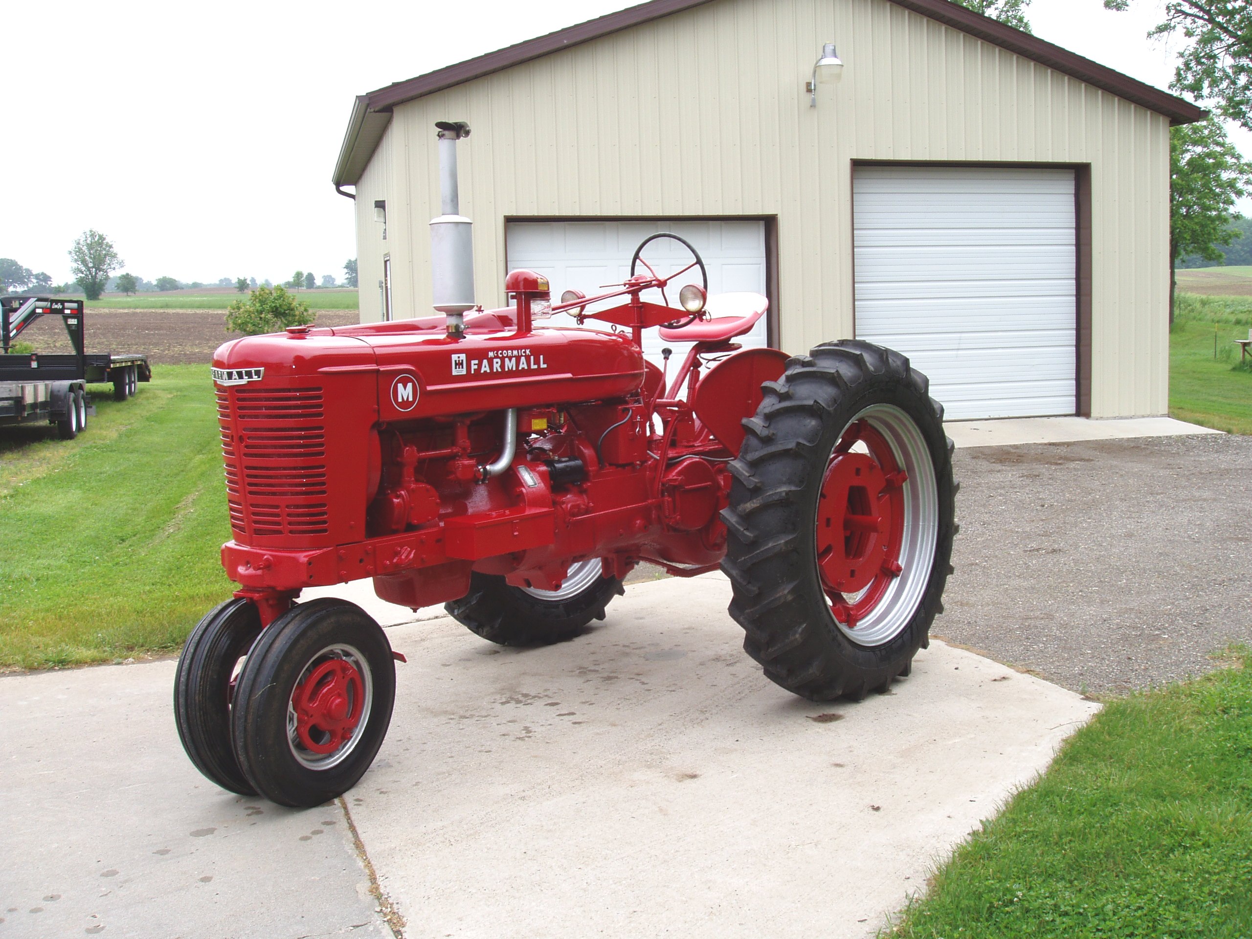

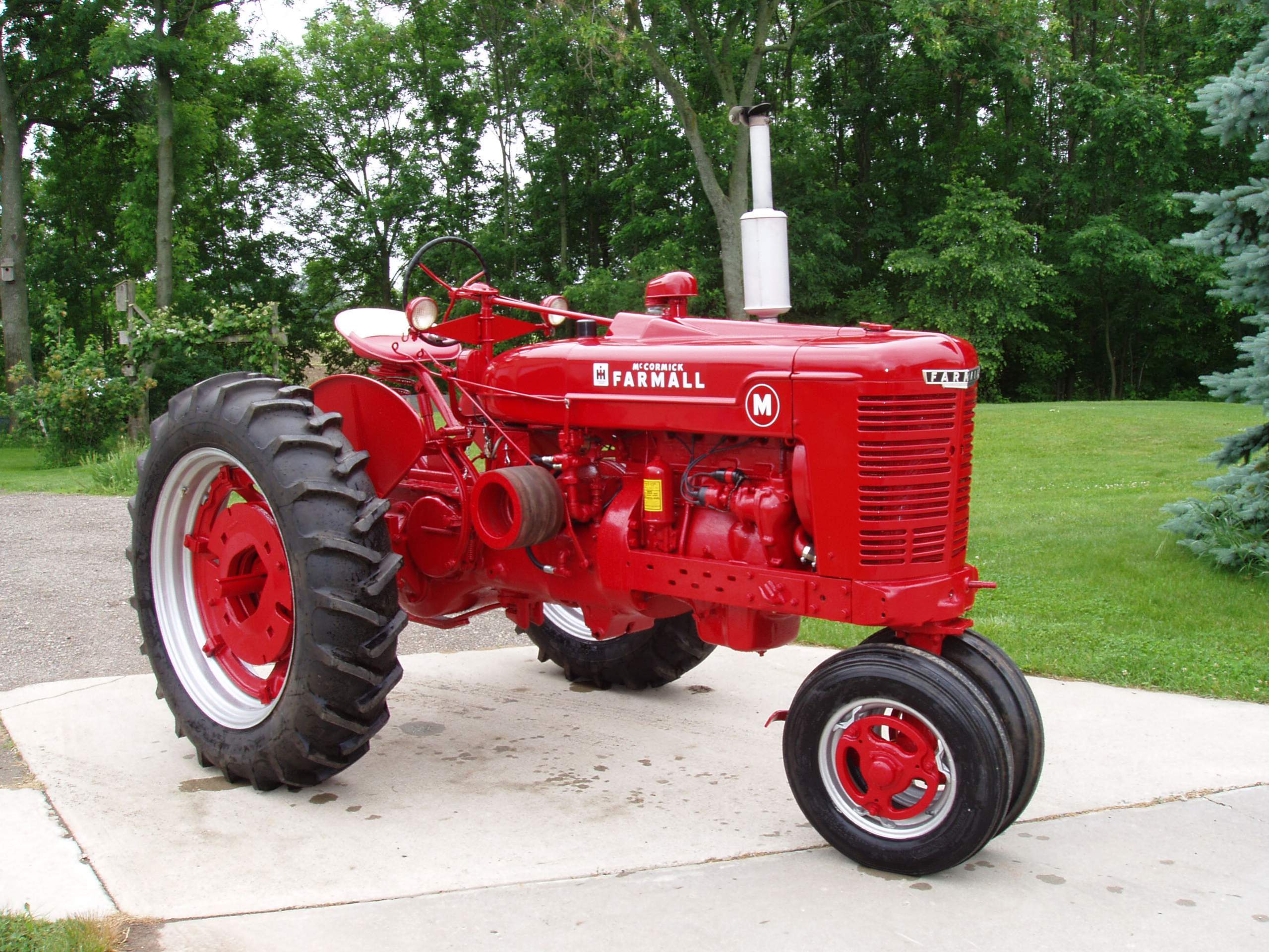

I kept mine on 6 volt. Use big cables rated for the amps. I think mine are 2/0.
Starts good

Beautiful tractor! I bet the seat still moves side to side. I spent most of my non winter life on a Super M.
Seat is tight, steering is tight, pedals are tight. This seem to be a low hour tractor. Even the engine pulleys show minimal wear.:D
Still has flat tops in it!!!!!!:thumbsup:
