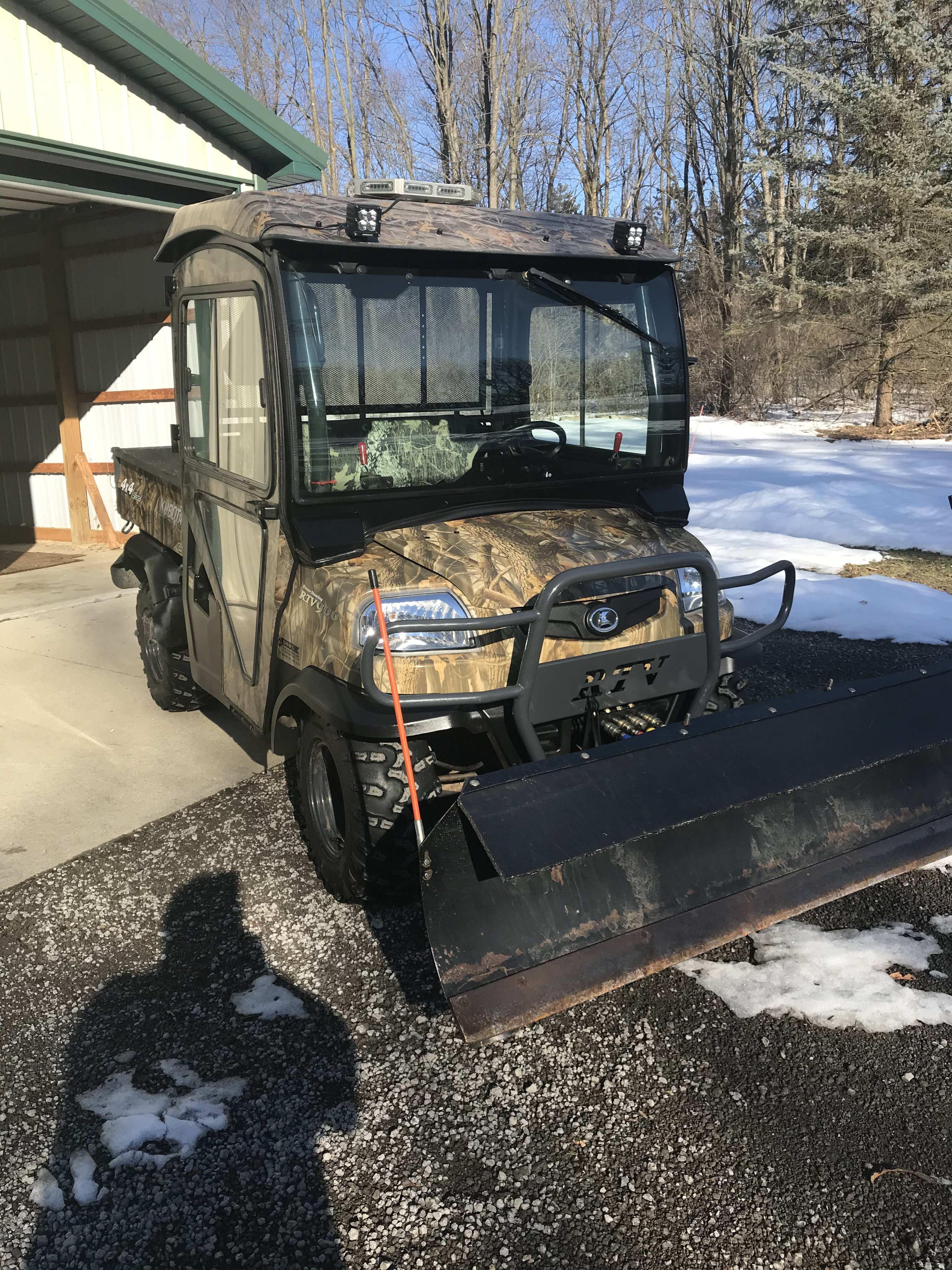

I have owned 2 kubota RTV,s 2006 RTV900 and a 2021 RTV1100c both have been working machines if you are not into speed. As far as hills go we live in a hilly area your speed on hills will go from 25 mph down to 15 mph.I love the diesel engine/hst tranny its a real work horse.
