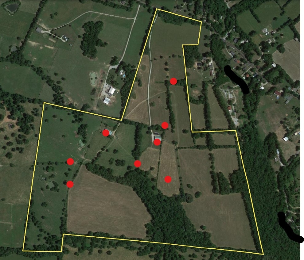

THIS is my main reason for knowing. Even if they end up working… I want to know where they are located if at all possible in order to avoid it. I put everything in, on my old farm, and knowing where it all ran was calming.

So, I might have missed it; but, has anyone mentioned:
Back feed water from the waterer, and look for wet spots/settling/sand in the grass? Without knowing exactly how the automatic water connects/is plumbed, it's hard to say what it would take; could be as simple as a female-female fitting, and a water hose; or it could involve cutting into the supply right below the waterer, and back feeding?
I would really Want to try to separate the waterers from the existing potable water supply for this test.
If this is simply a matter of lost valves, but intake piping; this test won't help; but I would assume at least some of the piping is already damaged.

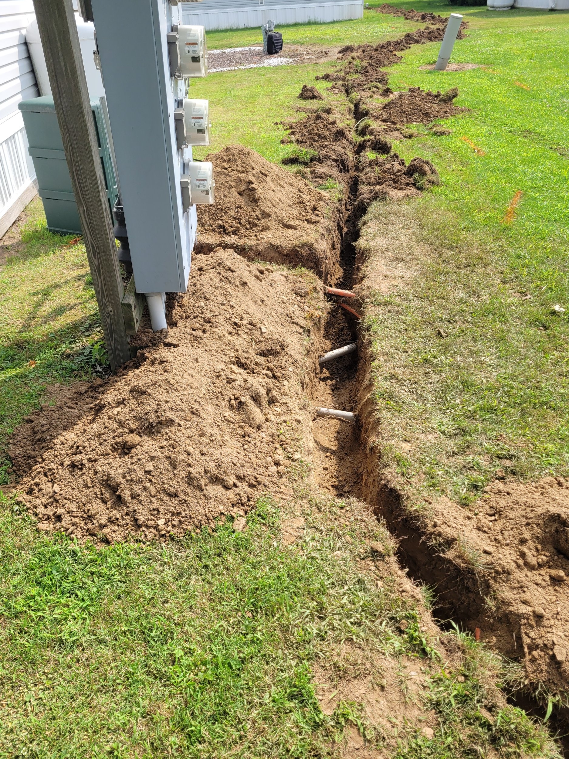

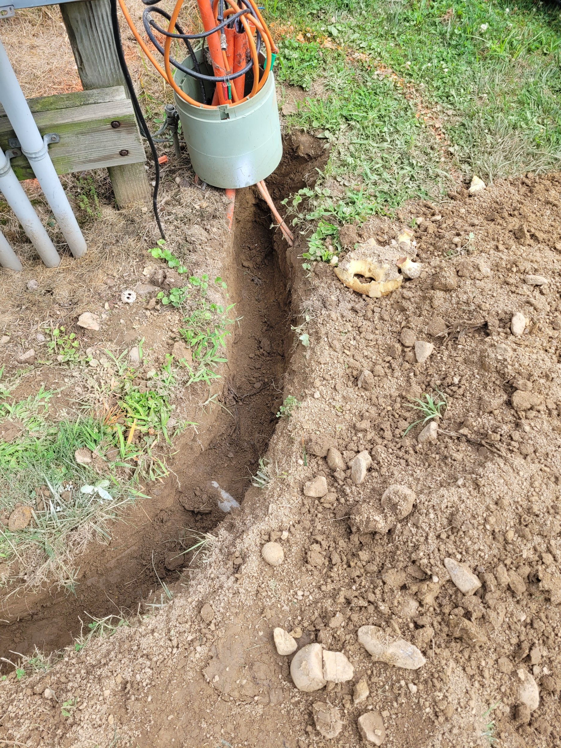

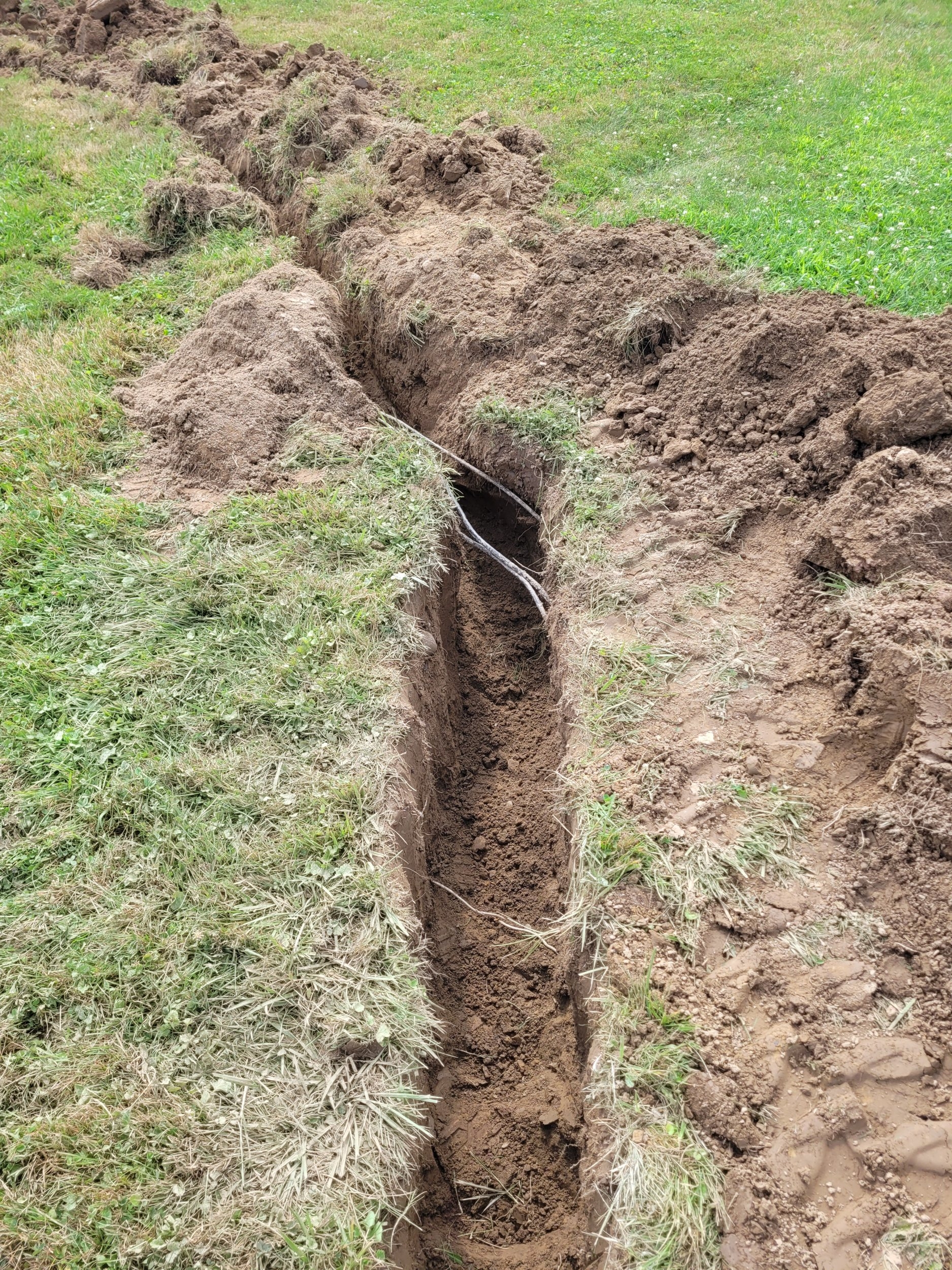

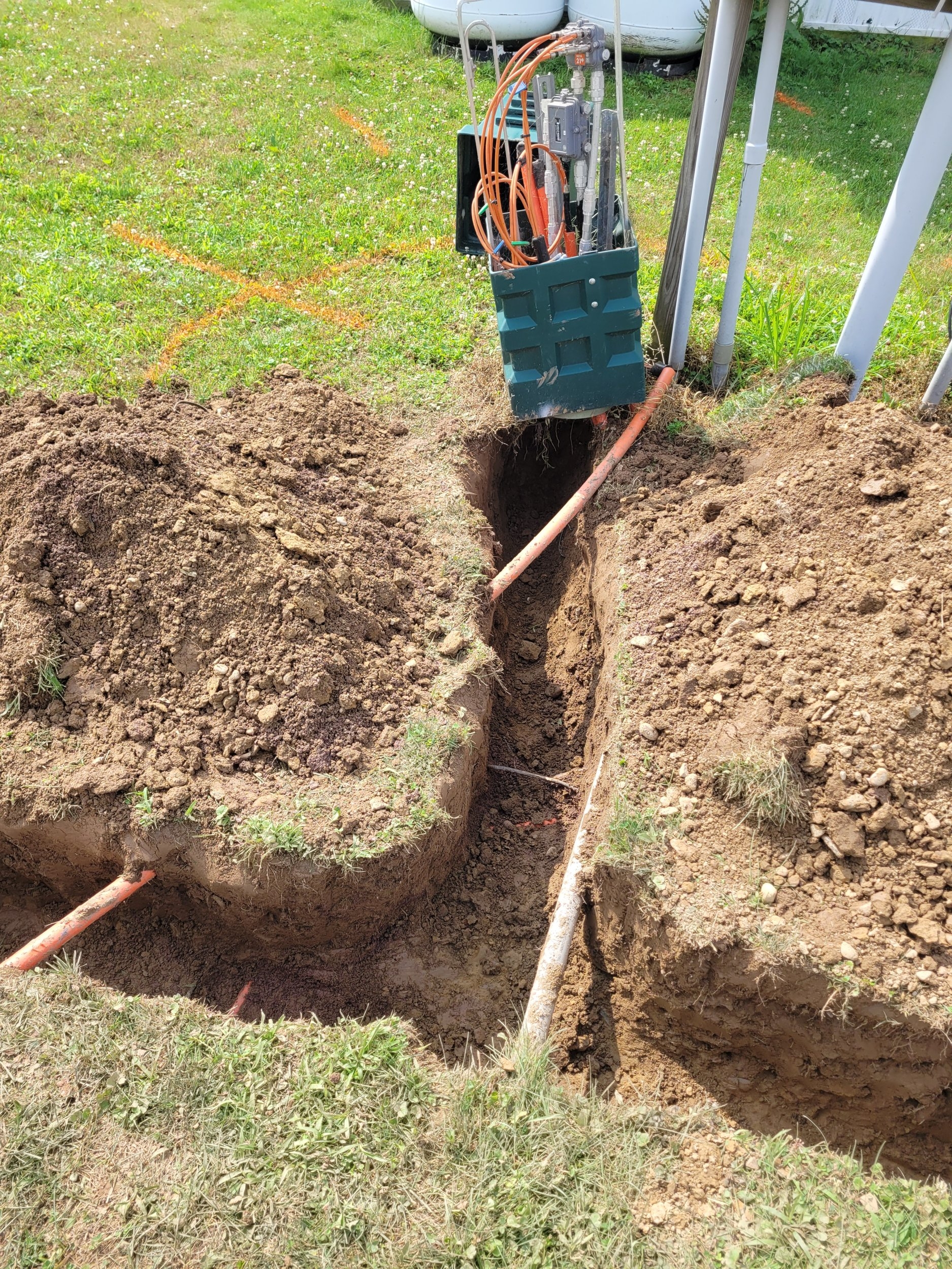

I know everyone's paw has done it to perfection but as someone who locates daily I've see them fail often. Here as this mornings "stuff" and my crew does this all day most days. There is a reason why every time the sticks are put to a real test they have failed. View attachment 878733View attachment 878734View attachment 878735View attachment 878736View attachment 878737
Works great for finding unmarked leach field lines too!
And phone lines! I found two just last week, in the same hole six inches one above the other. 😆. Thankfully they were abandoned.
