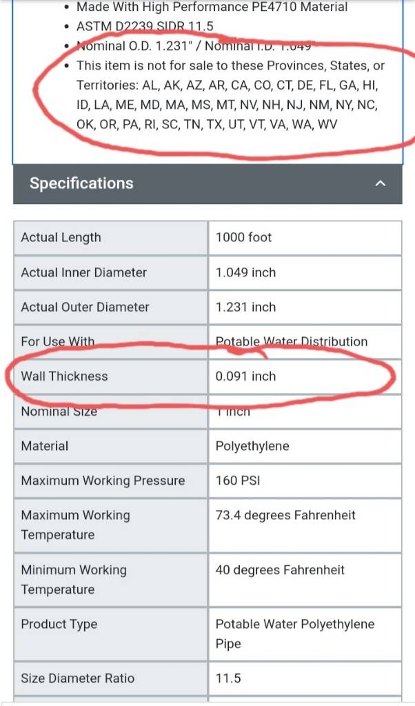

Thanks so much for your replies. As for why I think I have a leak are these clues: (1) we had a leak in the line before. We knew because our water usage went WAY up one month ($1,000), and there was a place visible in the pasture which was green and wet while elsewhere the pasture was still brown, (2) just this month we accidentally were given the water bill for our neighbor as well as our own. The neighbor's bill was something like $30 while ours is $200. They have 3 people in their household while we only have 2. We don't water our lawn or a garden, and only have 2 dogs and 4 chickens to water besides us humans. (3) After seeing the neighbor's water bill, I cut of all water at the house (which I installed when I had water issues before), then went to the gate to see if the water meter was turning. It was. (I took a phone video of the meter but it was too large to upload - 24 MB.) It is not turning fast but steady enough to cause our water usage to much more than needed.
Regarding locating the pipe, one thing that might help is that the old phone lines were buried next to the water line. The phone lines are being used (edit: are NOT being used), so I or someone else might could use them to send a signal that could be detected.
If I am able to locate the leak, then I will most likely try to repair it.

On locating; I'm assuming we have a general idea of running line; left side of driveway, somewhere between 2-8 ft from edge of drive. Not that hard to ditch a slit trench from edge of drive outwards 6 or 8 ft long, 30-36" deep. If all we know is starting point and ending point, that's a bit different, but still, we can pretty much assume a running line based on path of least resistance. We know it's stick pipe, so it's not like it's an HDD, where we could be 30" to 10 ft deep.
To the OP; based on pipe type; I'm assuming this is 2"?
There are private locate companies; but on private property, I'm assuming they didn't lay locate wire. They could GPR it, but thats expensive, and is far from the magic that some people think. Dug a lot of empty holes looking for something GPR picked up, and even when I worked for a company that did private locates, at $2500/10 hr day; we Often resorted to post hole diggers, even if we had a vac truck and air lance on site. By the time you got the truck, hoses, ect into position, you could have already pot holed it, if it was Remotely shallow (less than 4 ft).

I'm far from expert, but at my homeplace 97yo mom still there from meter at highway the line goes about 2000ft. crossing a creek about halfway. After about 20 years leaks started. The plumber found it was because it was touching rocks along the way, vibration cut through pipe.
That Menards pipe two reasons I don't like: it's not for sale in OPs state and it's very thin.
