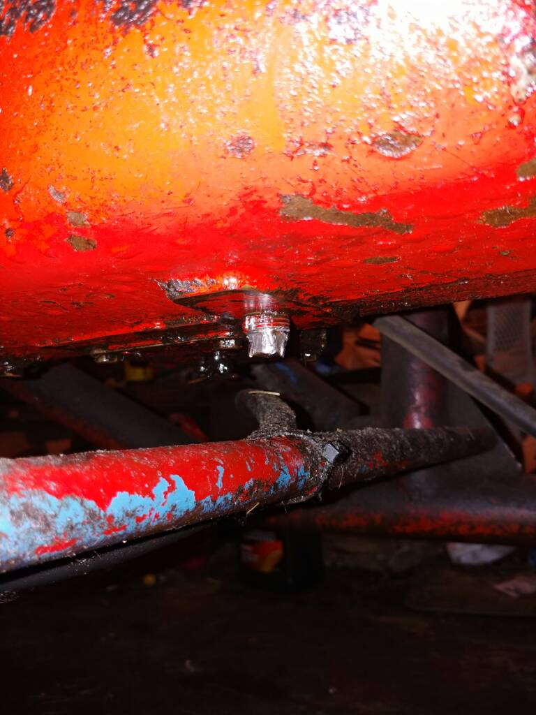

You Kando anything with a pipe wrench! Sometimes a long pipe on handle! tapatalk_1559050859006.jpg
