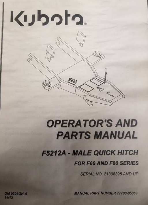

Does anyone have any pics of how the snow plow mounts on the F series? I have an F3080 and I'm currently using a homemade snow pusher mounted to the lift arms, but I have a used snow plow that I'd like to use instead, and I think it really should be mounted back to the frame or axle, and just use the arms for lift. I'd consider just buying the mount plates from Kubota, but I can't seem to find any diagrams for any accessories except for the mowers. Any help would be appreciated.

/ F Series Snow Plow #5
I can scan a few pages of my Quick hitch Manual, just to get a idea on how it mounts to my 2690. Whatever you rig up yourself will probably have to be mounted alike, even though the end attaching to the blade would obviously be different. (I was looking that a Manual online but cant find one)

/ F Series Snow Plow #9
I scanned what i think you need from it.
It doesn't look like the quick hitch has any brackets that actually attach to the frame of the tractor. Looking at the pic of the manual that Pete6114 posted earlier, it appears the arms with the half circles cut out just rotate on the shaft where the existing lift arms attach, and then are attached to the lift arms futher out with two bolts. It doesn't appear that this system is designed to provide any additional strength that the lift arms couldn't provide, but rather just to make it possible to use the same quick hitch implements that are used on several other models. From some pics I've found, it looks like the two square blocks that bolt to the existing lift arms are used as stops to limit the lift height. I've been using my homemade snow pusher for 3 seasons so far just pinned to the existing lift arms, with no ill effects to the tractor. I will say that these little tractors can push some serious snow for their size/weight! The pusher box works really well, but there's times a plow would work better to be able to cast the snow off to the sides. I'm thinking my best bet is to simply mount my plow to the existing lift arms in the same manner as my existing pusher, and not try to overcomplicate things by trying to use the quick hitch, which is obviously designed for quick hitch compatible inplements.
/ F Series Snow Plow #11
the arms with the half circles cut sit right under where the liftarms on the stationary axle, giving much more support and can handle impacts much better than just fastening to the liftarms. If you ever bend the lftarms which are welded to the axle, you'll have a big problem. If you rig up some hunk of steel that sits on the axle AND fastens to whatever you have been using so far, you'll have a lot more solid mount. Just because you havent damaged the lift arms yet is no guarantee that you wont down the road.

#12
Thanks for the pic. I went out to look my tractor over and I can see now how the quick hitch attaches. Looks like I can just weld some tabs on my plow arms to sit on that axle where the quick hitch would go, and just use the arms for lift. I agree it makes sense to take the strain off the arms, but my main concern is all the implement shock load is still transferred to those same pivoting axles (where the grease zerk is in your pic). I guess it's probably more stout than it looks, with the gussets going back to the main frame/axle, it's all tied together. Now I just need to find the time to build it. Thanks again for the help.
