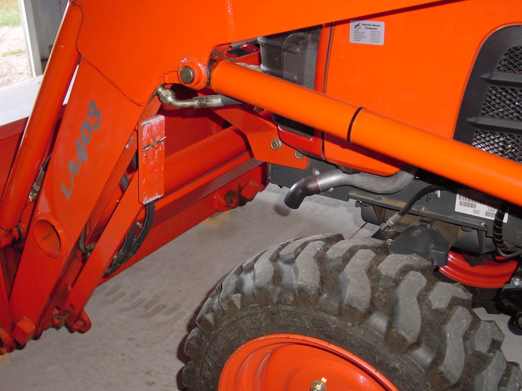

I fit a 1-1/4 inch 45 degree copper elbow onto the end of the pipe and pointed it downward, away from the loader arm and bucket. The soot problem is gone but the exhaust does kick up more dust and dirt if the conditions are dry.

Here was my solution for the soot.
Thank you! The 1-1/4 inch 45 degree copper elbow went on nice and tight and I will have less time cleaning the exhaust soot on my loader and snowblower on my B2650!
/ Exhaust soot on loader #34
I put a piece of exhaust pipe with a bend in it to redirect the exhaust on my BX2360. No more soot on the loader but it sure makes the dust fly when driving in dry dirt. I don't know which one is worse. I think I will deal with the soot, it doesn't take long to clean off. I use spray 9 to clean it off.
