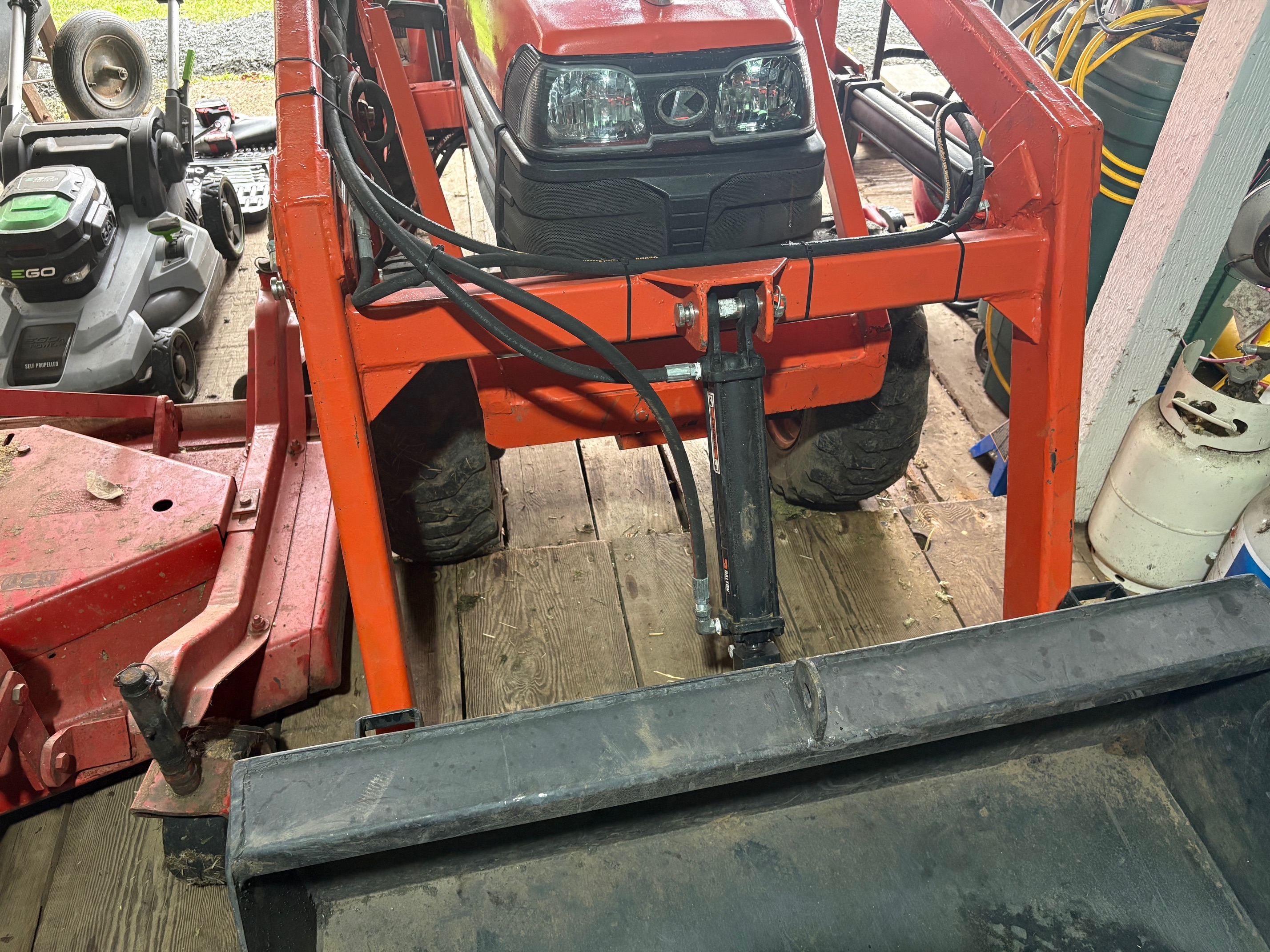

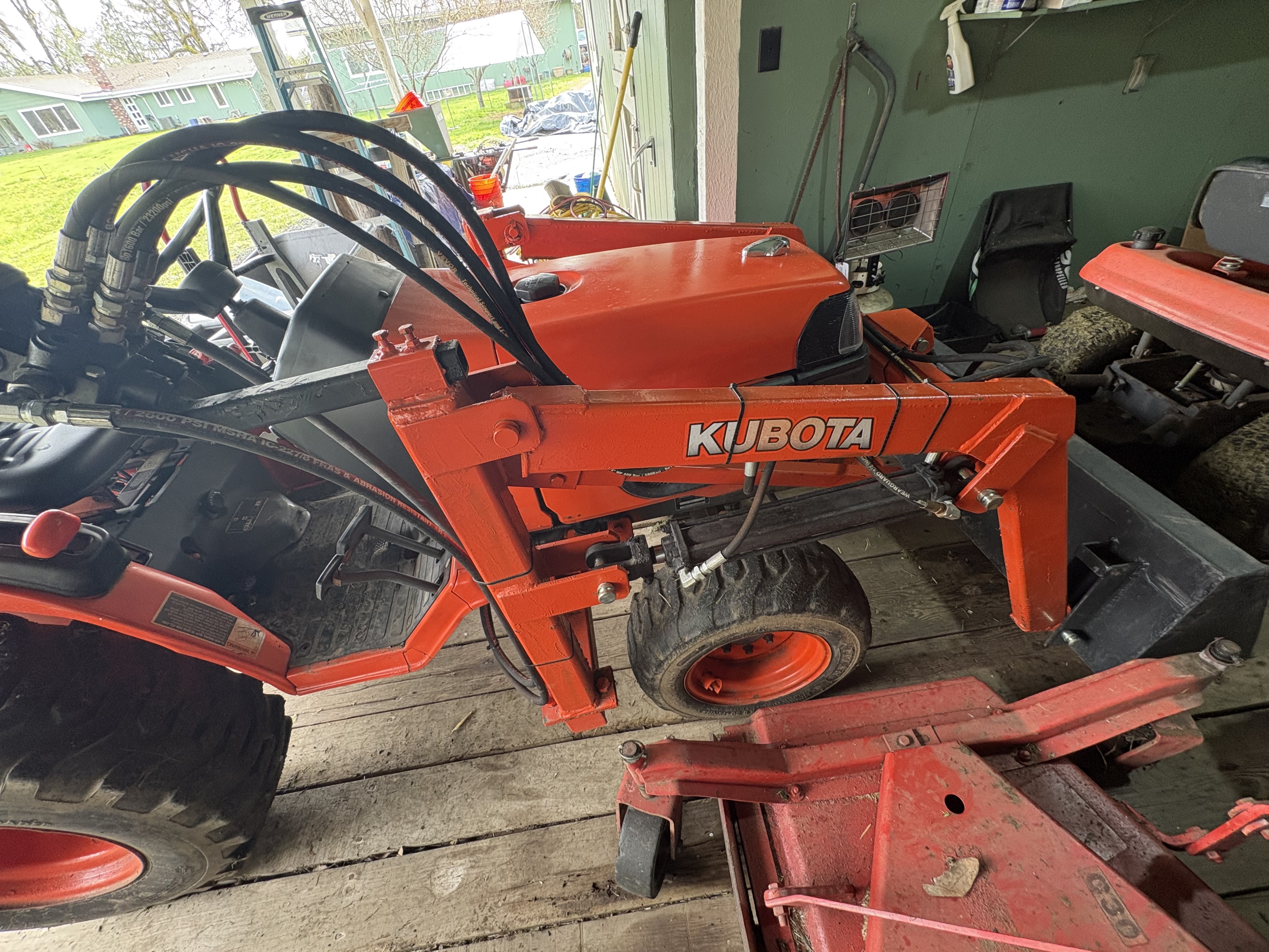

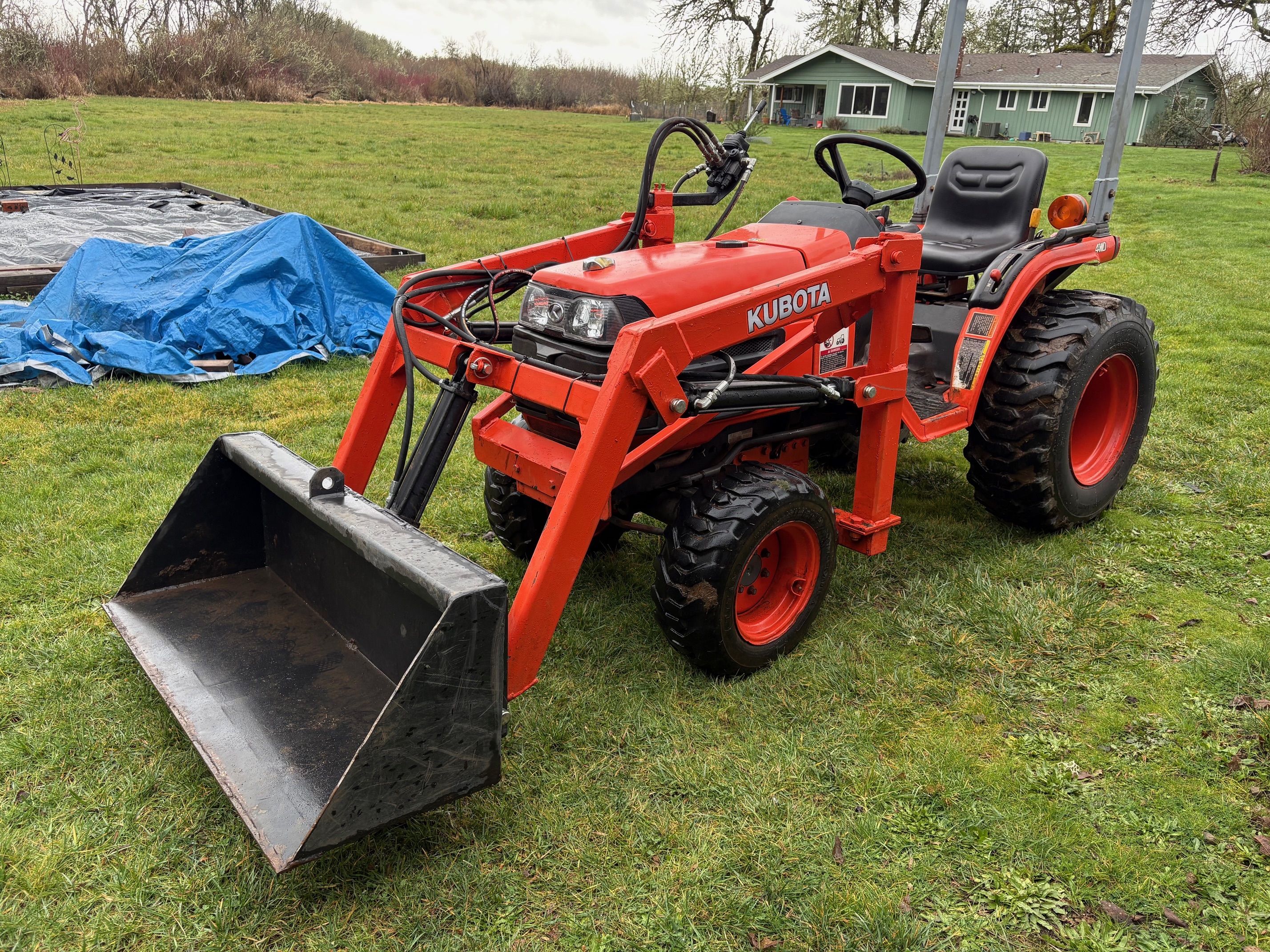

Hi, I just bought a 2007? B7510 with FEL. The loader does not match the pictures of the LA302 or LA272. It has a single center bucket cylinder. It looks like it has been repainted and has Kubota logos on each boom. No other labels anywhere.
I am not sure if it is aftermarket. Has anyone seen one like this?

Have not seen one but will offer a few comments: To be honest it looks home-made and a pretty good job at that. Might be aftermarket but they are fairly rare. Notice that every piece of steel is flat, straight or readily made from stock. No formed or pre-curved or "factory looking" components. My thought is that it would be made to quick-disconnect if it were aftermarket (or any Kubota model) as it would be a hard-sell if it were not. What you have is certainly not a quick-dismount loader. Those cylinders are all "external long bolts" construction which I have never seen on a loader (though there may be some.) The adjustable position loader valve support structure is unique. Two set screw bolts... I'd bet money it is not compatible with a belly mower. I think it is home-made (at least not a commercial product.) I've seen several Amish welding shops that could duplicate it and many metal fabrication shops could.
What is the origin? Where did it come from?

I am in Oregon. Just bought it locally. It works great, however there is no “float” mode, which was a little disappointing.

I agree it is definitely not factory. Looking at the design, the consistency of the welds and the bolt together assemblies, it appears to me to be a manufactured aftermarket kit. I also noticed that the boom and bucket might be removable by just pulling pins and then sliding control out of bracket.

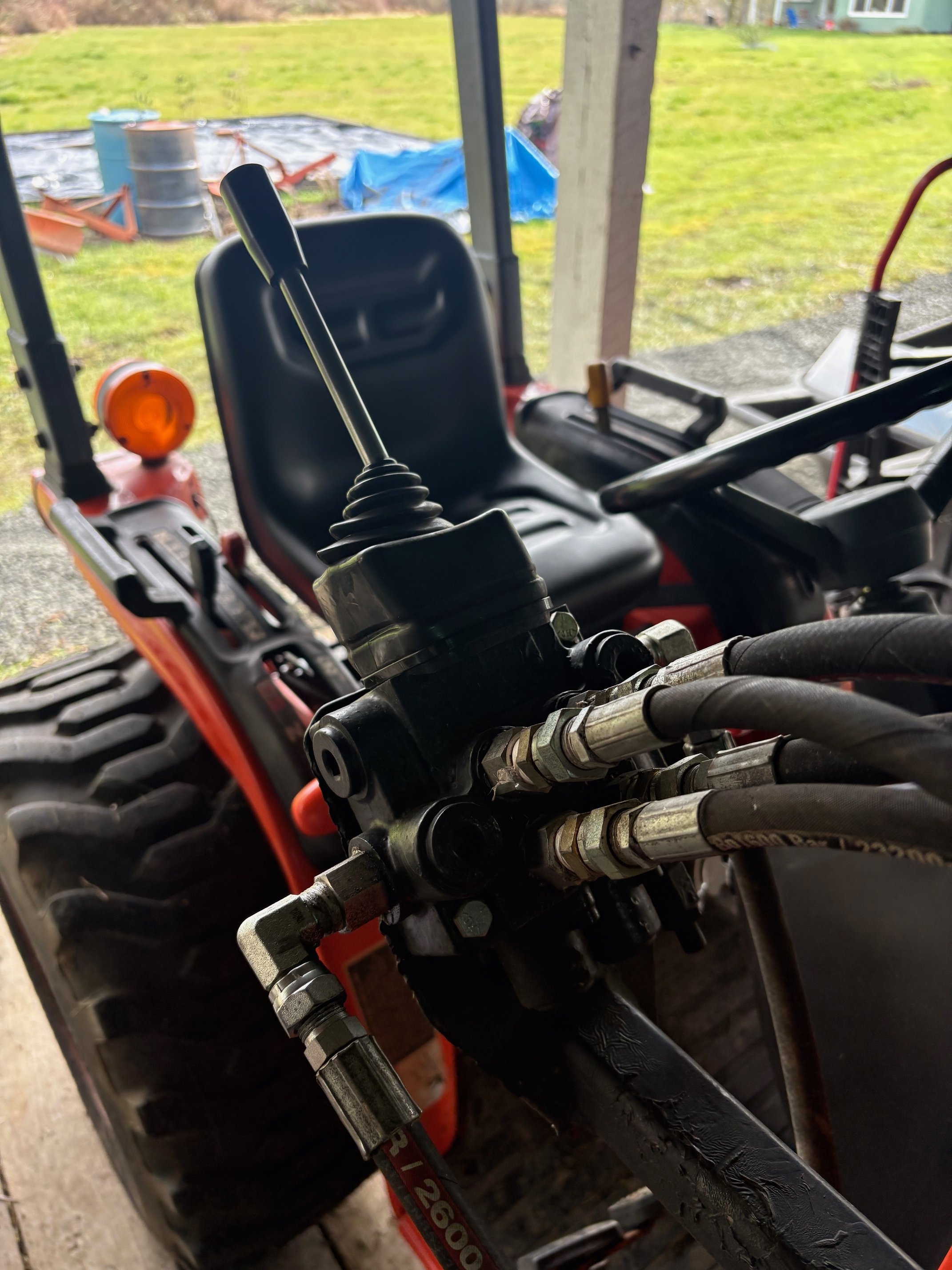

I identified the 3 cylinders to be standard Dalton tie-rod type cylinders. They are secured with removable pins. I have not been able to identify the control yet as any labels are painted over. The hydraulic lines are all flexible hoses and are tie wrapped in place.
The paint job was amateur, as you can see lots of dried drips, so if it was a kit it was likely a different color.

I identified the control. It is a common one found on Amazon. I ordered the upgraded drop-in version with float for $150. I will keep the old one as spare.
I am mechanically handy but no hydraulic experience. What do I need to be aware of when changing a hydraulic control valve?

The common concerns are dealing with leaking hydraulic fluid all over the place and the possibility of some line being under pressure. Be sure to mark the hoses and ports on the original valve with colorful tape to avoid wrong connections on the new valve. I would first put the machine a place where you can let it sit for a while depending on what goes wrong. Lower the loader to take as much stress off it as you can. Then rock the joystick slowly in all possible directions (which will take pressure off the lines.) Looking at the photos you do not have quick disconnects in the lines. Just take them loose from the loader valve body one at a time, watching to see if you get leaking/running/dripping. Plan ahead by preparing a place (or even some clamps) where the loose ended lines can be kept up at the height of the loader valve -- won't run fluid out so bad as they would if let dangle. Of course you will get a small amount of fluid no matter what you do so a few rags are in order. Hang on to any instructions or diagrams that come with the new valve. Esp see if the papers offer instructions for making adjustments during installation. Typically the only adjustments are "in and out" distances for each of the two control cables and a lock nut on each one when it is correct. However your original valve looks to be the type with the joystick mounted directly on the valve body so there would be no control cables to adjust for penetration. With a little luck your new valve will be adjusted at the factory. Just reconnect all the hoses making sure you get them in the same ports on the valve as the old one. Fire it up and let it run a minute or two to get full hyd pressure. Then try it -- all operations , up down loader frame & curl/dump of the bucket. If those movements all work correctly, you probably do not have to do anything else. Study those papers that come with the valve looking for any less-than-obvious instructions or adjustments. Do not worry about air in the lines, etc. which may cause momentary issues until the cylinders have all been activated full in and full out. They are self-purging of trapped air. Normally not a problem. There are all sorts of fairly rare issues (such as external shims on each of the 2 spools in the valve, etc.) You are unlikely to have those issues. If you do, there are probably adjustments inside the base of the joystick under the rubber boot. Unlikely needed. If the paper directions provided fail to give adequate help, the prominent loader valve manufacturers all have customer service phone numbers you can find on the web or the papers. I've had one mfr (Nimco in Wis.) turn my phone call directly over to an engineer with immediate first-hand familiarity with my valve model. Even though the valves were made in Sweden.

Others are right and that's a homemade loader probably done by a quality shop or Amish. Looks very nice.

That is a home made loader. Someone built it. It's not factory

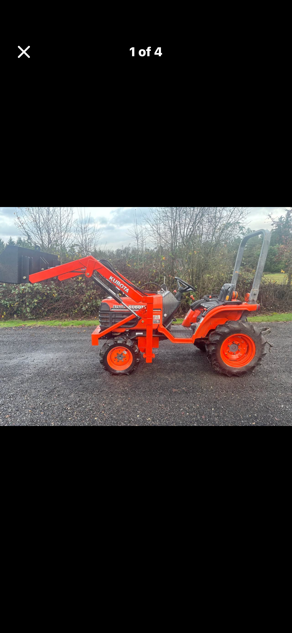

I just saw an ad for a B7500 that had a loader similar to like mine. I asked the owner about it.
They are made by Cold Water Tractor in Hoquiam Wa. Unfortunately they may be out of business. Not worried since it is stock hydraulic parts.
I found other posts here about them.
